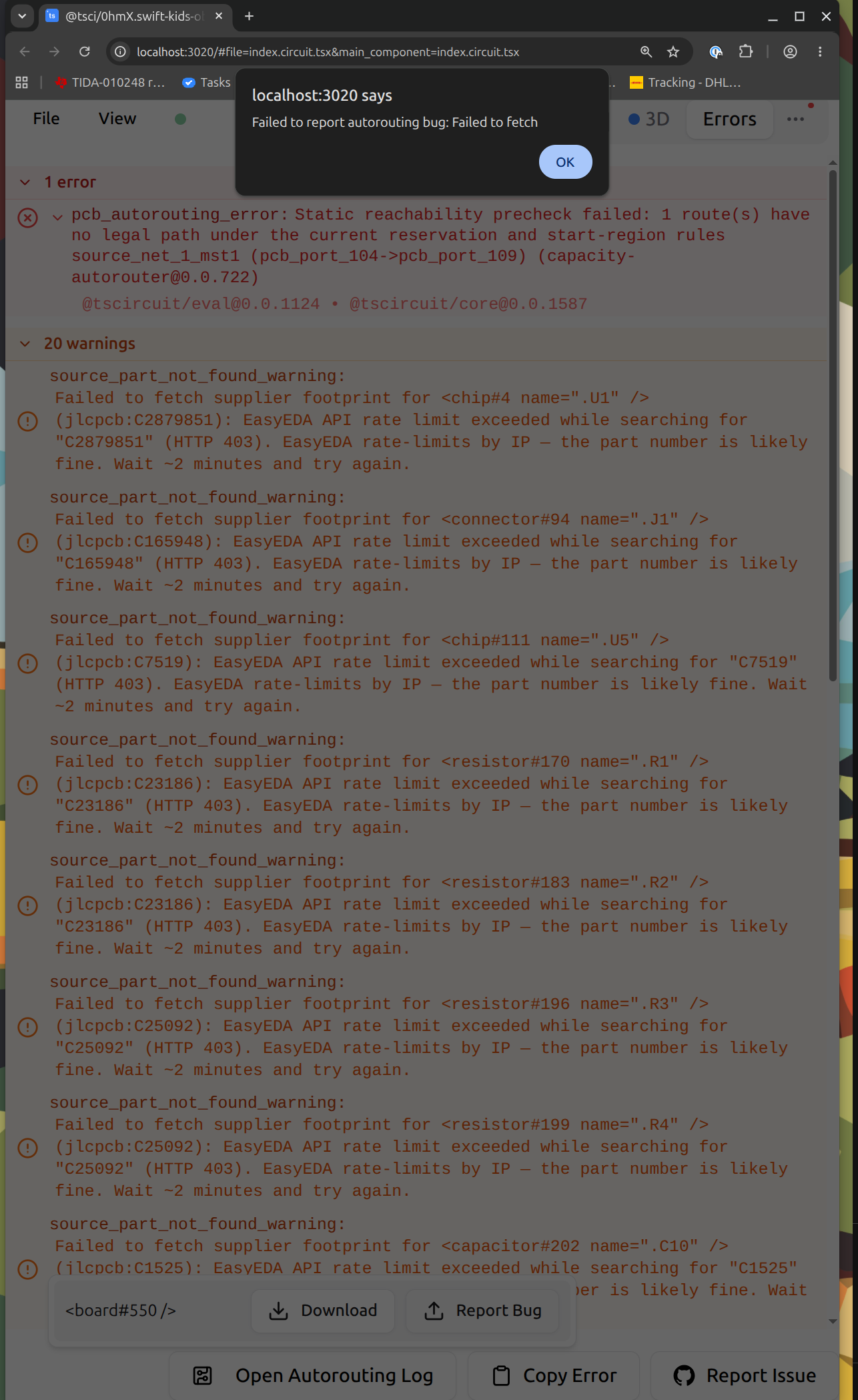

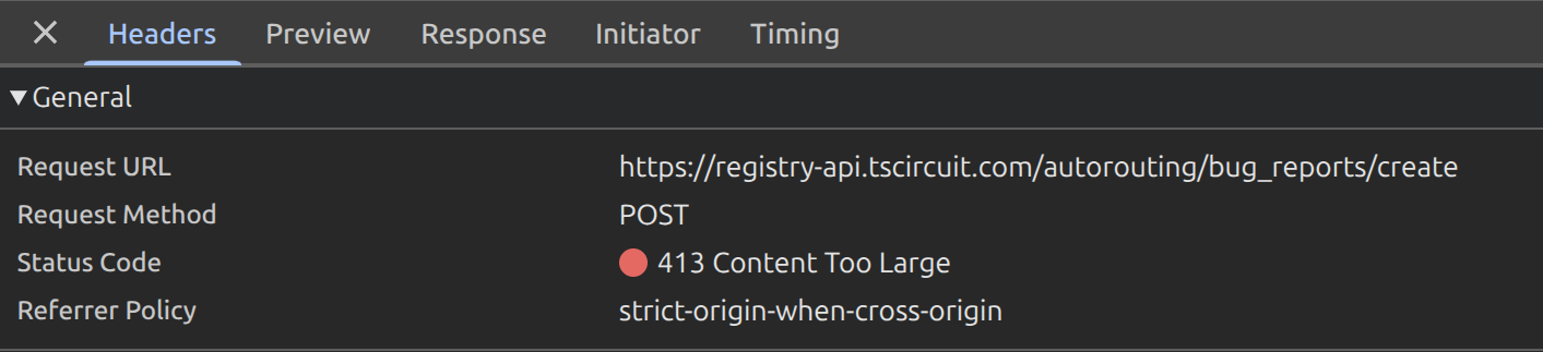

<@757706909351411845> can not report auto router bug report
seems like a response size issue
we should improve the runframe error for this
will do
https://github.com/tscircuit/runframe/pull/4316
