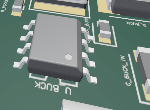

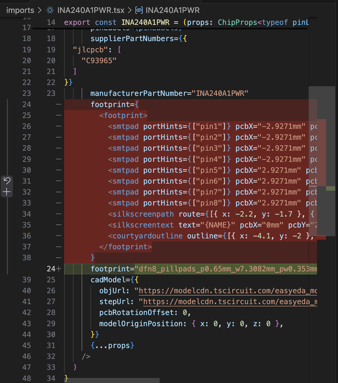

Mustafa7 - @Seve I just reimported the componen...
mention I just reimported the component and it suddenly changed the manual footprint to a string and this fixed the wrong 3dmodel rotation issue. Attached are befoer and after, not sure what happened. Tried to reproduce in easyeda but there is no issue with rotation

idk honestly this looks broken
i would dig in
<@757706909351411845> this is an issue in props and core where `rotated_pill` is not handled, here are the prs to fix it: https://github.com/tscircuit/props/pull/778 https://github.com/tscircuit/core/pull/2997
