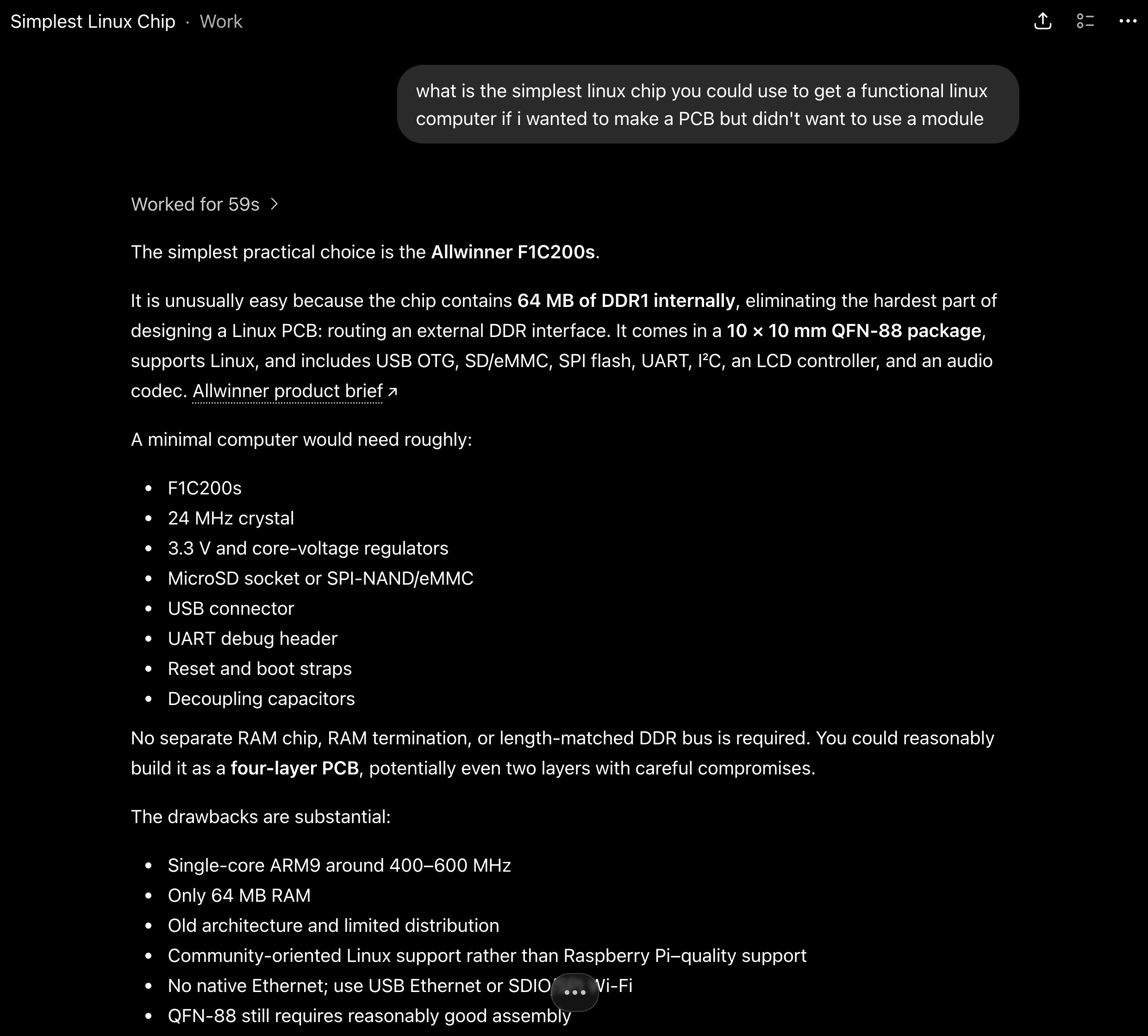

Seve - @0hmx easiest linux chip?
mention easiest linux chip?
Started by SeveAug 3, 20265 messages
<@400684445054795796> easiest linux chip?
https://jlcpcb.com/partdetail/F1C100S/C1511928
<@400684445054795796> you gonna be creating a board with this?
yea he started it
you're welcome to try as well
