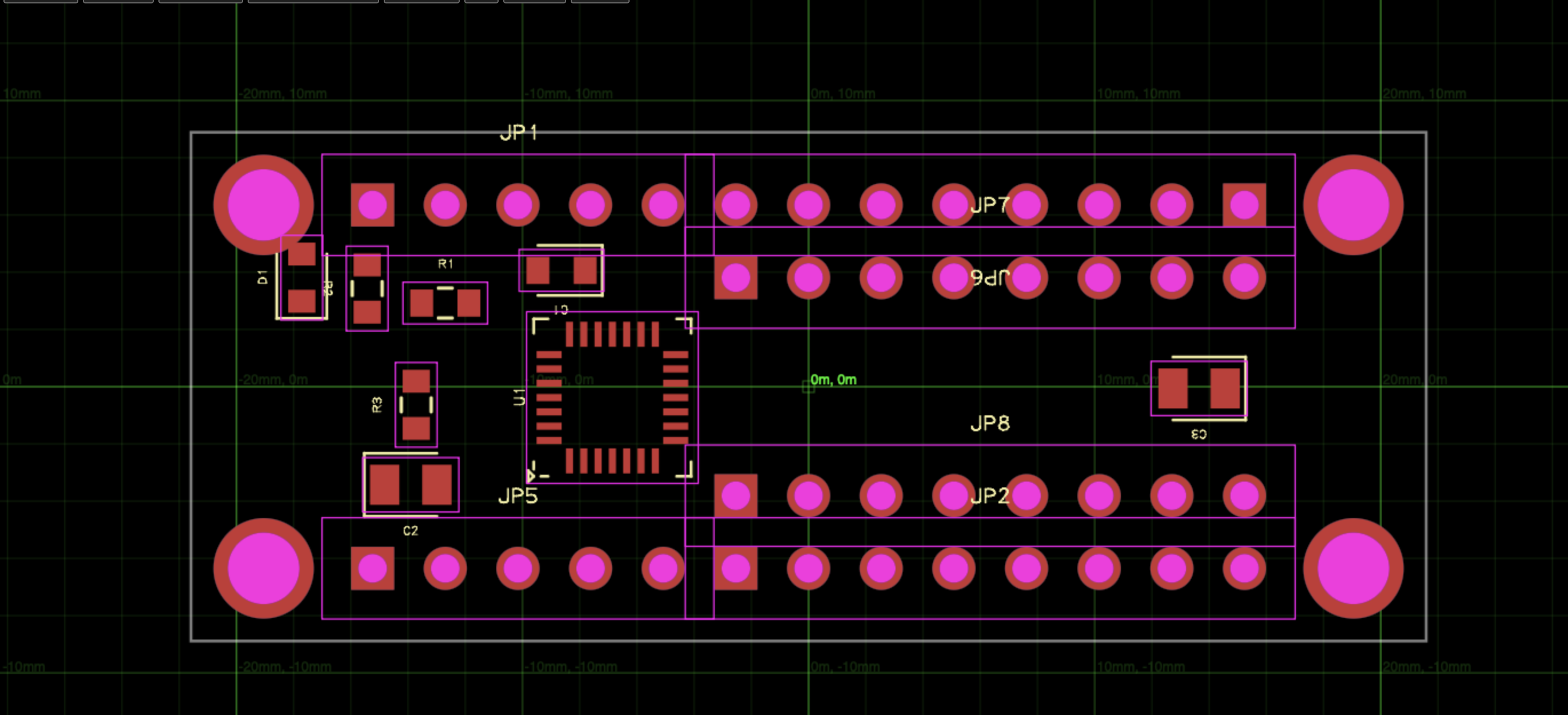

this doesn't seem based in a real use case
<@1090901054385836045> show some screenshots of your board etc. so we know you're building towards a real board
Arhan
I was building an Adafruit MCP23017 breakout. The reference layout has a tight cluster near the left edge (LED, resistor, solder jumper, and mounting hole), which triggers placement DRC and blocks autorouting. The autorouter tells me to set `placementDrcChecksDisabled={true}` to bypass the check, but setting it on `<board>` doesn't change the behavior.
that isn't the right solution, no board should be failing drc
Arhan
Got it. I'll investigate why this reference board is failing placement DRC instead of focusing on bypassing it.
