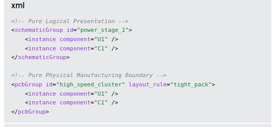

Probably there should be separate `<schematicGroup>` (renamed from schematic section) and `<pcbGroup>` (current group), each having their own hierachy logic. And probably an explicit `<namespace` that defines how refdefs behave across namespace boundaries

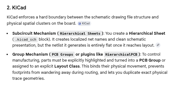

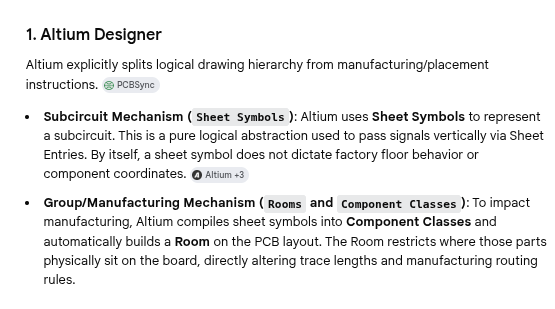

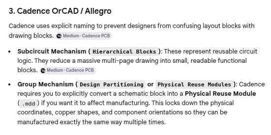

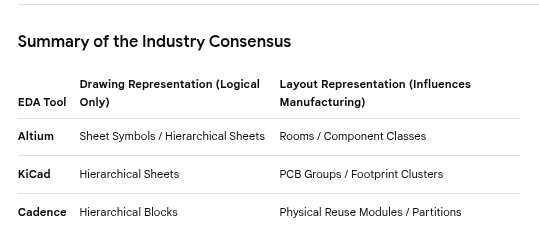

Subcircuits are supposed to have high isolation, groups have low isolation, schematicgroup and pcbgroup yes these make sense but it general i feel like group may have been a bit of a misstep
Isolation, Spatial and semantic grouping are all different
schematicgroup is _closer_ to a semantic grouping, but isnt necessarily a semantic group if done for schematic layout purposes
pcbgroup is imo mostly spatial

We already have this schematicsheet/schematic section instantiation, maybe something like that could separate the representation concern out: some schematic group that could be referenced in schematic without physically changing PCB or moving JSX children out of where they are
Yea the non-nested instantiation is a good compromise

Yea ill add some stuff to the spec today but imo just avoid group haha,
schematicgroup and pcbgroup with optional nesting is probably good
