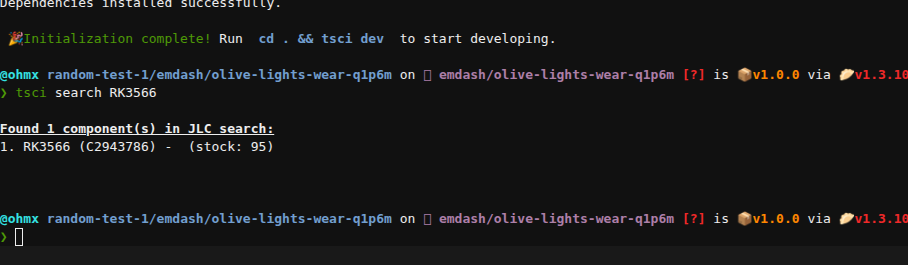

code sample what dose this error mean?
Started by 0hmxJul 29, 202611 messages
``` @ohmx random-test-1/emdash/olive-lights-wear-q1p6m on  emdash/olive-lights-wear-q1p6m [?] is 📦 v1.0.0 via 🥟 v1.3.10 took 1s ❯ tsci import RK3566 ✖ Failed to import part [ { "code": "invalid_type", "expected": "string", "received": "undefined", "path": [ "dataStr", "head", "editorVersion" ], "message": "Required" }, { "code": "invalid_type", "expected": "boolean", "received": "undefined", "path": [ "dataStr", "head", "hasIdFlag" ], "message": "Required" }, { "code": "invalid_type", "expected": "object", "received": "undefined", "path": [ "dataStr", "BBox" ], "message": "Required" }, { "code": "invalid_union", "unionErrors": [ { "issues": [ { "code": "invalid_type", "expected": "array", "received": "undefined", "path": [ "dataStr", "colors" ], "message": "Required" } ], "name": "ZodError" }, { "issues": [ { "code": "invalid_type", "expected": "object", "received": "undefined", "path": [ "dataStr", "colors" ], "message": "Required" } ], "name": "ZodError" } ], "path": [ "dataStr", "colors" ], "message": "Invalid input" } ] @ohmx random-test-1/emdash/olive-lights-wear-q1p6m on  emdash/olive-lights-wear-q1p6m [?] is 📦 v1.0.0 via 🥟 v1.3.10 took 3s ❯ ``` what dose this error mean?
use tsci import C2843676 maybe?
or whatever the jlc part number is
idk that's a weird error
someone should fix
CC <@1067854999889137715> possible bug in jlcpcb import
``` @ohmx random-test-1/emdash/olive-lights-wear-q1p6m on  emdash/olive-lights-wear-q1p6m [?] is 📦 v1.0.0 via 🥟 v1.3.10 took 2s ❯ tsci import C2943786 ✖ Failed to import part [ { "code": "invalid_type", "expected": "string", "received": "undefined", "path": [ "dataStr", "head", "editorVersion" ], "message": "Required" }, { "code": "invalid_type", "expected": "boolean", "received": "undefined", "path": [ "dataStr", "head", "hasIdFlag" ], "message": "Required" }, { "code": "invalid_type", "expected": "object", "received": "undefined", "path": [ "dataStr", "BBox" ], "message": "Required" }, { "code": "invalid_union", "unionErrors": [ { "issues": [ { "code": "invalid_type", "expected": "array", "received": "undefined", "path": [ "dataStr", "colors" ], "message": "Required" } ], "name": "ZodError" }, { "issues": [ { "code": "invalid_type", "expected": "object", "received": "undefined", "path": [ "dataStr", "colors" ], "message": "Required" } ], "name": "ZodError" } ], "path": [ "dataStr", "colors" ], "message": "Invalid input" } ] ``` same error with `tsci import C2943786`
<@809856037376491570>
Search works correctly and resolves RK3566 to C2943786. The import fails afterward because EasyEDA returns footprint-only data with an empty schematic, omitting editorVersion, hasIdFlag, BBox, and colors. Our Zod schema is too strict and incorrectly required these fields, causing validation to fail before conversion.
