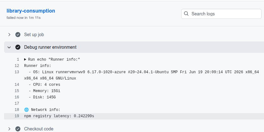

could you retrigger one last time and I'll try that Readme change. Should show us whether it's network access or some problem with bun/npmrc

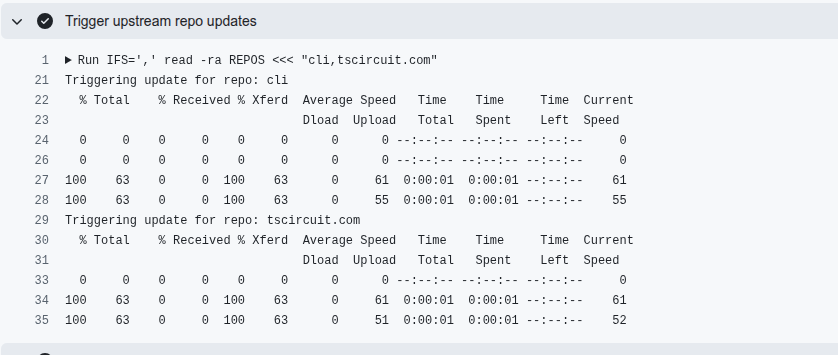

ok so the pipeline is now running
https://release-tracker.tscircuit.com/
it triggers to tscircuit.com, circuitjson.com and tscircuit/cli https://docs.tscircuit.com/contributing/package-dependencies-and-auto-updates
astrimid

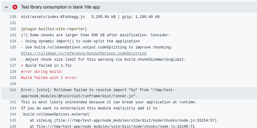

Ok. Now it works and automatically triggers. The next thing is `ky` and others, but let's see if the `debug` change fails anything

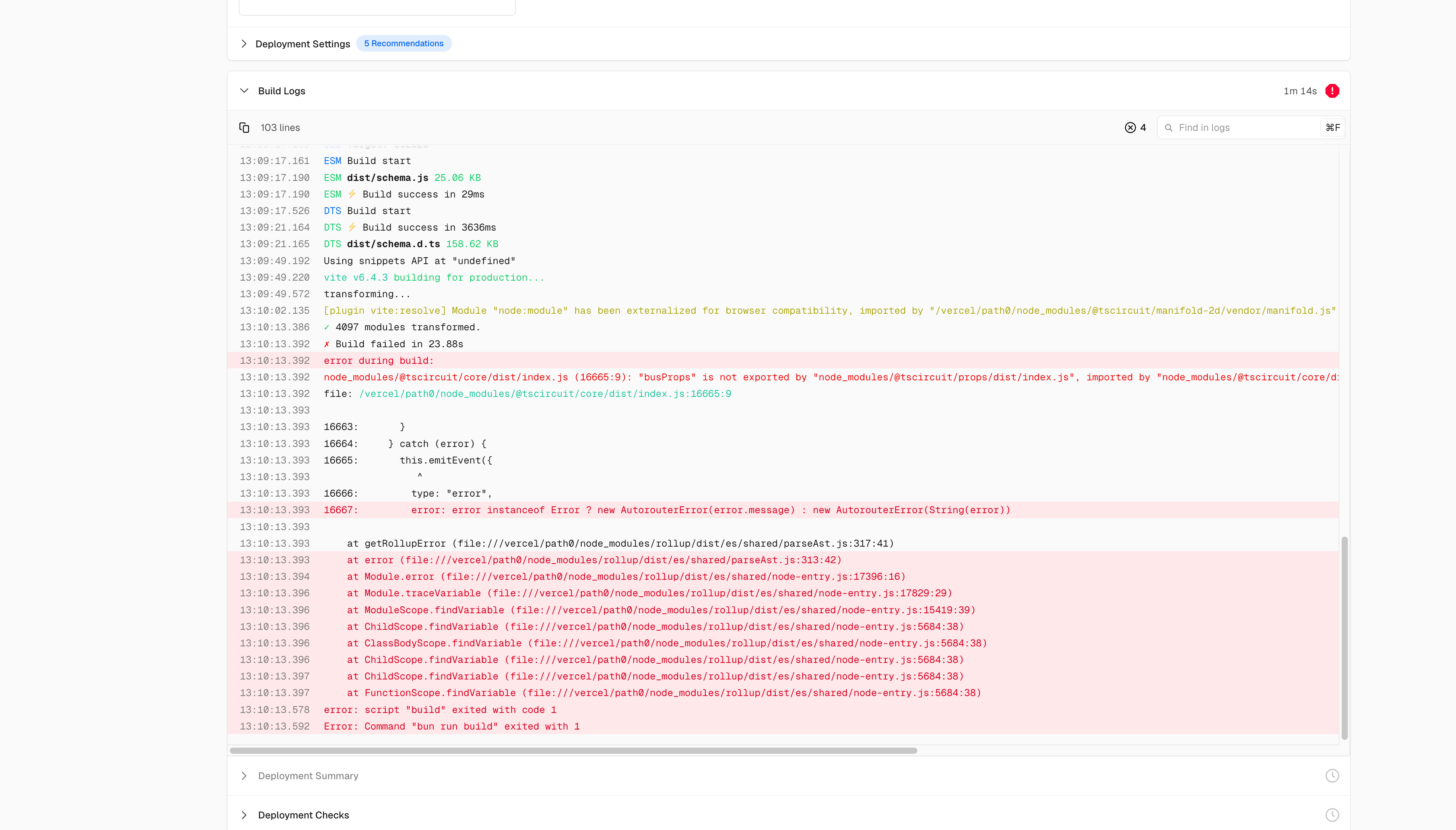

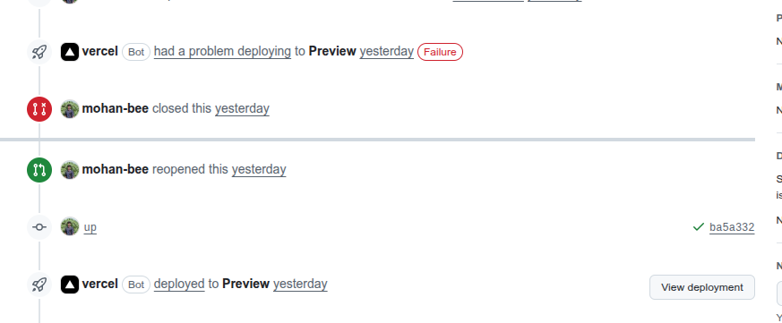

vercel deploy has been failing for a while on tscircuit.com I don't have access to logs: https://tscircuit-iujjb6e8y-tscircuit.vercel.app/
astrimid
First failure or runframe update after last success: https://github.com/tscircuit/tscircuit.com/pull/4058/changes First failure of eval update after last success: https://github.com/tscircuit/tscircuit.com/pull/4098/changes
astrimid
These two releases failed vercel deploy: "@tscircuit/runframe": "^0.0.2272", "@tscircuit/3d-viewer": "^0.0.578", "@tscircuit/eval": "^0.0.1075", I tracked down runframe change: https://github.com/tscircuit/runframe/pull/4090/changes#diff-7ae45ad102eab3b6d7e7896acd08c427a9b25b346470d7bc6507b6481575d519R71

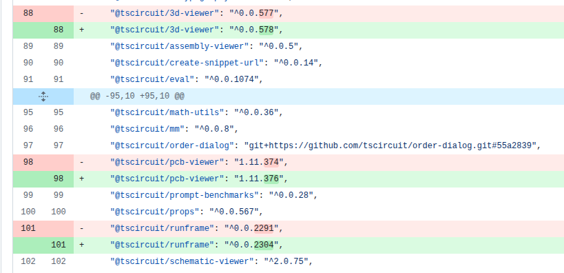

Ok, I might have misread. First deploy failed, then some change then succeded. The change was this: ``` "circuit-to-svg": "^0.0.376", "circuit-to-svg": "^0.0.393", ``` autoupdater bumped runframe: ``` "@tscircuit/runframe": "^0.0.2291", ``` and 3d viewer: `"@tscircuit/3d-viewer": "^0.0.578",` that failed, so <@1238122660345548882> bumped manually, but skipped 3d-viewer: `"@tscircuit/runframe": "^0.0.2291",` That still failed, then he added this: ``` - "circuit-to-svg": "^0.0.376", + "circuit-to-svg": "^0.0.393", ``` This succeded, but subsequent bumps still want to update that 3d-viewer. So might be not caused by runframe. I stil believe `circuit-json` should be a runtime dependency of runframe, not devDependency. Might try that next and look into 3d-viewer bump.
astrimid
This is the first PR that failed after the successful merge: https://github.com/tscircuit/tscircuit.com/pull/4098/changes

https://tscircuit-n89ks9407-tscircuit.vercel.app/ viewbuild button?
on it
astrimid
So `bun add @tscircuit/props@latest` should work?
astrimid

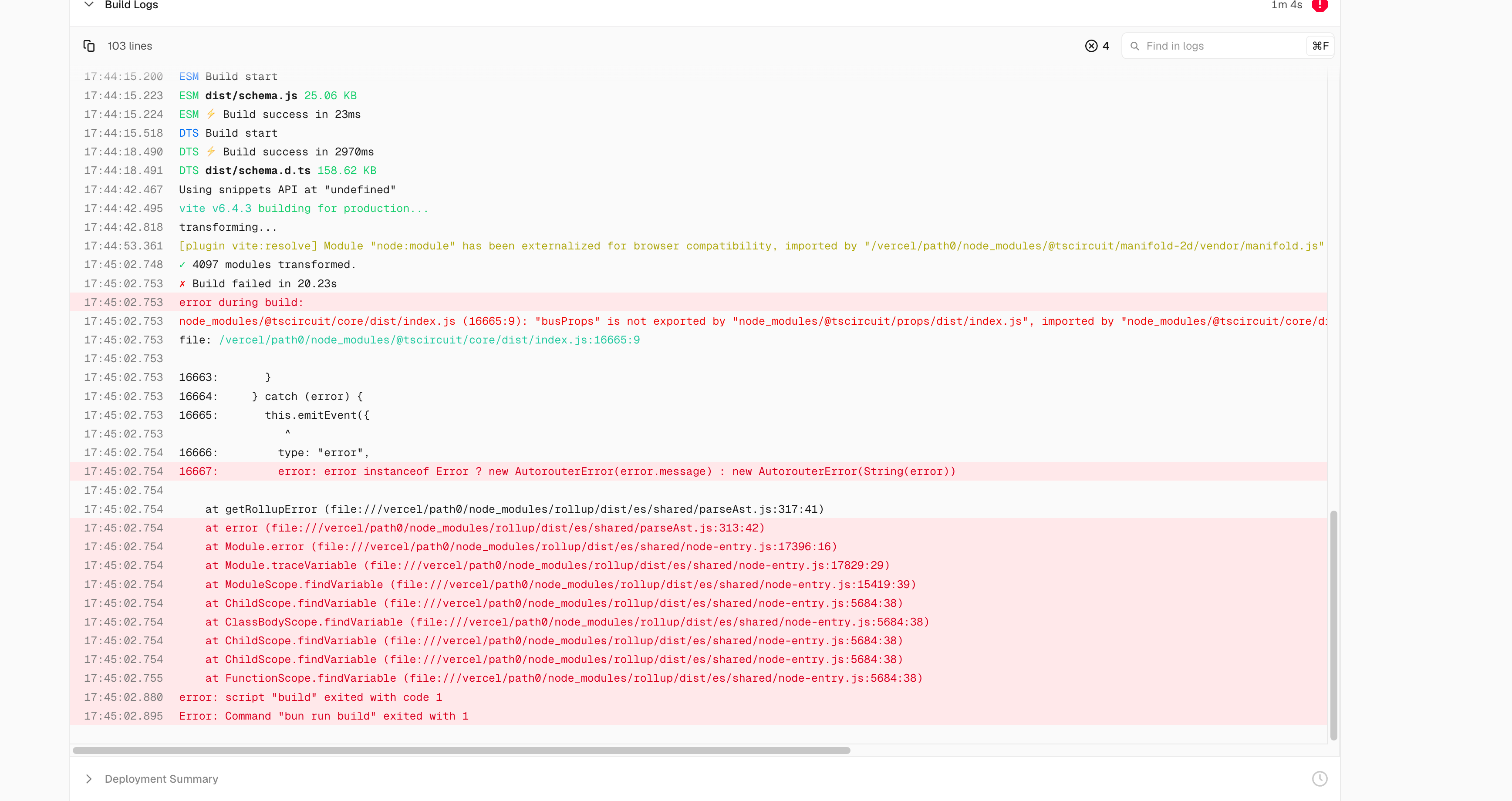

`core` is trying to use `busProps` property from `props`
yea maybe core jsut needs to update
busProps are somewhat new, `npm ls @tscircuit/props` may reveal why that dep is getting duped
astrimid
same issue essentially, `core` has new `props` in `devDependencies`. `tscircuit.com` depdends on `core` but doesn't inherit its new dependency. The autoupdater bot for some reason doesn't bump the `props` version in `tsicrcuit.com`: ``` "@tscircuit/props": "^0.0.567",```

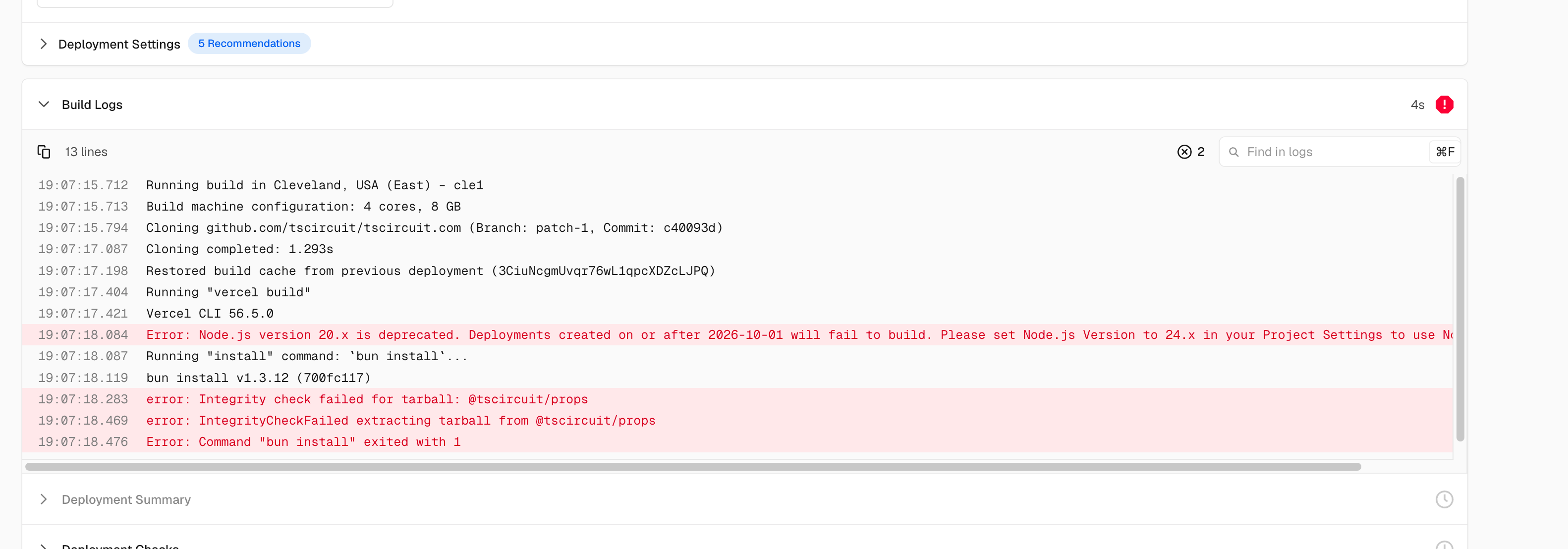

https://tscircuit-7t4frzels-tscircuit.vercel.app/ https://github.com/tscircuit/tscircuit.com/pull/4125
astrimid
could be too new `props`?
wtf
maybe upgrading the node version would help?
i set it to 24
astrimid
Ah, probably didn't update lock file properly

https://github.com/tscircuit/runframe/pull/4205 Bun library consumption passes with dependencies moved. There are some warnings: ``` warn: incorrect peer dependency "@emnapi/core@1.11.1" warn: incorrect peer dependency "@emnapi/runtime@1.11.1" @types/node@24.13.3 (v26.1.2 available) typescript@6.0.3 (v7.0.2 available) npm warn peer react@"19.1.0" from @tscircuit/3d-viewer@0.0.578 npm warn peer react@"^16.8.0 || ^17.0.0 || ^18.0.0" from react-query@3.39.3 npm warn Conflicting peer dependency: react@18.3.1 circuit-json@"^0.0.453" from tscircuit@0.0.2142 peer circuit-json@"^0.0.446" from @tscircuit/cli@0.1.1769 deprecated prebuild-install@7.1.3: No longer maintained. deprecated glob@7.2.3: Old versions of glob are not supported, and contain widely publicized security vulnerabilities, which have been fixed in the current version. deprecated rimraf@3.0.2: Rimraf versions prior to v4 are no longer supported 26 vulnerabilities (6 moderate, 20 high) warn: incorrect peer dependency "typescript@6.0.3" warn: incorrect peer dependency "react@19.2.8" warn: incorrect peer dependency "circuit-json@0.0.454" warn: incorrect peer dependency "@tscircuit/alphabet@0.0.25" ```

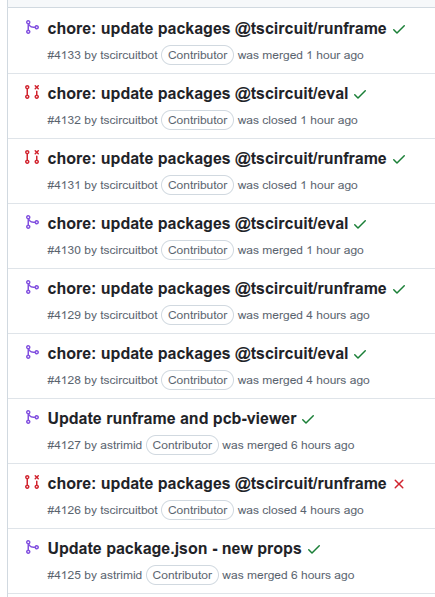

A bit more stable, but still some random failures:
astrimid
Hm, not failures actually, just bot closing unmerged PRs because of rapid fire of updates. And one sorta race condition bug: when bot triggers update from runframe for example, it closes the PR triggered by another bump requrest, like eval. So now eval isn't up to date because runframe triggered change closed that PR. So now eval is out of sync.
astrimid
Completely separate issue from this thread, but if eval and runframe are changed to use `"^1.0.1088"` for example, the upgrade script would only have to do bun.lock update which would bump both evan and runframe. As a short term fix, bot shouldn't close PRs not created by the job.
