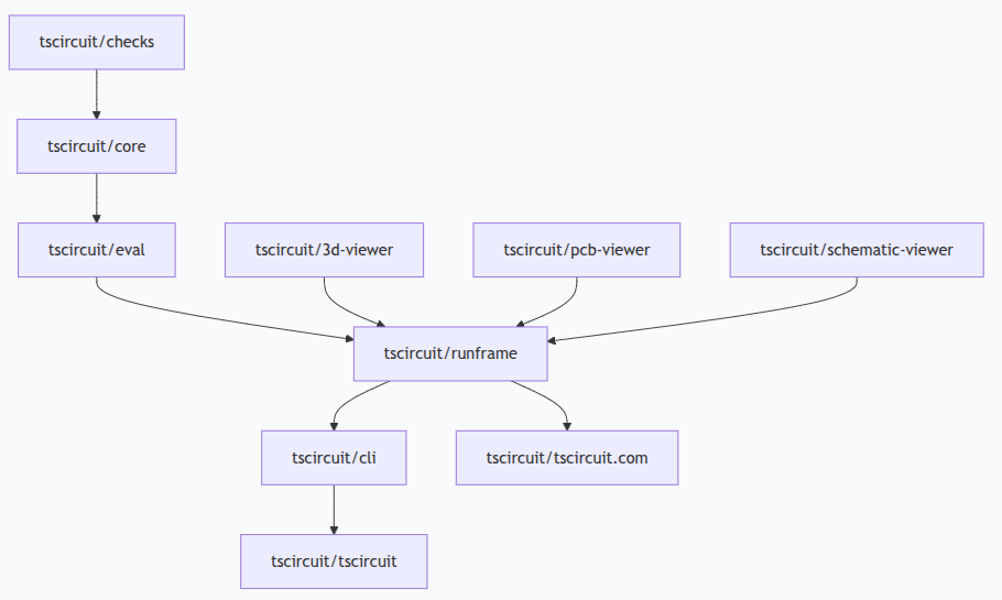

here's dependency tree according to npm
yea that's an old version from our docs
latest version here: https://docs.tscircuit.com/contributing/package-dependencies-and-auto-updates
those are the "major" dependencies
but the autorouter alone (which is excluded from that diagram because it has a special release team) has almost 100 dependencies itself haha but those are absolutely the major ones

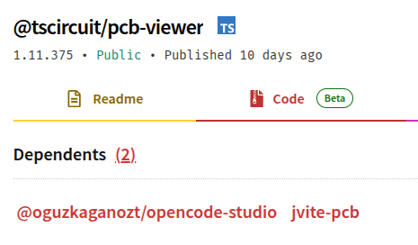

no, some packages don't have dependents at all.
astrimid
something is seriously wrong with package.json/build pipeline. it means those are not real packages, just code that happens to be on npm - monorepo code that published to npm as a side effect. you might as well not publish to npm at all
the packaging is not perfect but it is usab.e. I have no idea what the "dependent" packages are there, since they are unaffiliated users of the library (presumably)
astrimid
npm tracks all package that lists the package in question in "dependencies" as a dependent. if you don't have pcv-vewier in depedendencies of any of your repos, that means you have a build pipeline that doesn't use npm

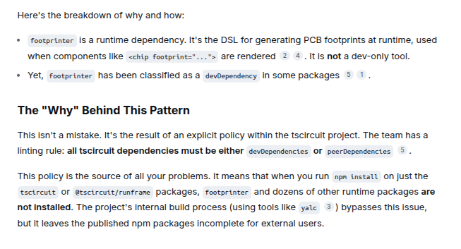

for example, why `footprinter` is a `devDependency` of `tscircuit`? Does it not run in runtime?
astrimid
astrimid
why exactly all dependencies are devDependencies? I don't get it
astrimid
So it's a deliberate design choice: https://github.com/tscircuit/lint/issues/4

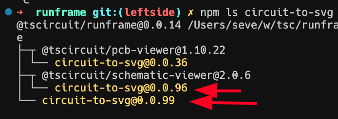

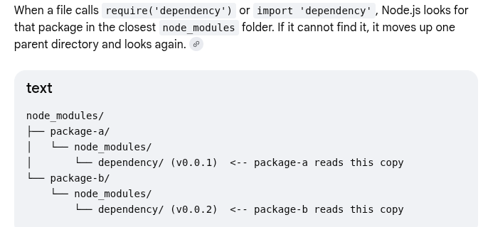

astrimid
this is expected behavior when you use 0.0.x packages. npm duplicates 0.0.x dependencies because semVer standard treats every 0.0.x version as containing breaking changes. had you used compatible versions, such as "1.0.*", npm would've always installed the latest version of the package, which is what you probably want
ah that's interesting, i didn't know npm had that special 0.0.x behavior
we should increment to 0.1.x for everything
if we have to do 1.x.x that's OK but not my preference hahaha
astrimid
this is actually the whole reason why npm ecosystem works. if there's incompatibility, the package is silently duplicated and there's no problem
astrimid
if the versions are deemed compatible by the semver convention, npm deduplicates packages and installes the minimum compatible combination
astrimid
if you want to force package version to be compatible, you can put `"overrides"` in `package.json` root and it would use that single version for all dependencies

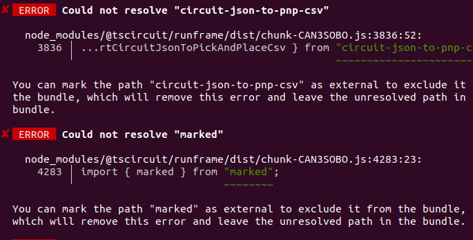

that's exactly what I did:
astrimid
``` "scripts": { "dev": "bunx vite", "build": "bunx vite build", "preview": "bunx vite preview" }, ```
astrimid
``` import { RunFrame } from "@tscircuit/runframe" ... <div style={{ flex: 1, overflow: 'hidden' }}> <RunFrame fsMap={{ "main.tsx": DEFAULT_CIRCUIT }} entrypoint="main.tsx" /> </div> ```

i think that's a bug
astrimid
afaik, npm doesn't have any way to install transitive devdependencies
circuit-json-to-pnp-csv should be built in
there are no transitive dev deps, dev deps are BUNDLED
so "marked" is, for some reason, not being bundled
which means it needs to either be provided as a transitive dependency by tscircuit or as a bundled dependency for runframe
CC <@452450065941004289> & <@809856037376491570> do you guys know what's up with marked?
astrimid
maybe something with bun version?
circuit-json-to-pnp-csv should be inside the main tscircuit/tscircuit package.json so that is a legit bug

maybe it's a big dep so deliberately excluded, but honestly astramid i would just work around those with a temporary install of the two missing deps
we'll patch the issue tho
just need to figure out why chestertons fence is there on marked
astrimid
it's not just two, there are hundreds of deps missing. could you provide any starter bun/vite project with runframe?

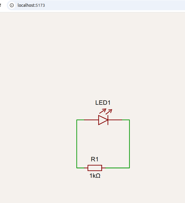

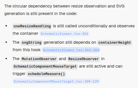

now I have a strange bug, the schematic view is moving down
astrimid
astrimid

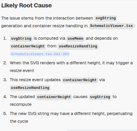

maybe the issue of using 100vh
astrimid
it's not moving per see, it appears the height is growing uncontrollably
astrimid
the height of svg seems to be incrementing 20 times per second
astrimid
astrimid
``` const svgDiv = useMemo( () => ( <div ref={svgDivRef} style={{ pointerEvents: clickToInteractEnabled ? isInteractionEnabled ? "auto" : "none" : "auto", transformOrigin: "0 0", }} className={ onSchematicComponentClicked ? "schematic-component-clickable" : undefined } onTouchStart={(e) => { if (editModeEnabled && isInteractionEnabled && !showSpiceOverlay) { handleComponentTouchStartRef.current(e) } }} // biome-ignore lint/security/noDangerouslySetInnerHtml: <explanation> dangerouslySetInnerHTML={{ __html: svgString }} /> ), [ svgString, isInteractionEnabled, clickToInteractEnabled, editModeEnabled, showSpiceOverlay, ], ) ```
astrimid
This is a workaround: ``` containerStyle={{ width: "100vw", height: "100vh", backgroundColor: "#f8f9fa", }} ```
