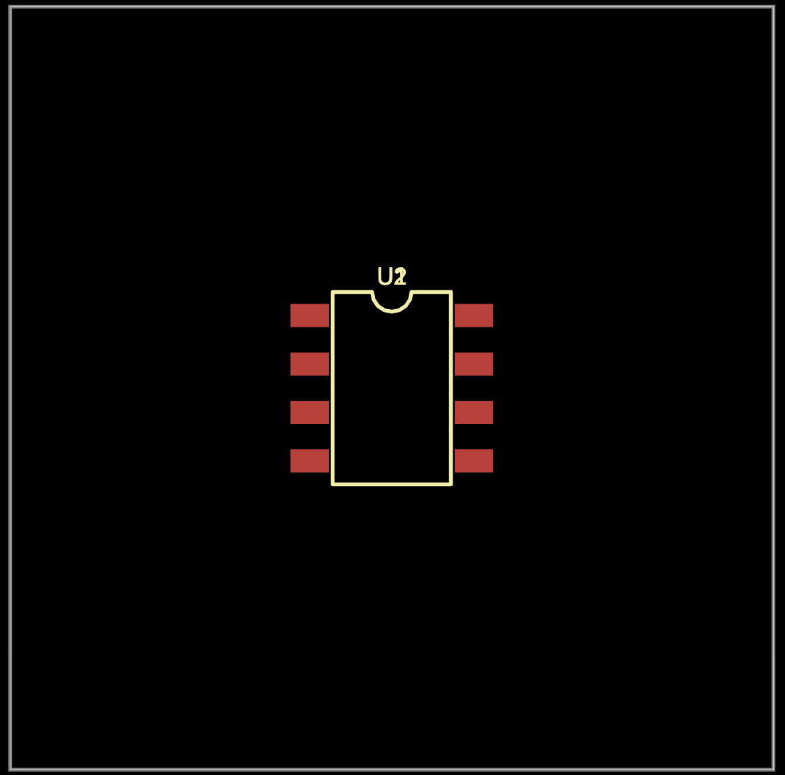

While building a board in the `tscircuit` repo, I noticed something and wanted to check if it's intentional. I was trying to disable placement DRC so the autorouter could continue despite overlapping footprints. `Circuit({ platform: { placementDrcChecksDisabled: true } })` works as expected, but `<board placementDrcChecksDisabled />` has no effect—the placement errors remain and autorouting is still skipped. I traced it and found the board prop gets stripped by the component schema before it reaches `@tscircuit/core`. Is `placementDrcChecksDisabled` only intended to be supported via `PlatformConfig`, or is this an oversight?
