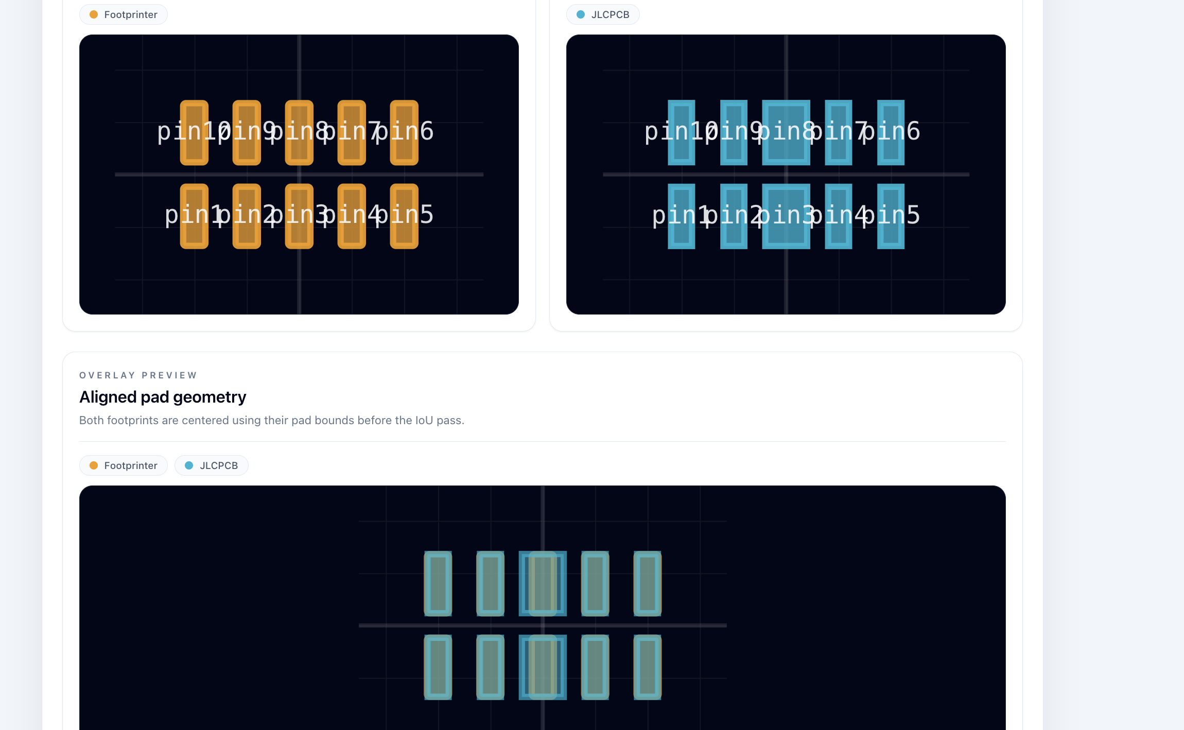

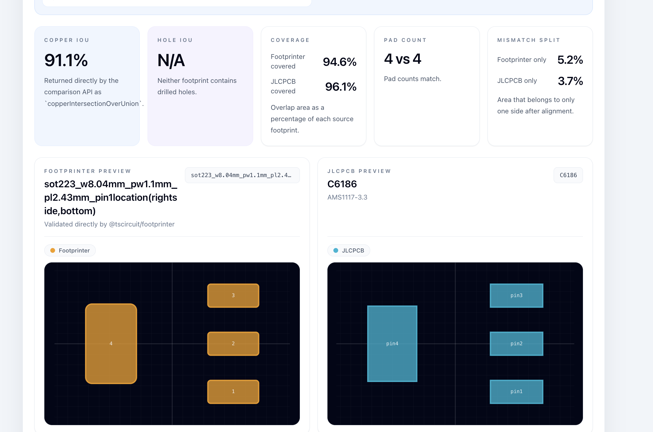

<@757706909351411845> is this considered ok , or need improving , 82%

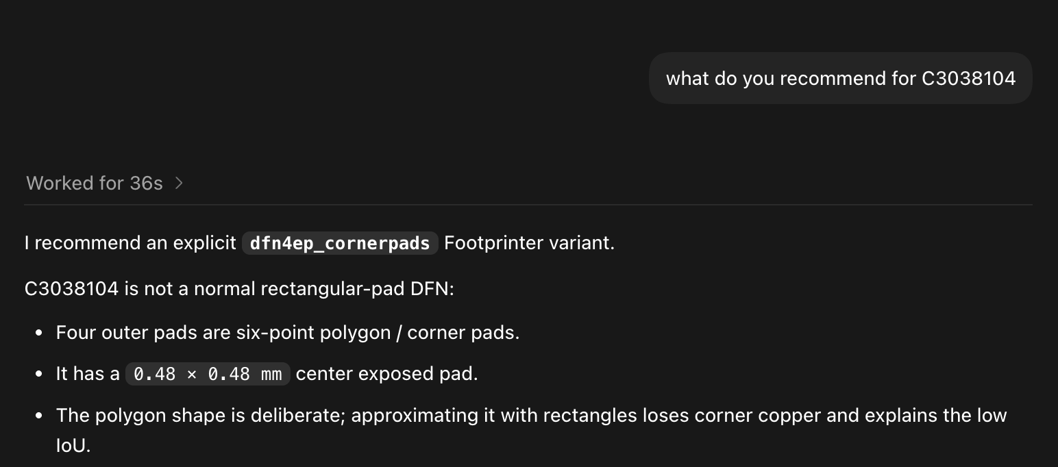

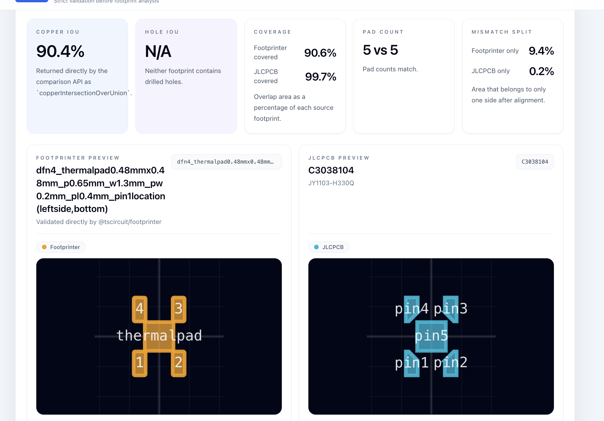

how should we do this ?
should this be it's own variant ?
Thats wild- yes perhaps- what is it?
voltage regulator
https://jlcpcb.com/partdetail/ShenzhenJingYang-JY1103H330QX/C3038104
wdyt
Hmm they call it a dfn
dfn with cornerpads ig
https://github.com/tscircuit/footprinter/pull/746
this is wrong one sec
yeah , I thought that what codex did when I reviewed I saw a new fn haha
