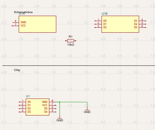

The workaround is to use another component and just treat schematic box as an overlay. But it won't expand the section size so that schematicbox will fit:

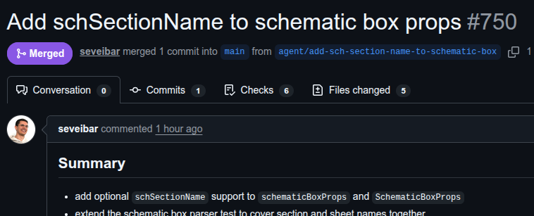

yep, we need to add to tscircuit/props so that it can be implemented in tscircuit/core

Ok, schematicbox zod schema does include schSectionNmae: ``` export const schematicBoxProps = z .object({ name: z.string().optional(), chipRef: z.string().optional(), pinLabels: pinLabelsProp.optional(), schPinArrangement: schematicPinArrangement.optional(), schX: distance.optional(), schY: distance.optional(), schSectionName: z.string().optional(), schSheetName: z.string().optional(), ```
