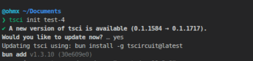

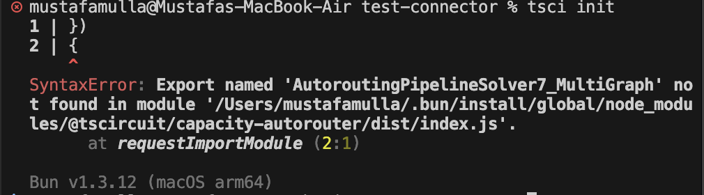

Anyone facing this issue when init a tsci project?

not seeing it anyone else <@398467566588264449> <@778624824875941908> can you guys test this
are you on latest tscircuit?
it asked me to update so i think i am on latest

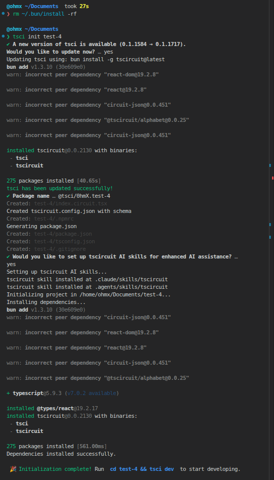

Might be my system issue
run ~/.bun/install -rf
and try again to init
run tsci --version
@ohmx ~/Documents/test-4 is 📦 v1.0.0 via 🥟 v1.3.10 ❯ tsci --version 0.0.2130
Its showing cli package version instead of tscircuit package version
This worked!
Thanks
