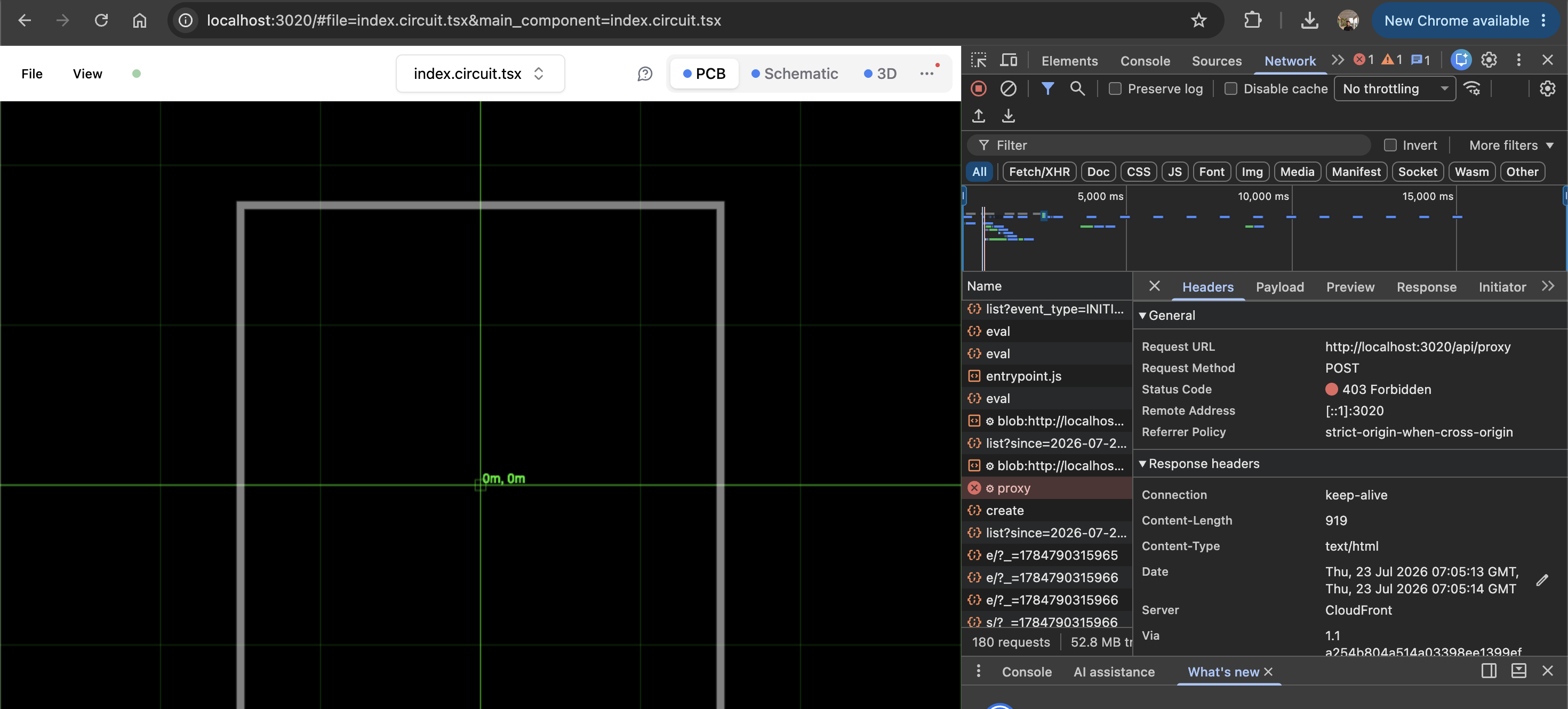

<@&1420812538421051555> this one is bad man
yea that is bad

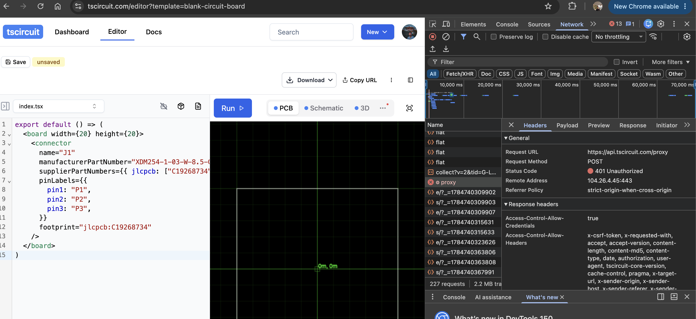

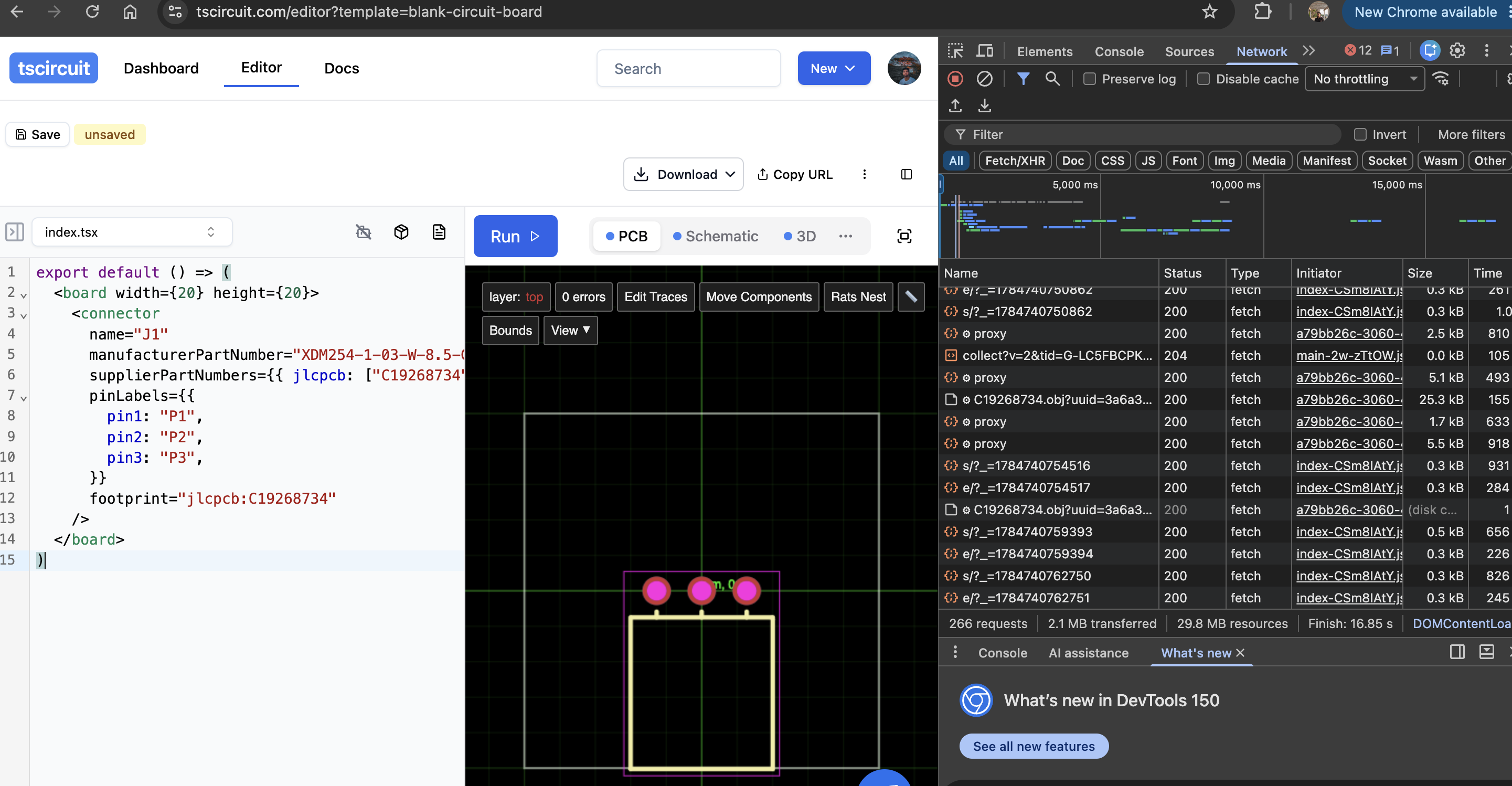

Check if logout and login works, maybe session token expired
can we improve the error for this?
I remember merging something to delete the session token and logout the user when the token is expired. But seems like it didn’t work
i don't like automatic deletion etc.- it's much better to just have a visible error
is this a @tscircuit/file-server issue?
Login should not matter right it's local
<@809856037376491570>
https://github.com/tscircuit/file-server/pull/145 Not sure if this is the correct repro codex created
https://github.com/tscircuit/file-server/pull/146 might be a fix
I don't remember how the local cli works
403 seems to be related to some other issue
