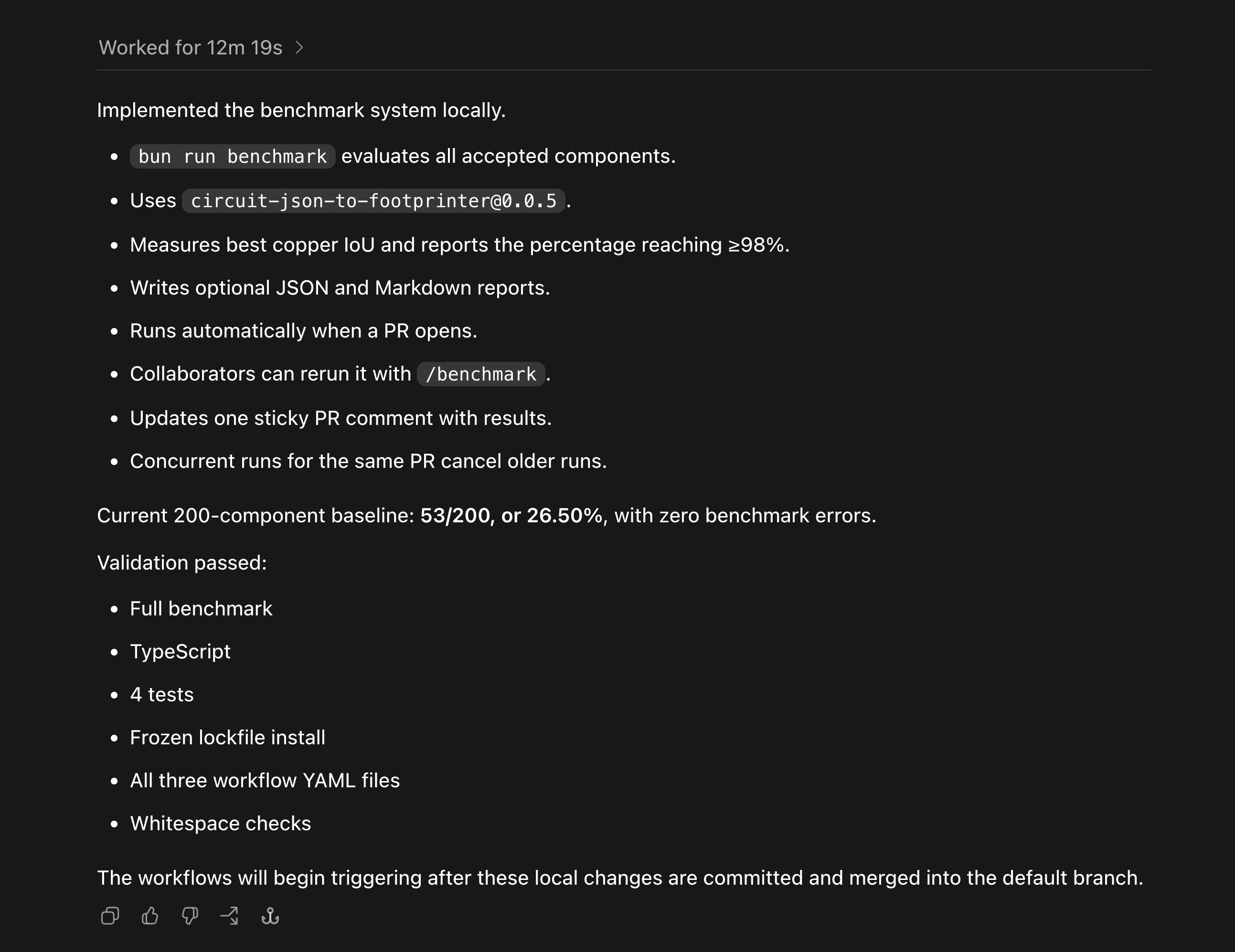

Seve - @Abse current baseline given 200 random ...
mention current baseline given 200 random JLCPCB components
Started by SeveJul 20, 202647 messages
<@398467566588264449> current baseline given 200 random JLCPCB components
repo: https://github.com/tscircuit/jlc5000

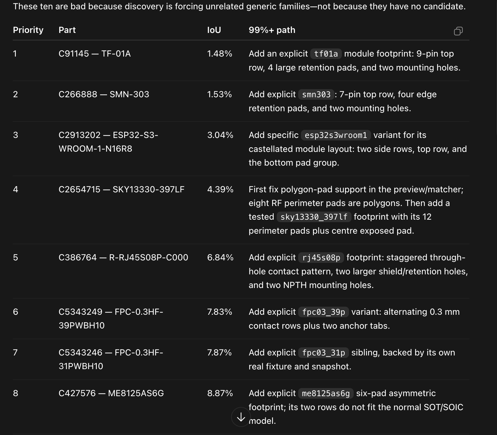

<@757706909351411845> some of the lowest scores in the jlc5000 repo
now should we make new fps ?
Hehe yea thats what ive been doing, yep one at a time for review
Though like i start with the highest rather than the lowest iou
Lowest iou is most custom(?)

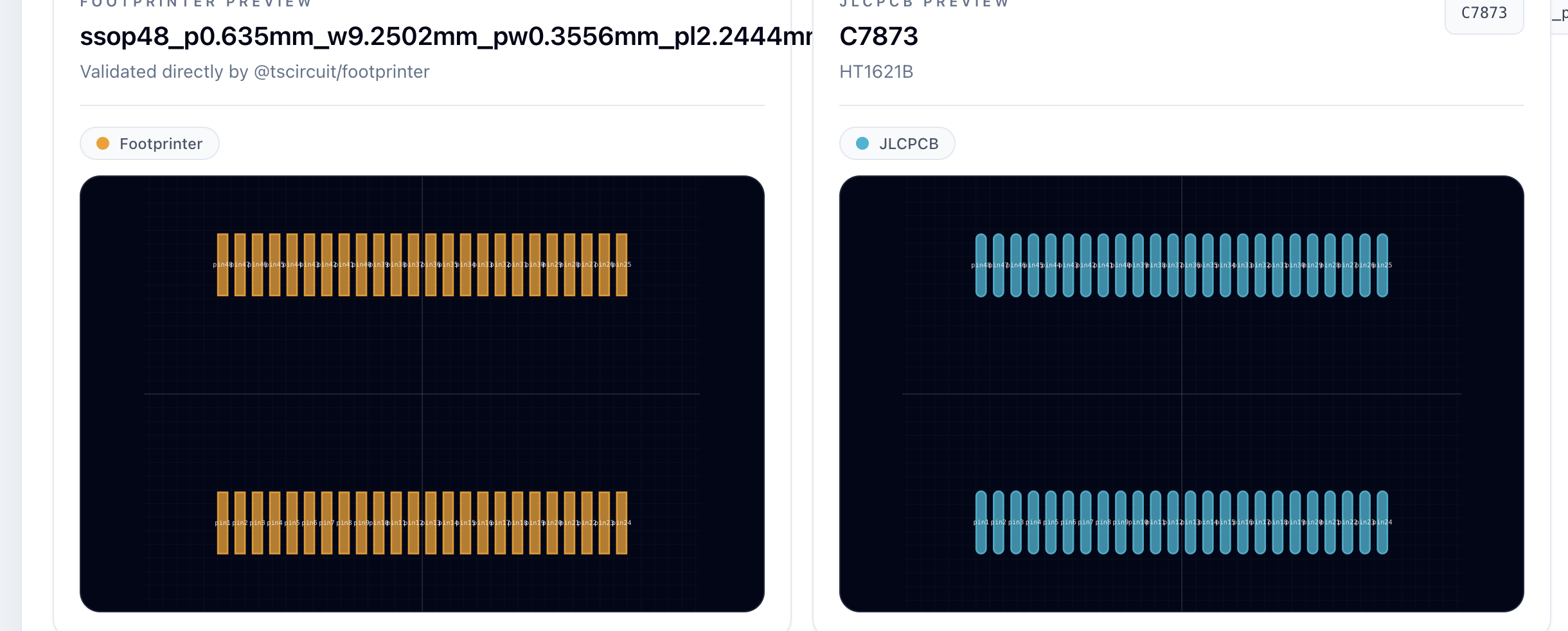

Yea i think so, not on every footprint tho
sry will be less afk soon
this is at 98% just messing pills
will take a look
