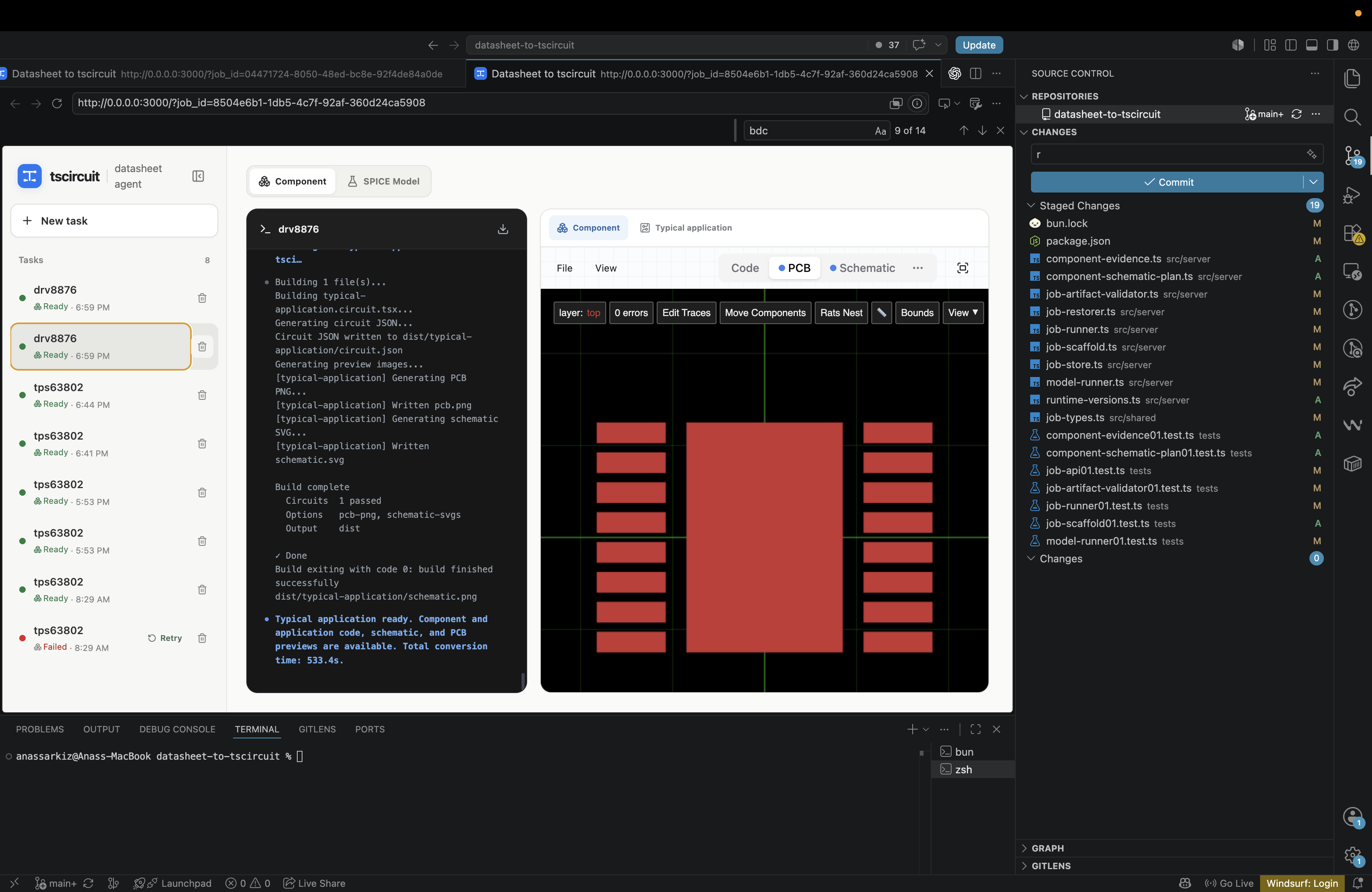

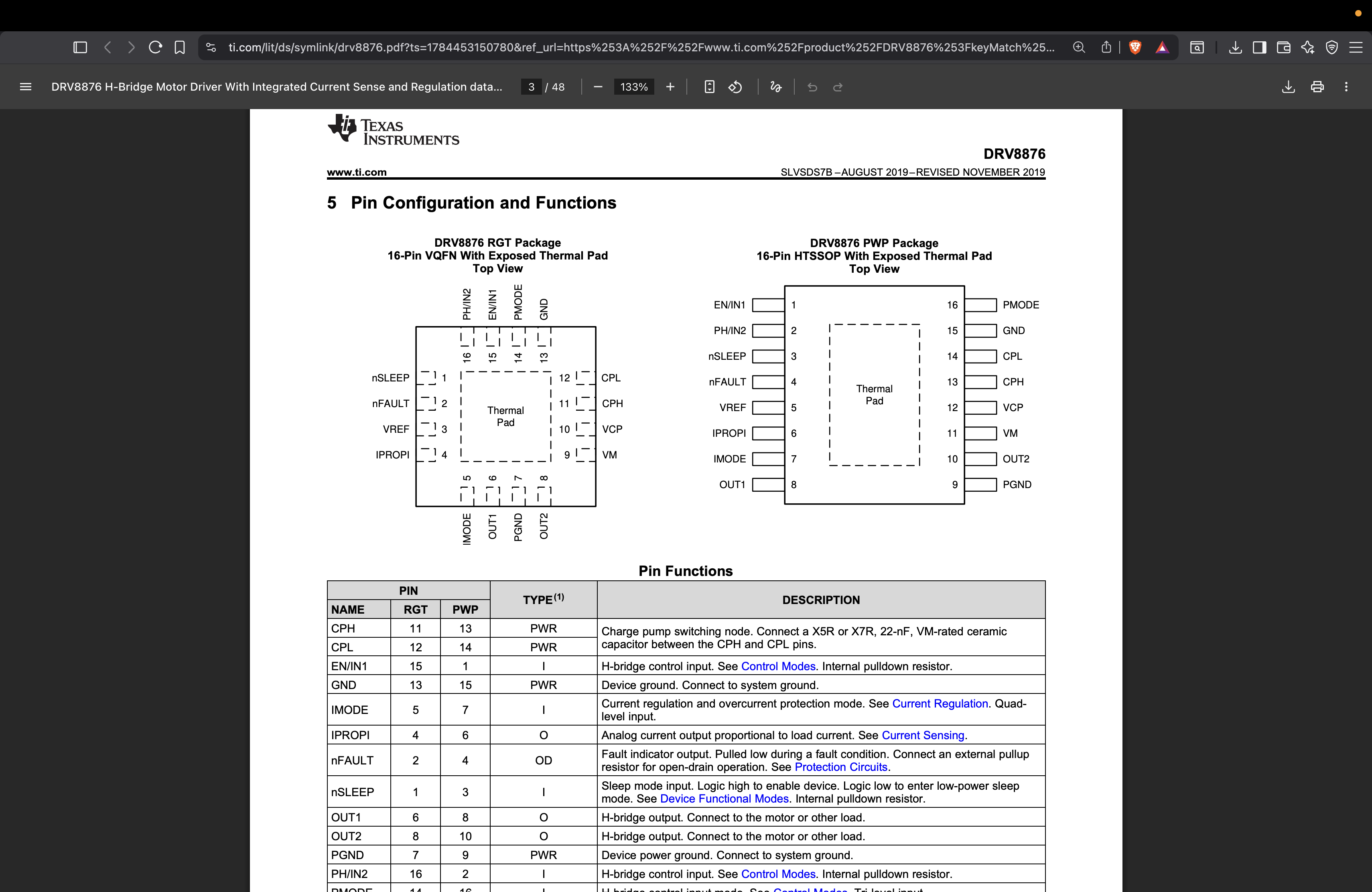

<@757706909351411845> one ti datasheet has two footprints
Anas

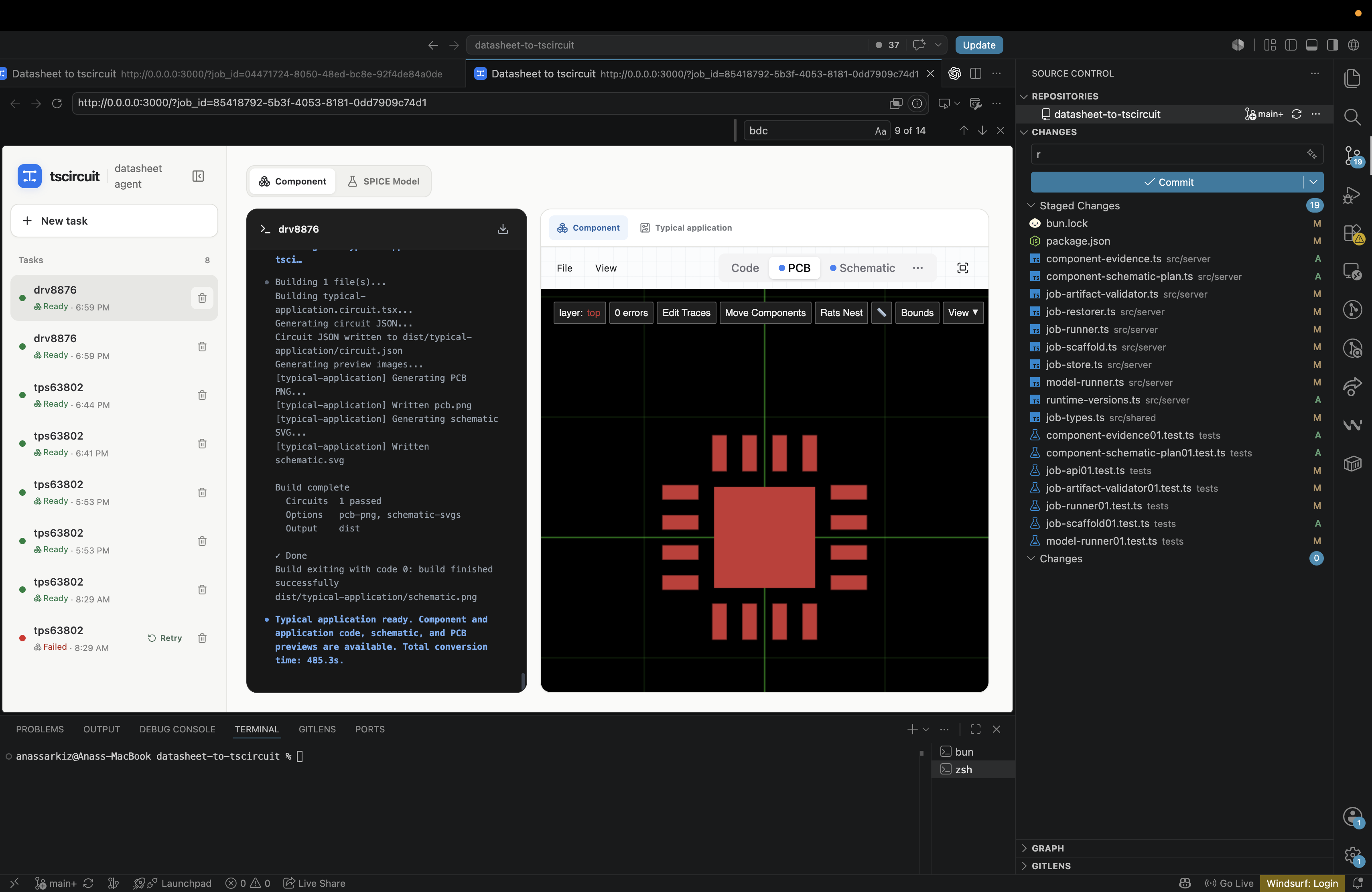

I ran the agent twice and each time created a different one
Anas
how should we handle this?
generate two components? each with a different footprint, suffixed by their package name (RGT/PWP)?
Datasheets have multiple packages, ask the ai how many package variations are in the datasheet or wtvr, separate components then a “unified” component with the footprintVariant prop may be a good idea
