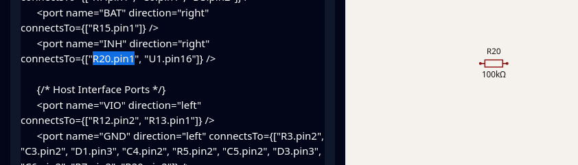

Hi guys.. connections to <port component is not displayed in the schematic.. In the attached circuit, both pins of R20 is connected to different <port components.

Hi guys.. connections to <port> component is not displayed in the schematic.. In the attached circuit, both pins of R20 is connected to different <port> components.
can you please give me the relevant tsx snippet? i want to try to reproduce

Looks like this is only reproducible in my setup. I tried to reproduce in tscircuit online editor and failed.
Vivek Vijayan
I think, this issue is highly specific to the method I render the circuit inside the runframe component. I use `circuit.add(<MyCustomComponent/>)` to render independent modules inside the runframe. I will update more info here as I move forward..
maybe you're using an older dependency?
maybe it's a stale dep in node_modules
