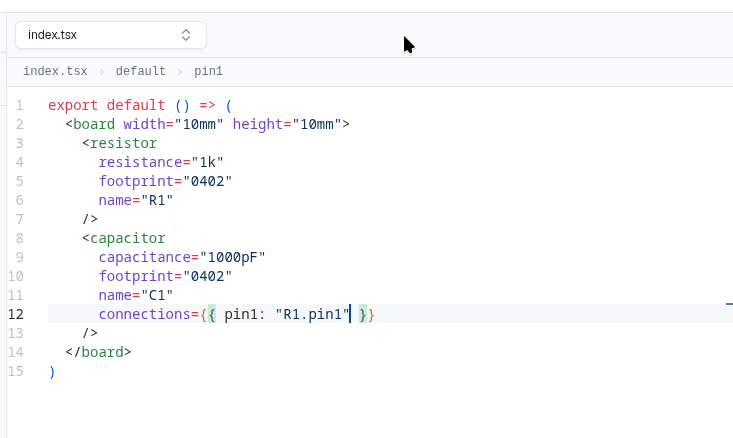

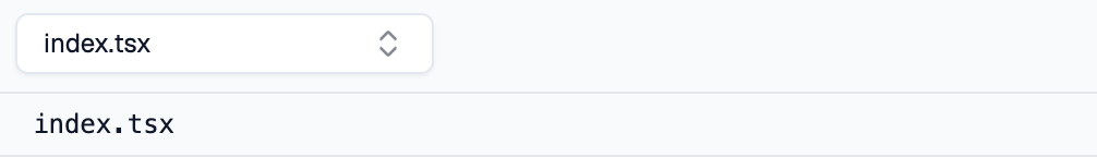

showing names two time , maybe we can prefer only one :
they both have different purpose
oh they are breadcrumbs ?
yeah
the top drop down is used in small screen
so ig we can remove it for large screen

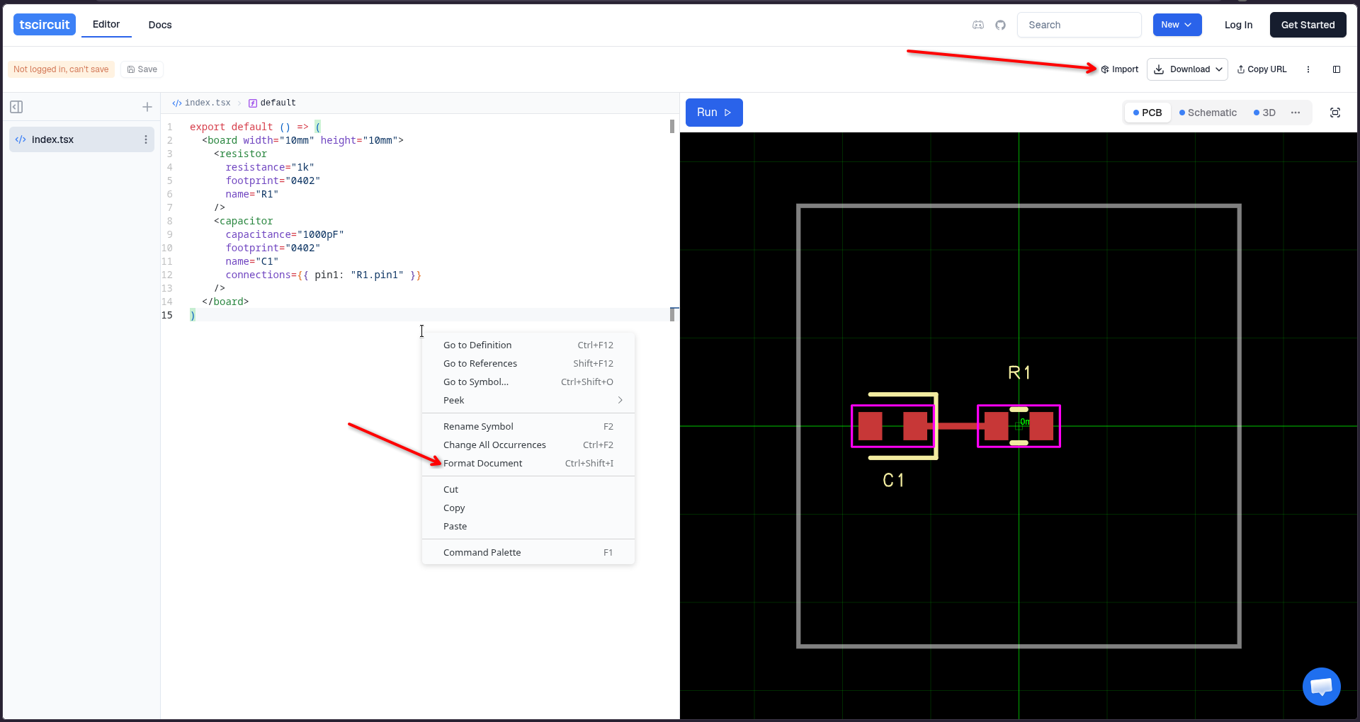

actually this is missing something important .. the "format and import" !
yeah we are not addig it in the editor
it is not a editor specific featuer, we will move it to the website itself
where should we add the option
we can add format in the editor ig
idk maybe somewhere here ? near the download or something ?
yeah

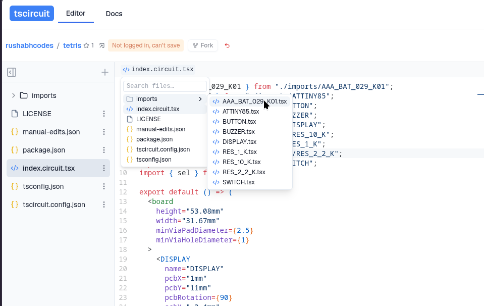

combined the search with dropdown like the vscode style ..
wait i have even better
It's amazing 🙌 🔥 <@452450065941004289>
But this feels like having a new filebar inside that ?
i followed vscode

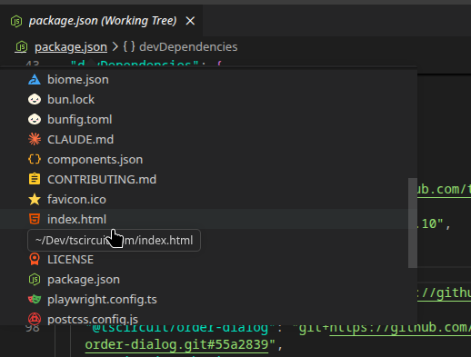

it doesn't give me any sense that here is the search ! like the search is hidden ?
ooh ok i never used that bread crump in vscode .
vs code also allow you to search
in the breadcrump
it just does not show you a seach box
how can i search ?
in vscode if you click on the breadcrumb and start typing it searches
but it is shallow search
our implemetation also search inside the dir

have you guys tried right click

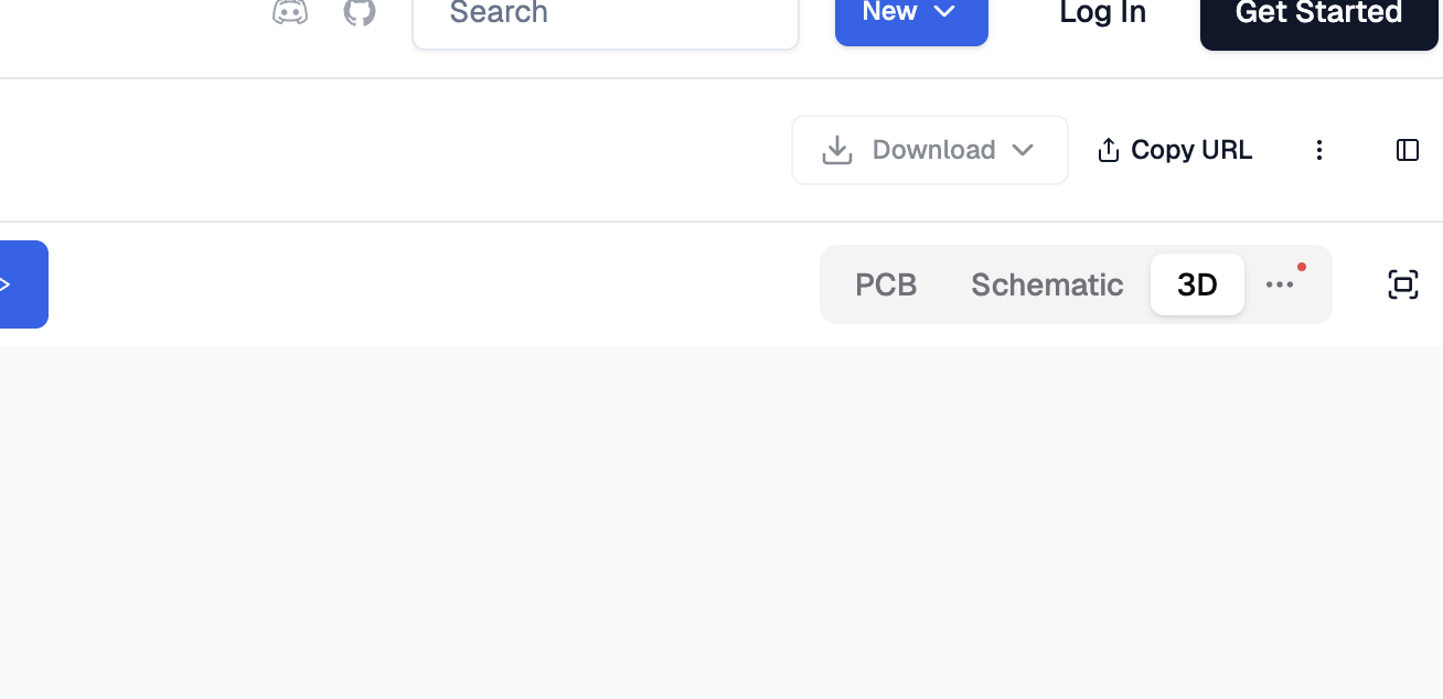

maybe we can keep the import in the center . Download | import | copy URL or you can match the style of download button ?
<@452450065941004289> please take this a look .. we have something cmd+p to search files .. we need to some how express that to users . ig this design looks clean <@&1420812538421051555> comments please : https://github.com/tscircuit/monaco-code-editor/pull/48

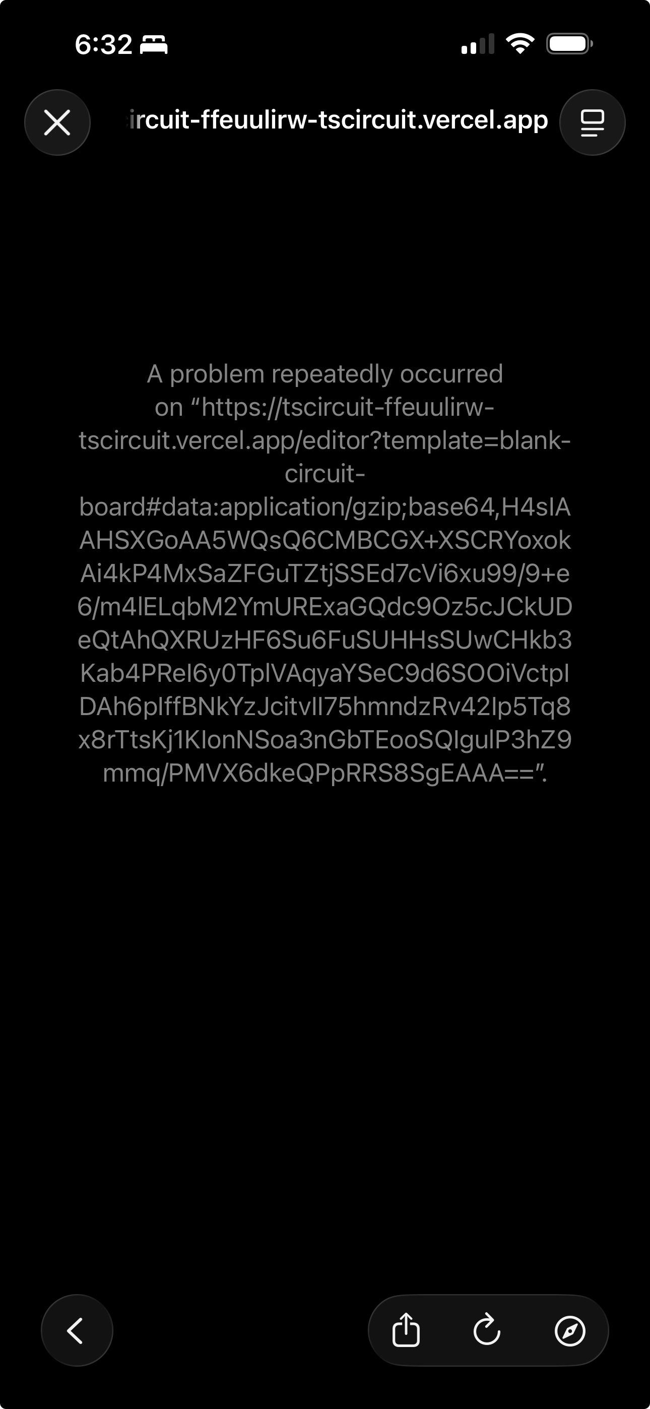

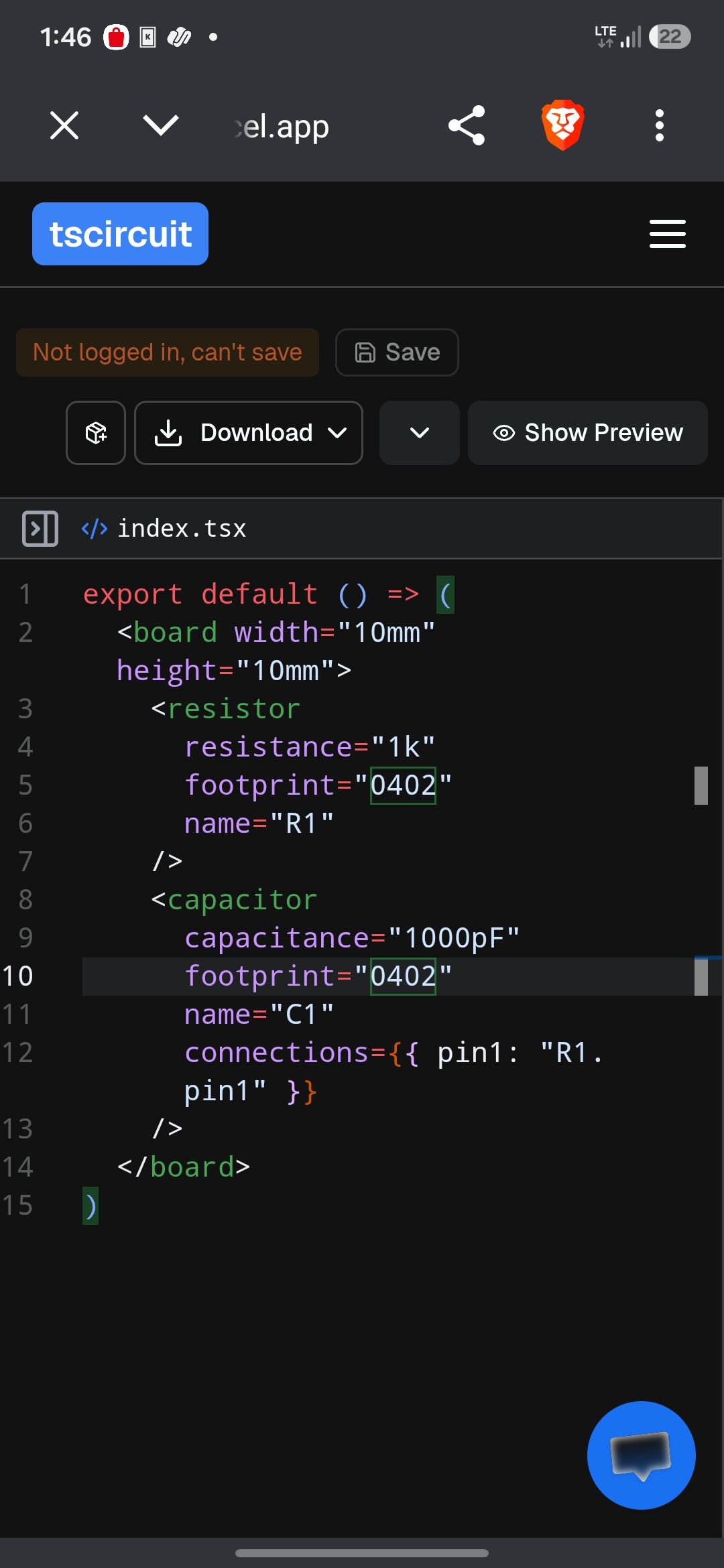

Mobile doesnt work for me, crashes
I can't seem to reproduce on my device.
<@&1420812538421051555> can you guys try in your devices
maybe browser?
i think its a safari specific bug then
+1
working fine for me in safari desktop
Yea idk hard to debug
bad :/
Iphone 15
Can you try changing browser so that we can identify if it is a browser issuse or somethig else.
<@&1420812538421051555> with an i phone please help!!
It would be nice if we get this resolved asap, i wanted to get this merged before open sauced, i believe our site will get more traffic for few days.
Crashes for me too, both safari and chrome

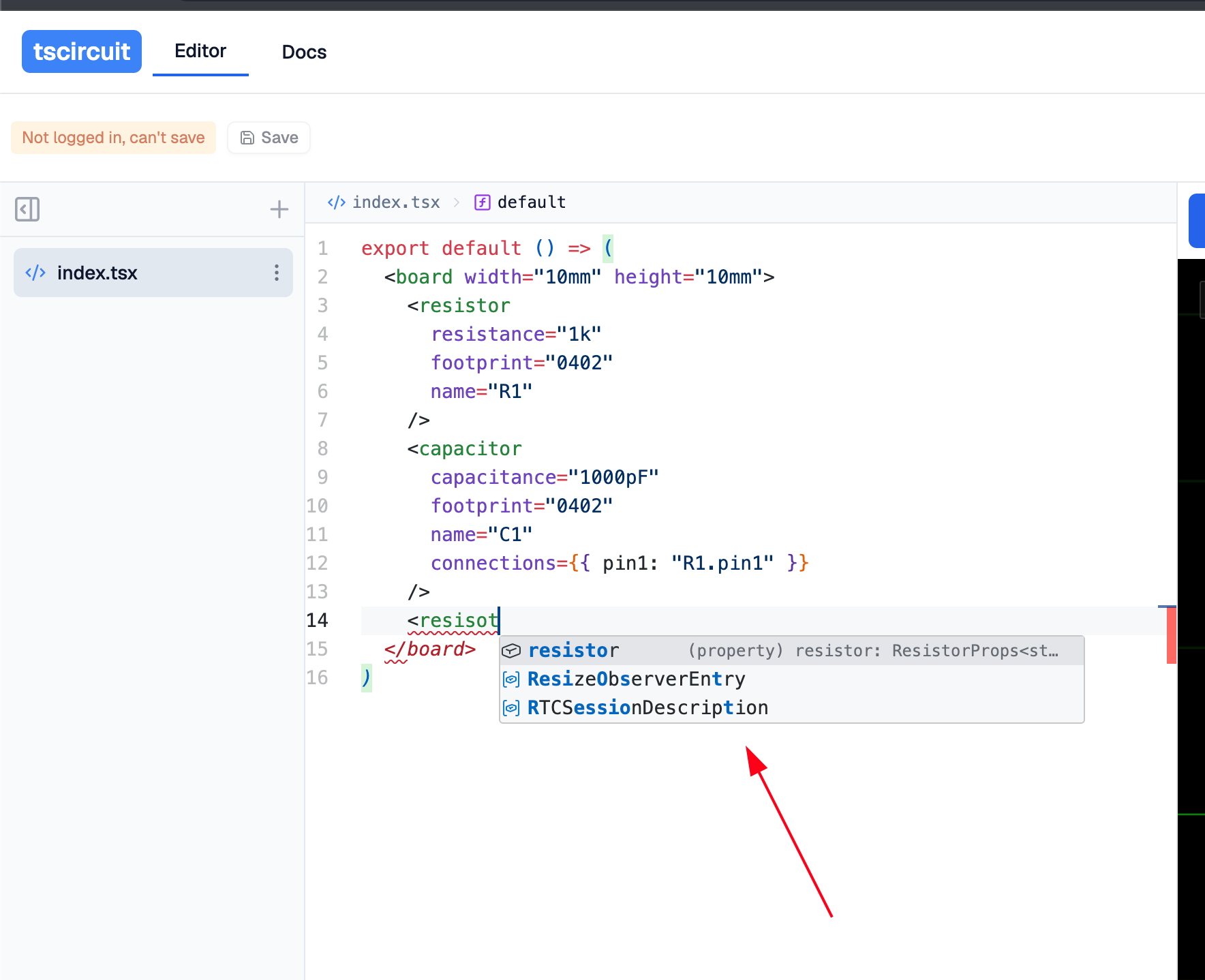

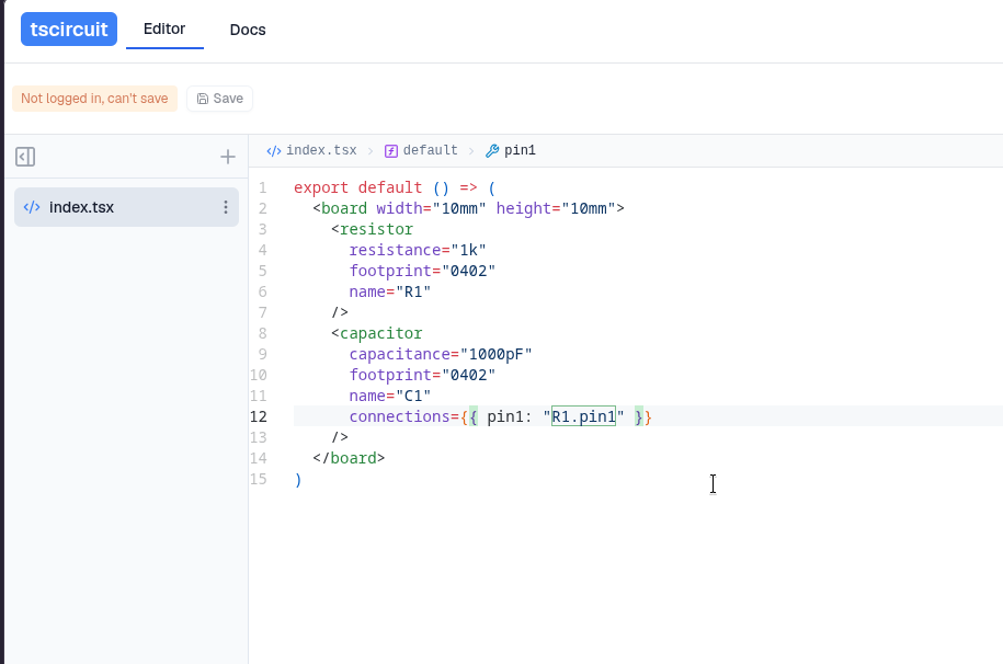

at my cpu for only a minute. I do really like it, is it possible to remove these autocomplete options
i'd like to just see tscircuit stuff, i think the other stuff generally shouldn't be used anyway
probably not possible- but would be nice- maybe we can prioritize properties or something?
not a huge deal- i think the crash is really the only thing blocking merge
oh also the mobile with the sidebar is pretty bad/hard to use- it only loads for a second for me but definitely shouldn't be showing me a sidebar

I think it is a ios specific bug, anyone with an iphone who would like to help me resolve this.
