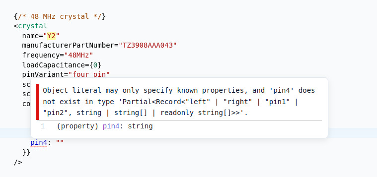

While creating the chips, I noticed that the four pin crystal variant only accepts left, right, pin1, and pin2. It doesn't accept pin3 and pin4. Could this be a bug?
Started by techmannihJul 14, 202610 messages
techmannihoriginal post
While creating the chips, I noticed that the four-pin crystal variant only accepts `left`, `right`, `pin1`, and `pin2`. It doesn't accept `pin3` and `pin4`. Could this be a bug?
likely a bug yea
https://github.com/tscircuit/props/pull/729
