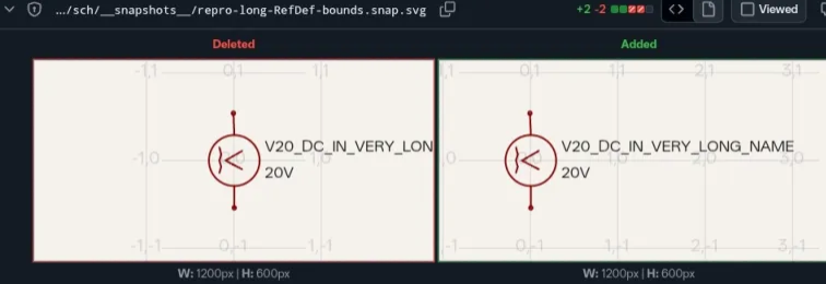

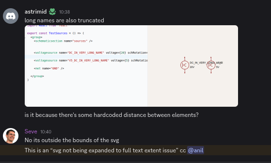

this is a user issue involving the getComprehensiveSvgBounds i think
you can attempt to repro
a long refdes isn't captured by the bounds
anil
yea makes sense. I will try to fix that one. I am happy to help the user.
anil
https://github.com/tscircuit/circuit-to-svg/pull/615
anil
thanks<@1079361271687807026> now i m fixing it.
anil
<@757706909351411845> I added the repo in the morning, and this PR contains the fix. please review it? https://github.com/tscircuit/circuit-to-svg/pull/616
anil
anil
<@757706909351411845> I added the repro which has merged by Mustafa https://github.com/tscircuit/circuit-to-svg/pull/615
