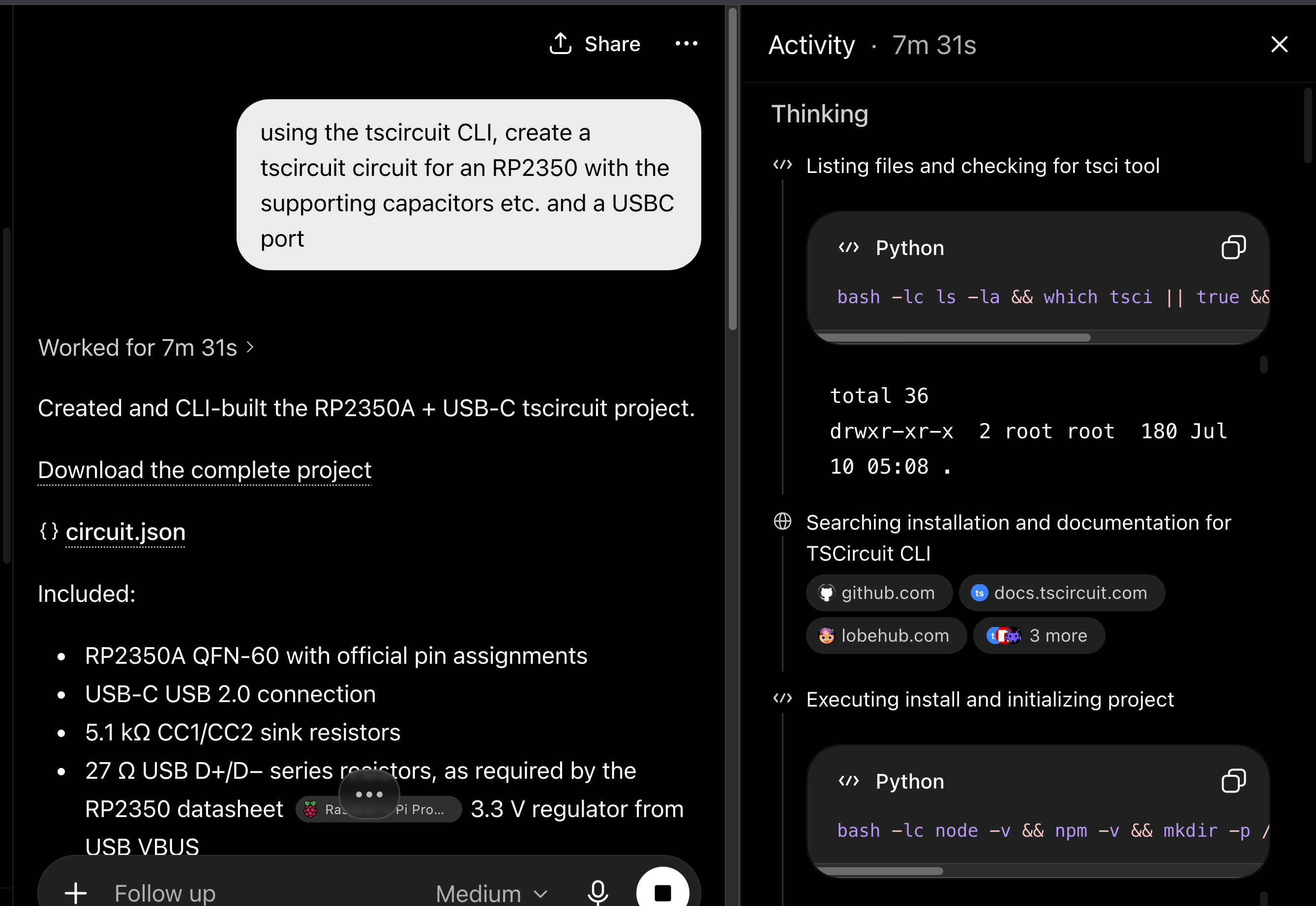

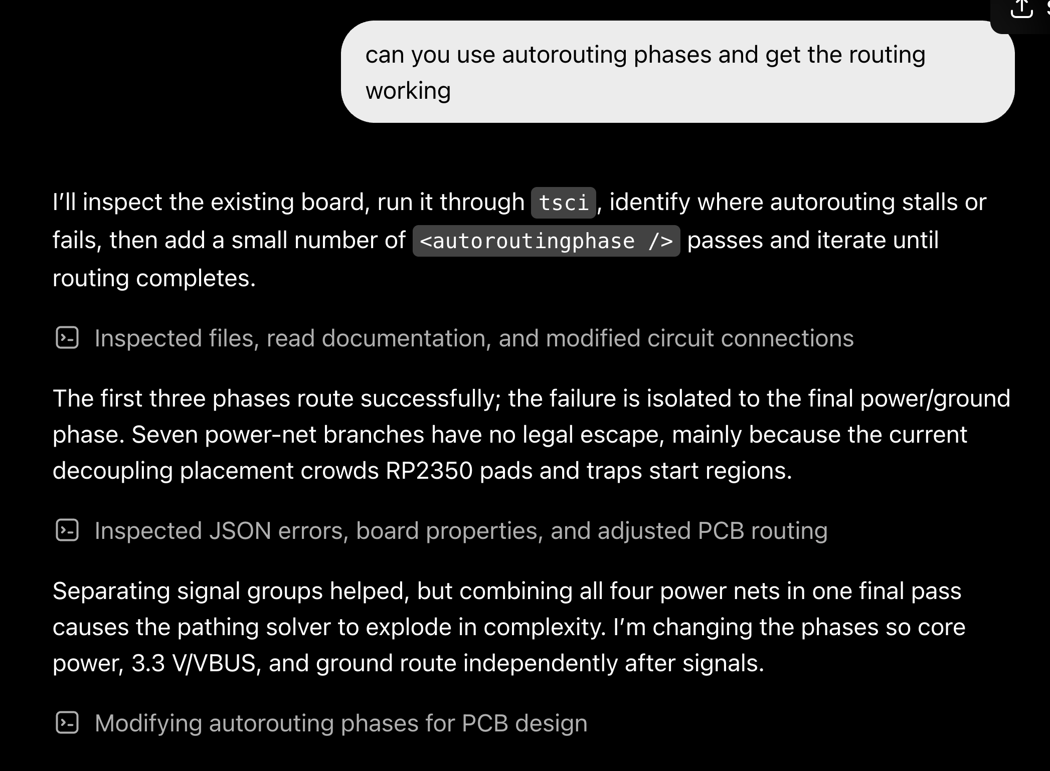

I keep asking ChatGPT Pro to create circuit boards but it gets super stuck on routing. I think we need to figure out a way to make routing debuggable- i introduced `tsci build --autorouter-debug` but the information isn't good enough- we need to keep interviewing AI and think of ways to allow AI to participate in the routing in some way or something
