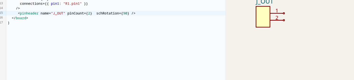

Isn't it how we should rotate the pinheader component? Am I doing something wrong?
Started by Vivek VijayanJul 9, 20269 messages
Vivek Vijayanoriginal post
yes that' how you need to do !
oh that's. an issue
it is not rotating right ?
let me check
I think there is a `facingDirection` prop
Yes, it's a bug
we use schPinArrengemet for this ig
I have merged a fix <@1050759023194030111>, github actions today weirdly are getting stuck and it will take 15-20min to go upstream I guess. You can use `schFacingDirection` prop for `<pinheader />` Reference the doc - https://docs.tscircuit.com/elements/pinheader
