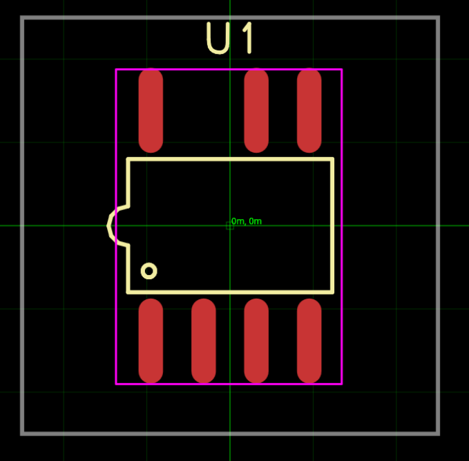

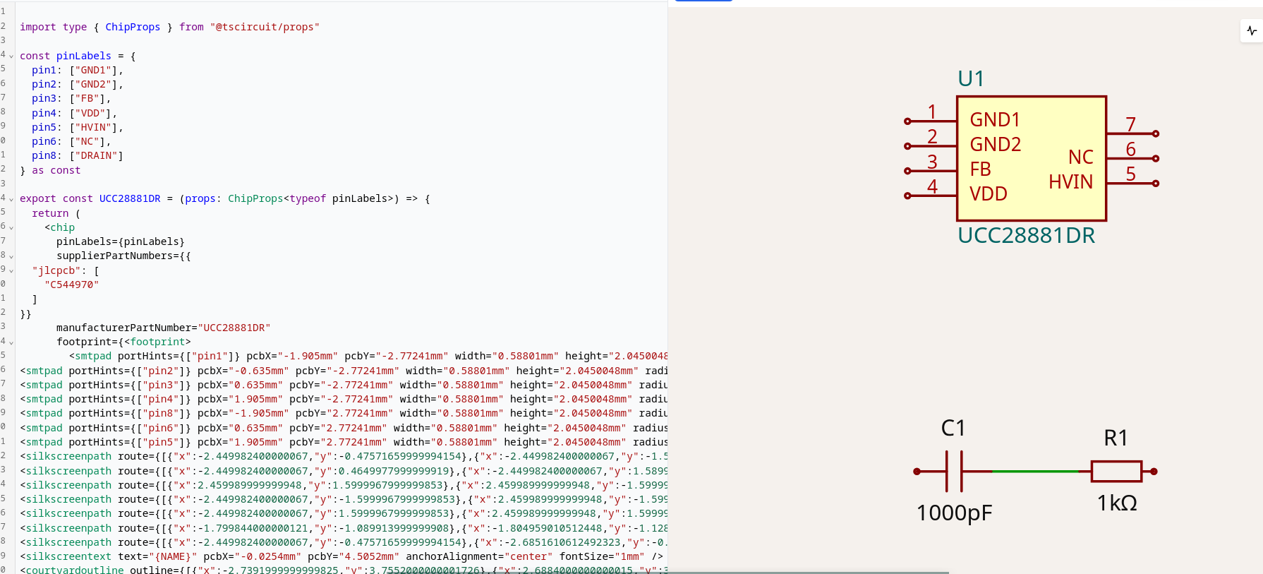

Found a strange rendering issue for UCC28881 component from JLCPCB library. Pin 7 is not present for the IC. But Pin 8 is present. footprint is correct, but schematic symbol fail to capture the detail.

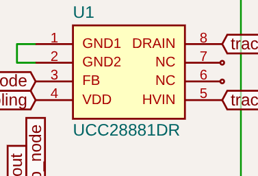

I did simple workaround to use the component in my circuit: Pin 6 is NC, overlapped Pin 7 footprint above Pin 6 in component tsx code. Now schematic is rendered properly. I think, we should add proper handling for special cases like this.
yeah, it's a bug in the schematic chip label
anil
<@809856037376491570>, could you let me know where this fix should be made? Is it in `easyeda-convertor`? I can try to fix it.
It was fixed, forgot to update it here
