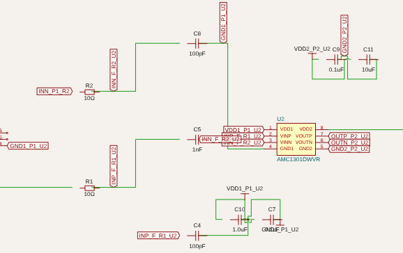

Hi guys.. I'm facing strange rendering issues in schematic view.

$ tsci -v 0.0.1927 This is my current version
yes you need to update the version.
Yea we have 0.0.2017 latest version npm install -g tscircuit tsci dev
This issue is solved in the latest version
bun update tscircuit --latest
Vivek Vijayan
I've updated to 0.0.2017. Still getting the same issue
can you share the package.json of the project ?
Vivek Vijayan
Sorry for late reply. this is my package.json
ig you are having something different , seperate packages , maybe you can just use tscircuit in dev dep , but if you want to get that fixed you have to update, the core, schematic-symbols, tscircuit. but this seems to have a lot ,
idk what are you working but yeah updating packages will get that fixed !
Vivek Vijayan
Finally it worked. Updated all the packages to latest version. Thanks for the support <@1238122660345548882> , <@1067854999889137715> Granular dependencies are intentional. I've a webpage in which runframe is a canvas element. So I have to render <Runframe> in my page. That's why I went with granular dependencies.
