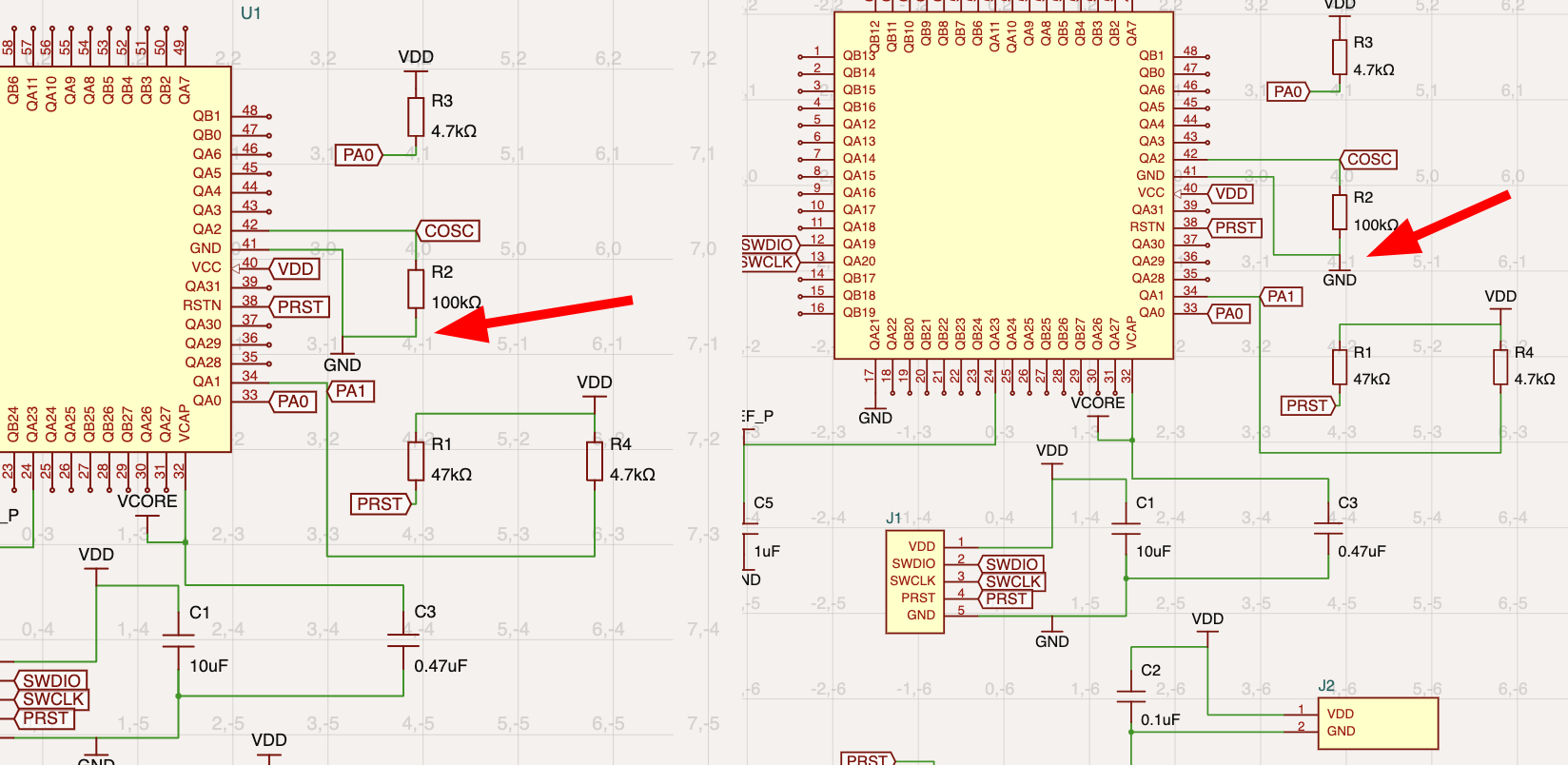

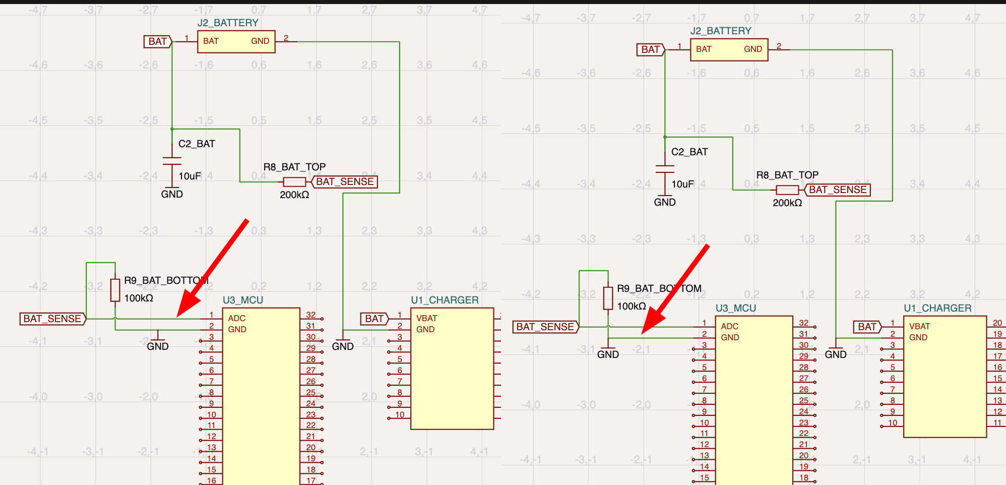

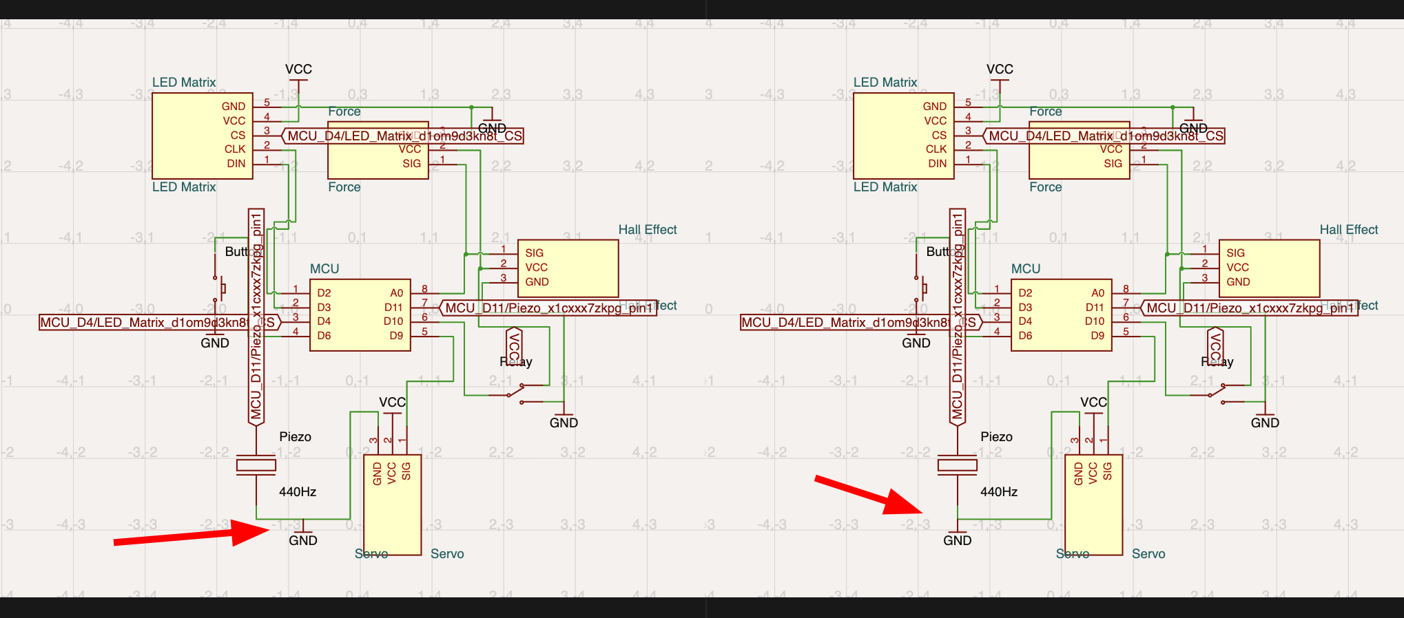

This is a bug in the net label position selection for symbols with a preferred orientation like VCC and GND with existing repros in core
Started by SeveJul 7, 202618 messages
When the preferred orientation is up, you search for the highest corner When the orientation is down, you search for the lowest
The GND issue is most obvious, the VCC label could go in the middle or on the left, the right side is too crowded

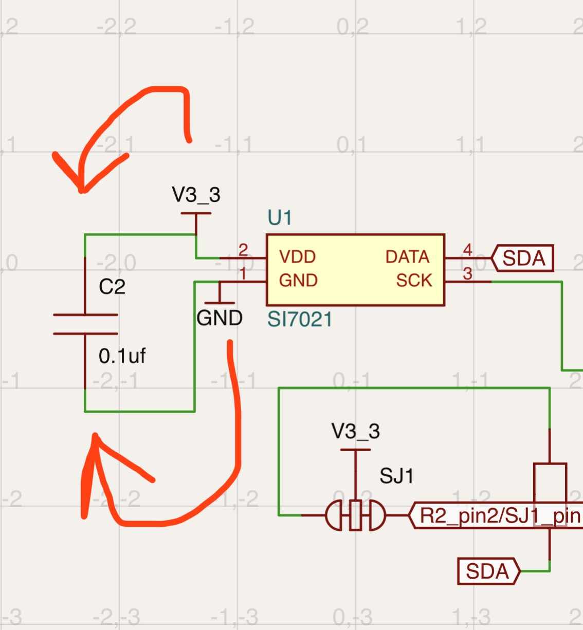

where is this image from <@757706909351411845> can we get this as a repro ?
would love to make this a repro
somewhere in core, i wish i attached the name
i wonder if ai can find the test based on the screenshot
some of your screenshots/arrows i don't understand the issues on fwiw
hmmm , so labels should be for eg GND label should be on the same level as the lowest port but not needed to be on the lowest port it self , it can be in mid between the ports ?
found it repro46
ty sry for not including the name
<@757706909351411845> https://github.com/tscircuit/core/pull/2608
