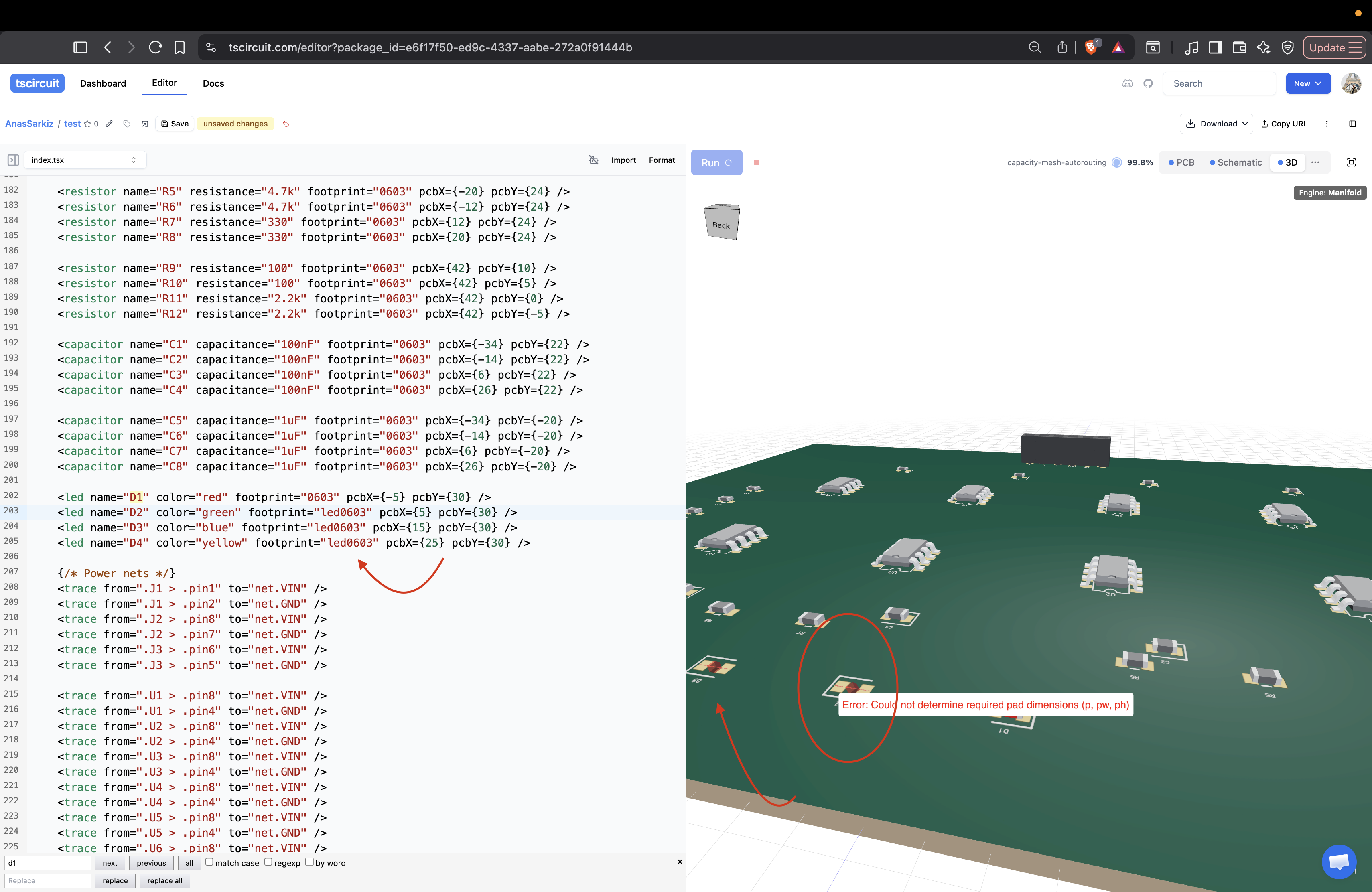

Anas - We have an issue with using the footprin...
We have an issue with using the footprint led0603, in the 3D viewer
Started by AnasJul 6, 20267 messages
Anas
it works when I try to use `0603`.
abdalraof
I will do my best
Anas
go ahead
footprinter repo most likely
or possibly jscad-electronics
abdalraof
https://github.com/tscircuit/jscad-electronics/pull/302
