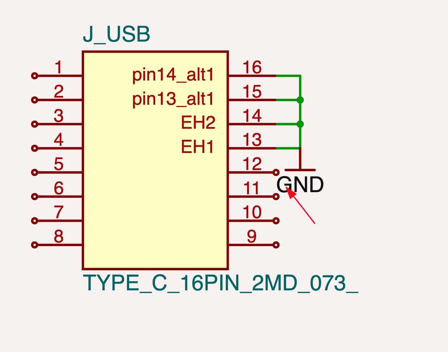

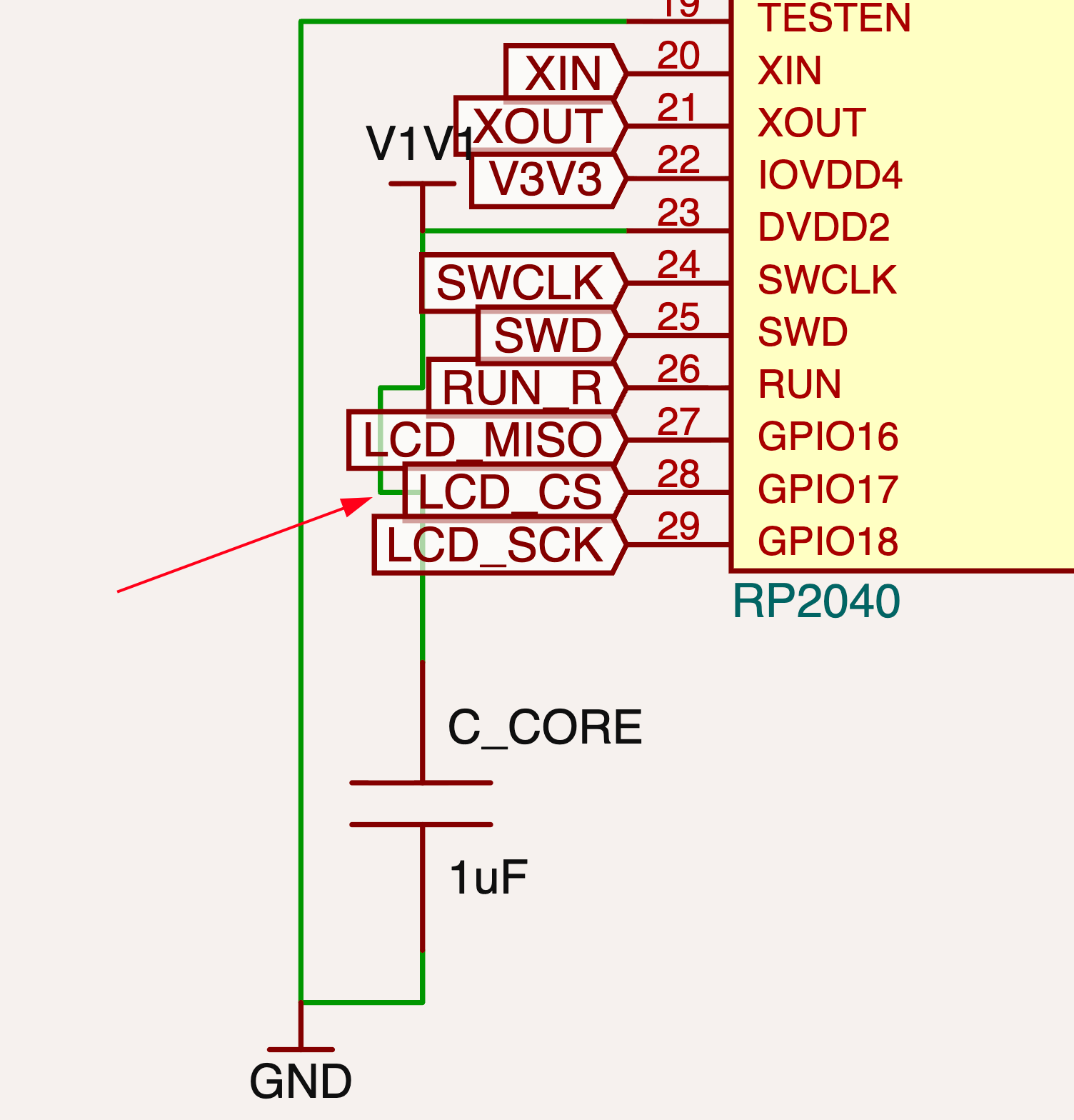

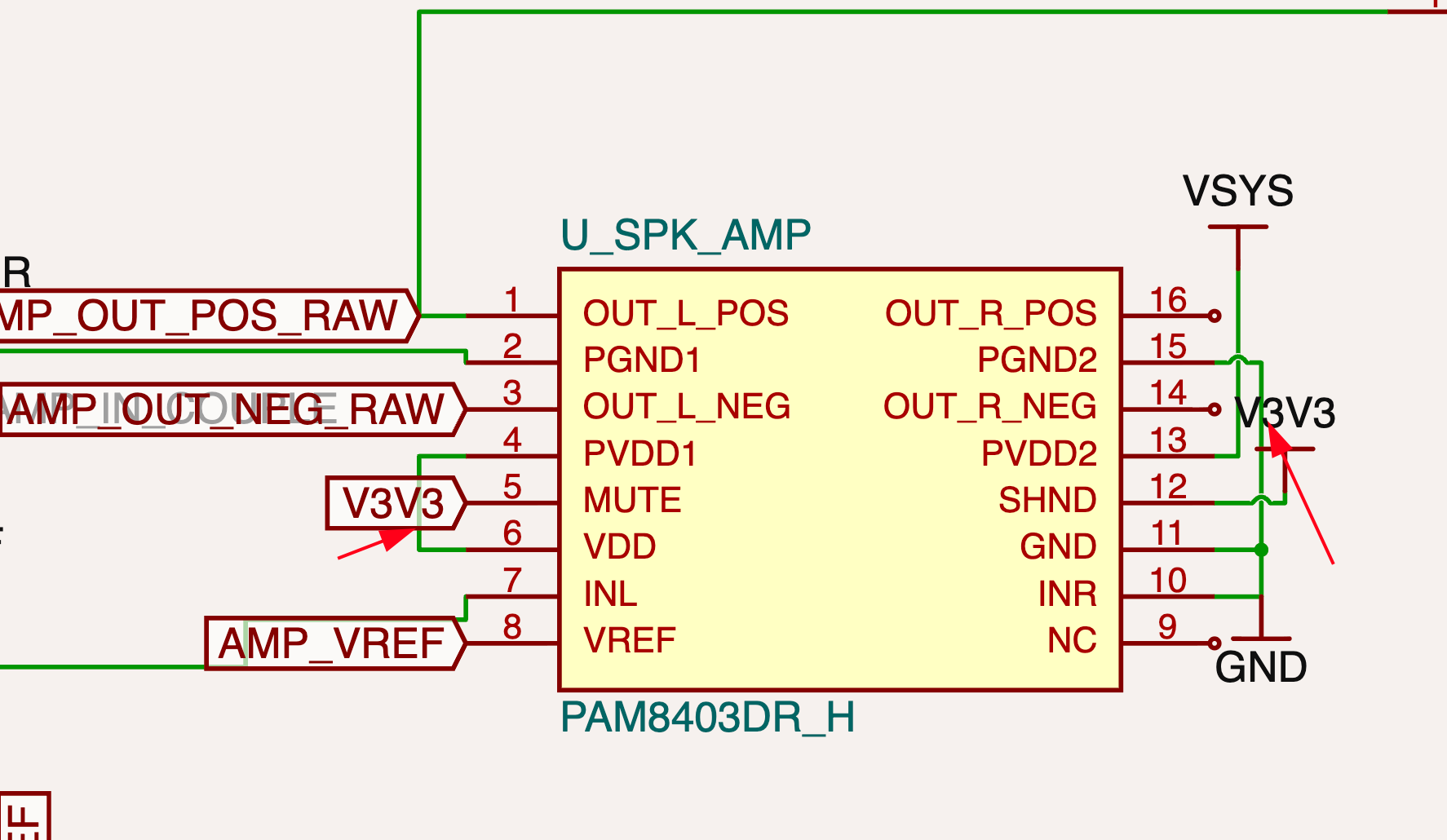

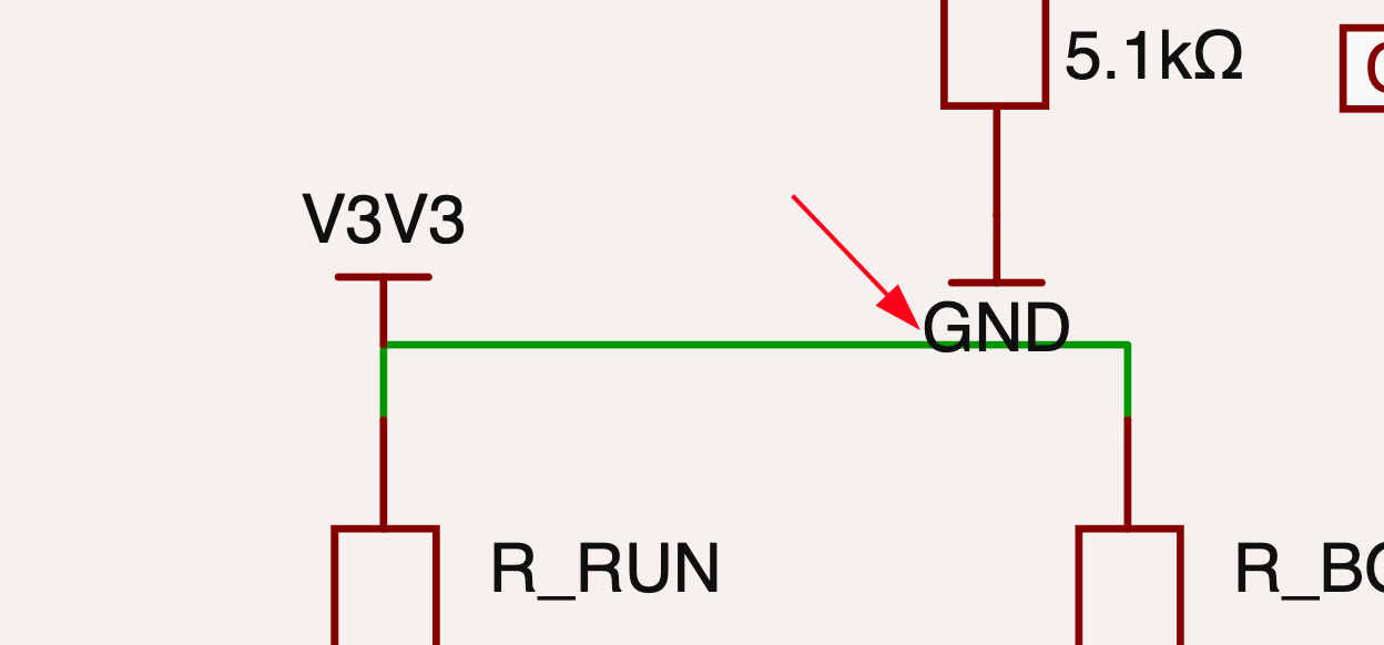

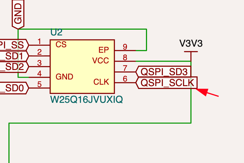

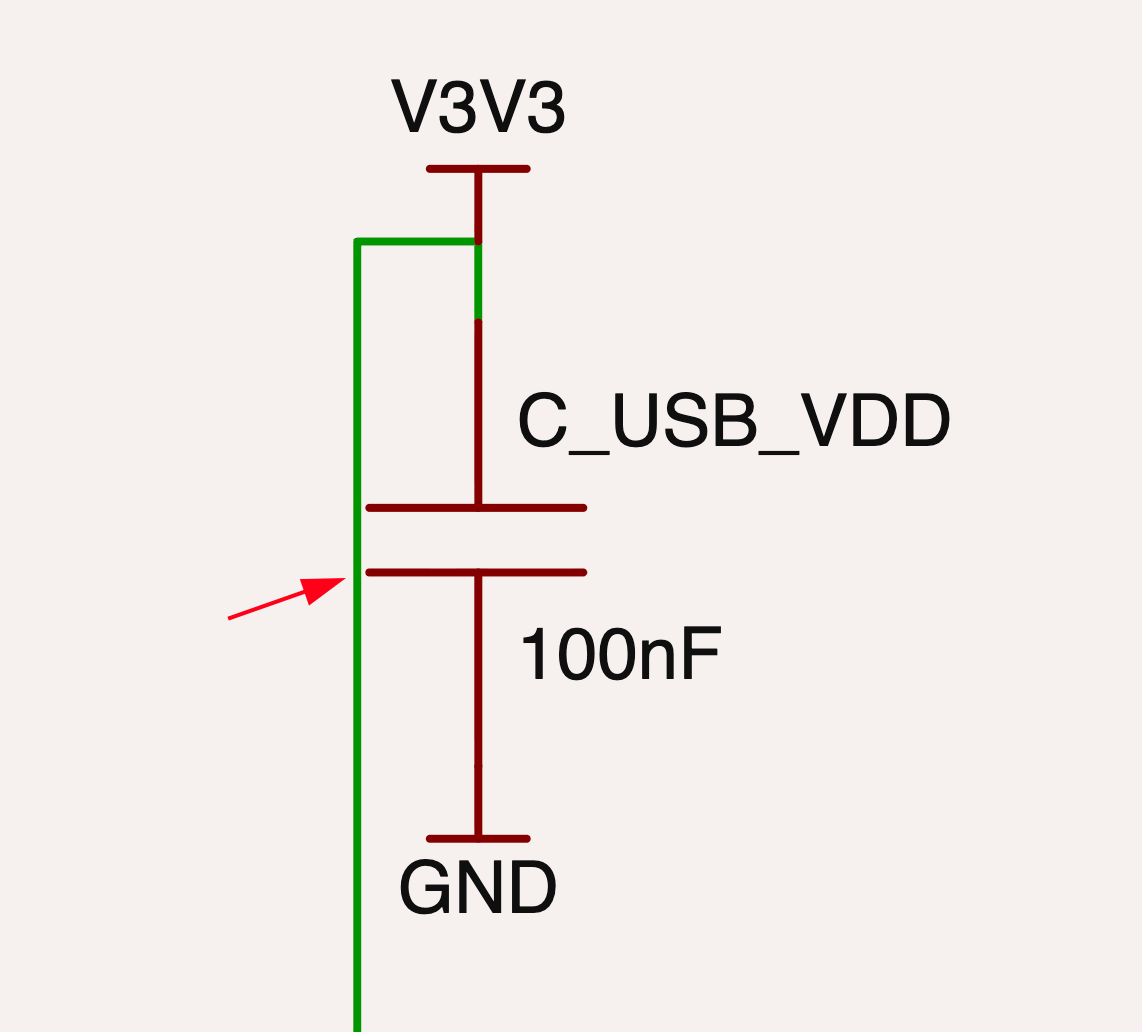

Seve - these should be fixed right now- they ma...
these should be fixed right now they make the product so bad for no reason and the fixes are simple.
Started by SeveJul 4, 202611 messages
The relevant repos for these fixes are: - tscircuit/core - tscircuit/schematic-trace-solver - tscircuit/schematic-symbols
Yea I will work on these issues.
<@757706909351411845> I’m not getting that issue when I try to add a repro for it. can you share the circuit

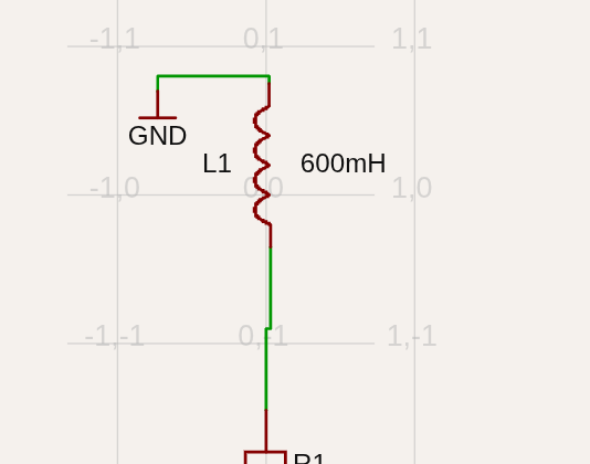

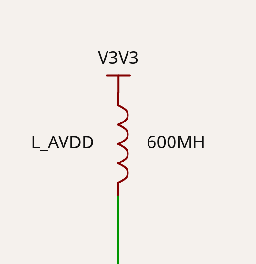

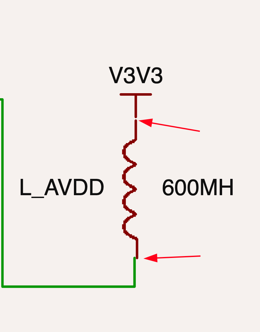

it is either Abse's pico or the gameboy. Also the inductor looks back which is a separate but important other issue
can you check it, the bug is not visible in the schematic-trace-solver snapshot https://github.com/tscircuit/schematic-trace-solver/pull/613
Yes in that case it may be a core issue in how it constructs the input for the problem
So the repro would go in core 😵‍💫
Yea I was add the repro in core yesterday
I think mustafa maybe fixed
I have fixed it, it is just dep issue
