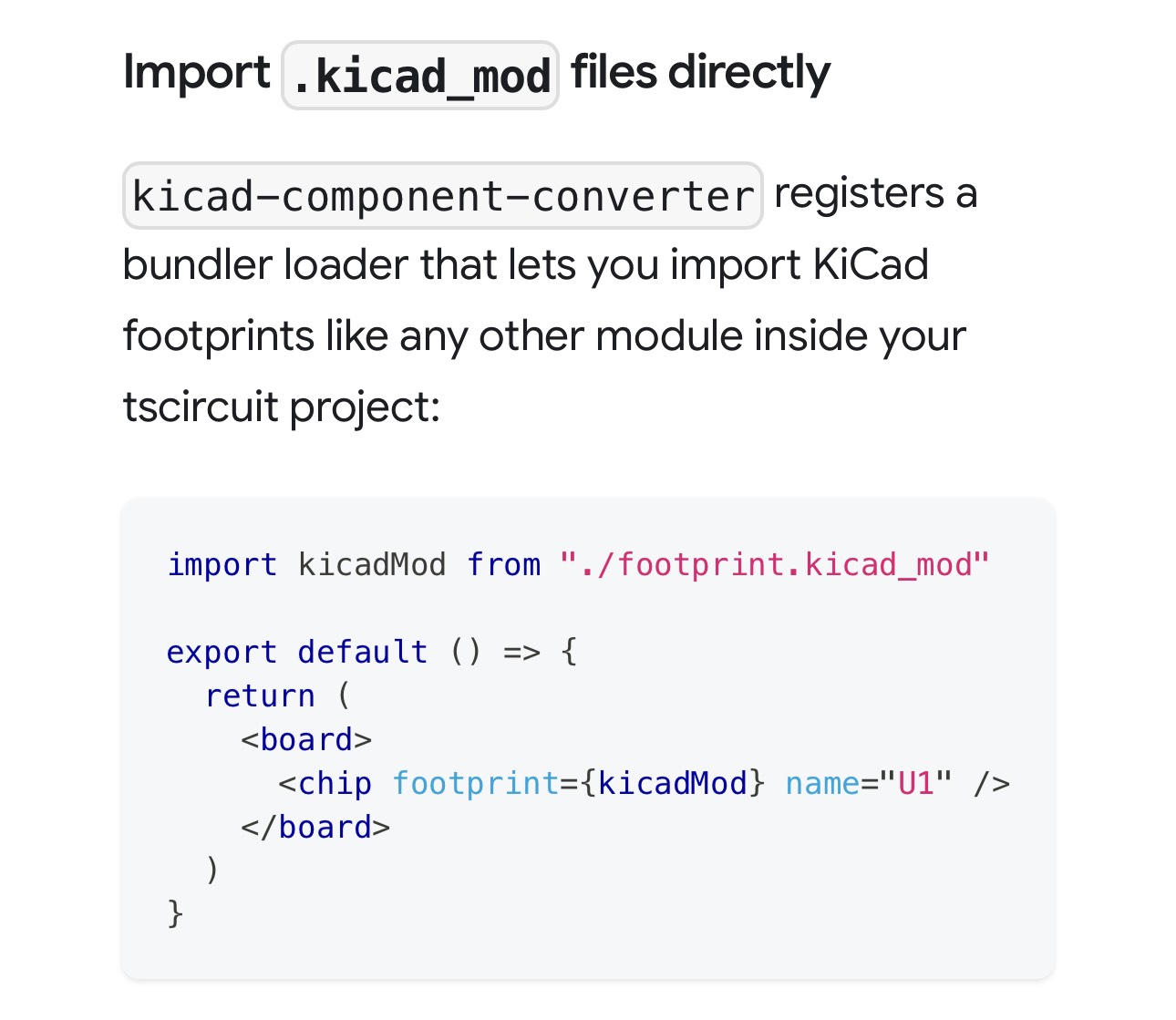

Yea probably via kicad
You can directly import kicad files and footprints

You can literally just import it
Those projects also work though

<@757706909351411845> I could successfully create tscircuit component for the pinheader. Here are few of the observations: ``` 1. Obtained the kicad library from ultralibrarian 2. Converted kicad footprint to tscircuit tsx code - First tried with `kicad-component-converter` npm package. But due to package dependency issues, dropped this approach - Then used the online tool: https://kicad-component.tscircuit.com/ - Uploaded kicad_mod file to the webpage and downloaded the .tsx component file 3. The converted code contains only footprint information. Schematic information needs to be attached separately. - molex_901303120 is a simple connector. So asked AI agent to update the molex_901303120.tsx file refering to other libraries available. - Since there are no datasheet related information required to define pin names/numbers, agent could generate necessary code in one go. - Generated component worked seamlessly with the existing circuit, in first try ``` (This is taken from my notes. Sorry for being verbose.. 🙂 )
