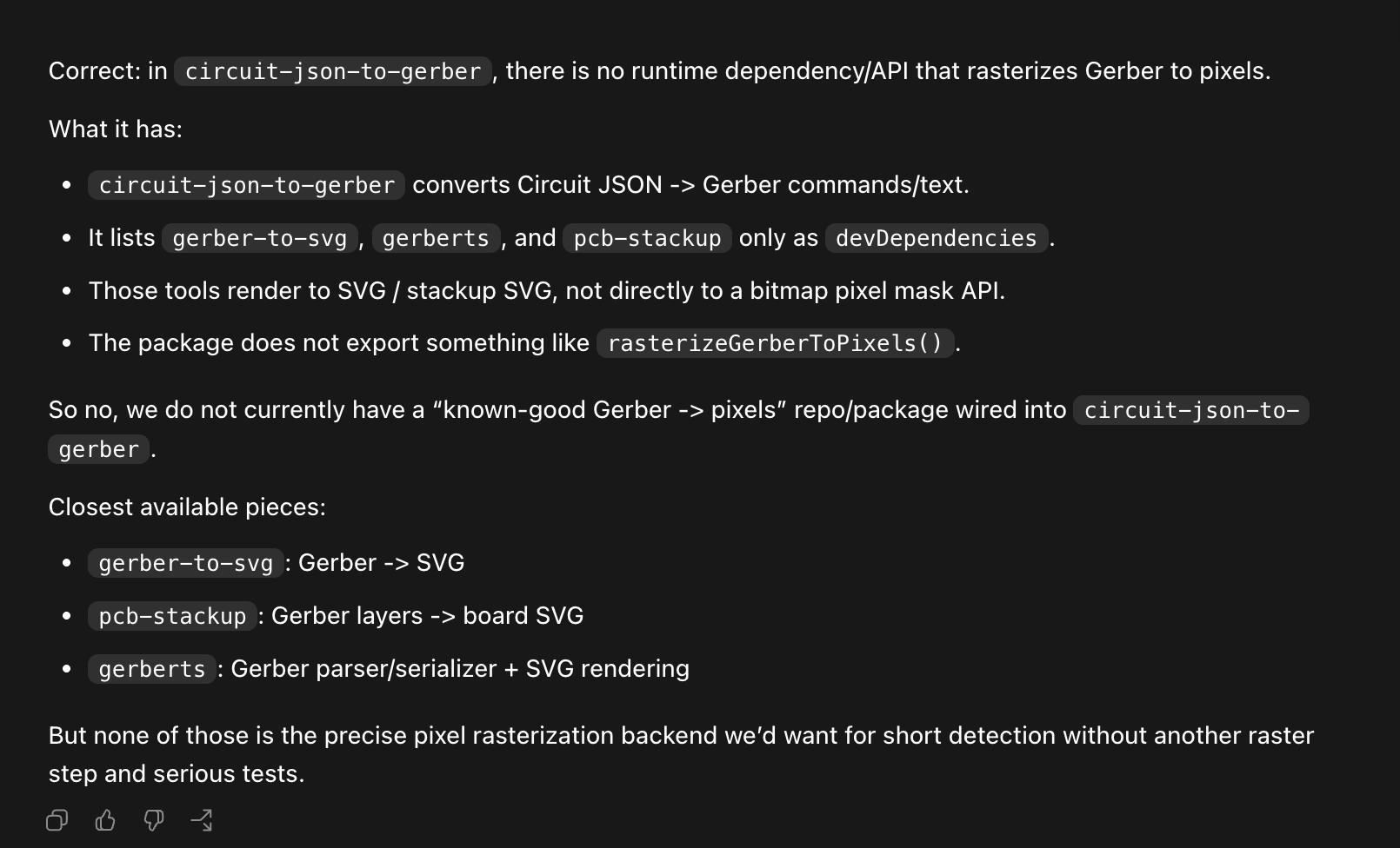

circuit json to gerber does not have gerber rasterization to pixels
Svg to png is fine
Core

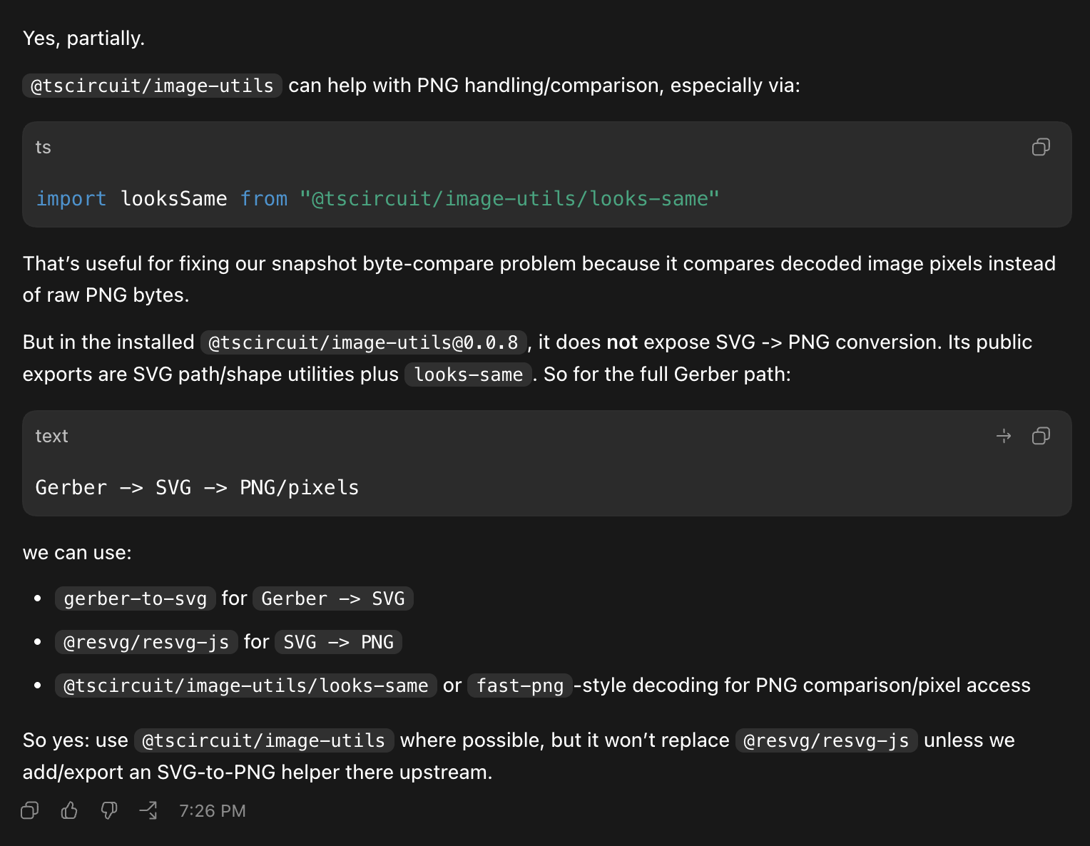

ok for the svg to png should we use @resvg/resvg-js ?
Use @tscircuit/image-utils if possible? If not yea
I think image utils handles the browser/node issues
Because you have to use wasm sometimes for it to run in browser
We should have an svg to png in image utils for sure that manages all the annoying compat issues
@tscircuit/image-utils don't do svg to png on it's own
Yea maybe expose it from image utils
ok
It might be easier to use resvg just to get things moving
we should do @tscircuit/image-utils/resvg

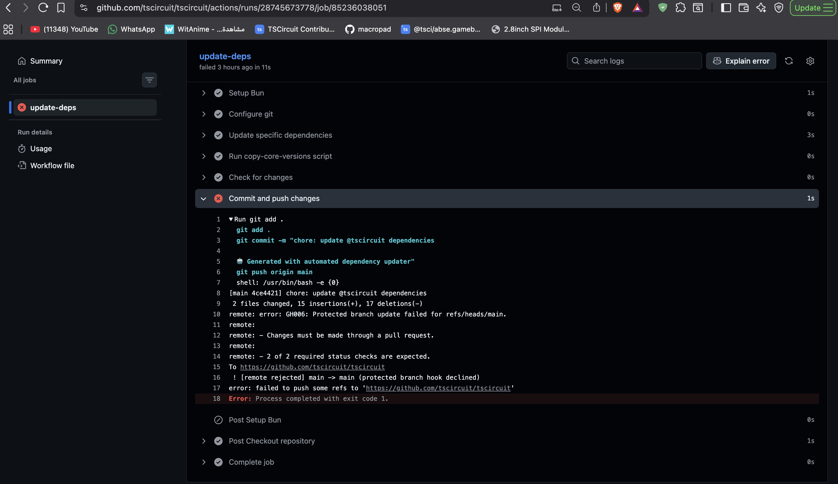

<@757706909351411845> eval is not updated in tscircuit https://github.com/tscircuit/tscircuit
hmm
i thought we were creating auto-merge prs for these changes
i just added tscircuitbot being able to bypass that rule- but this repo isn't set up like our other repos that require a pull request
CC <@809856037376491570>
