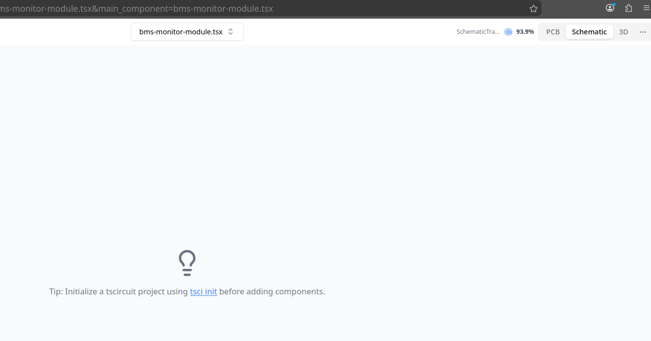

Webui is stuck at "SchematicTraceRender" I've raised a bug. Can anyone please go through it? https://api.tscircuit.com/bug reports/view?bug report id=c4a373c2 c037 4b0d b475 94c187ba4931

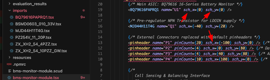

I see `sch_x` and `sch_y` were being used instead of `schX/schY`, replacing that to `schX` and `schY` fixes this issue

Thanks @Rishabh!!!, Isn't it supposed to be shown up as an error during build?
You should be seeing type errors, but your project is not configured well. Like there is no `package.json`and typecheck.
https://docs.tscircuit.com/command-line/tsci-init refer this doc on how to initialize a project
