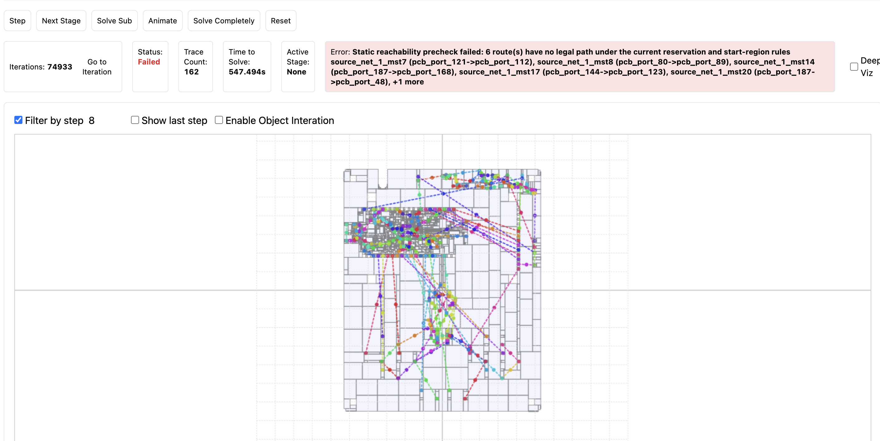

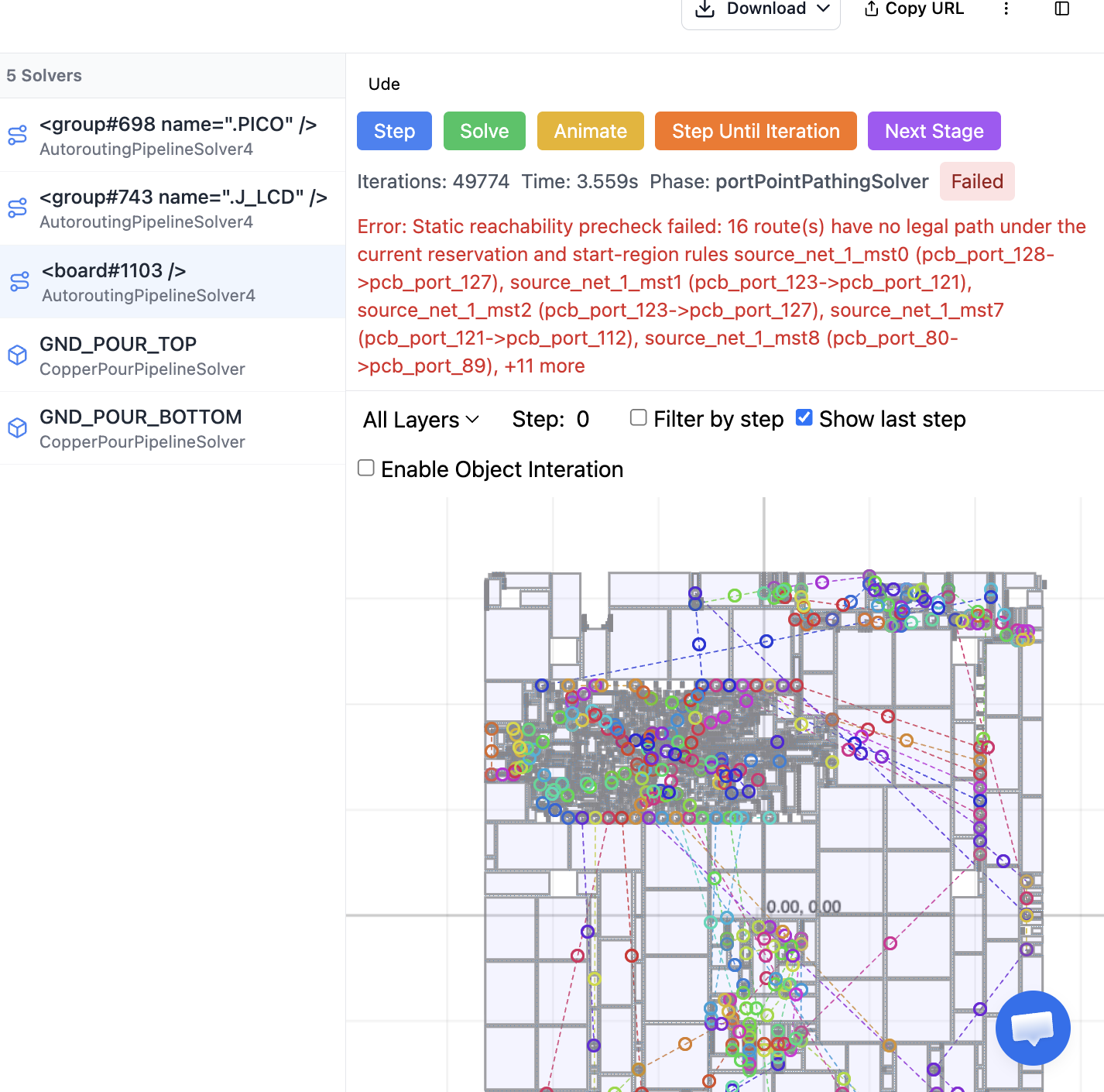

pico route but static reachability when routing the rest
https://github.com/tscircuit/tscircuit-autorouter/pull/1440 I have a PR that visualizes static reachability failures. I was planning to merge it, but the performance degraded, so I couldn’t proceed. You can just put the SRJ in the preview of this PR and see the failing problem visually. i will also try to debug this and see what i can do. but also sharing because its useful just not merged yet

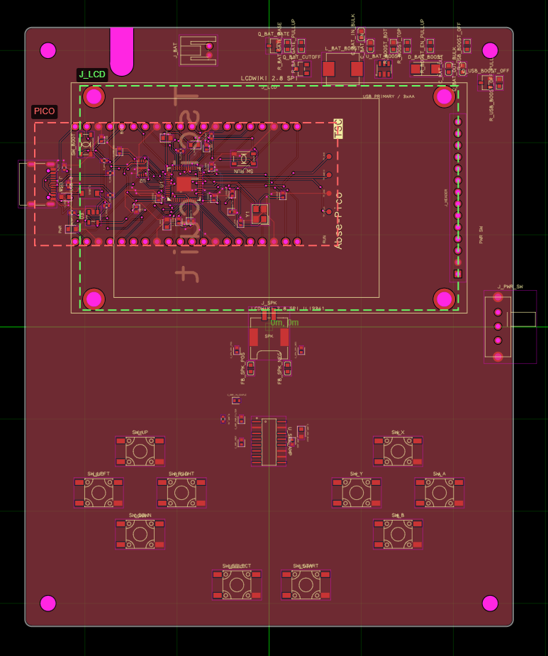

Can you move the speaker jst outside the subcircuit
I think subcircuits are sensitive to overlap-

<@757706909351411845> https://api.tscircuit.com/autorouting/bug_reports/view?autorouting_bug_report_id=5ab690a0-4f08-4d32-b671-1d0860afdd0a

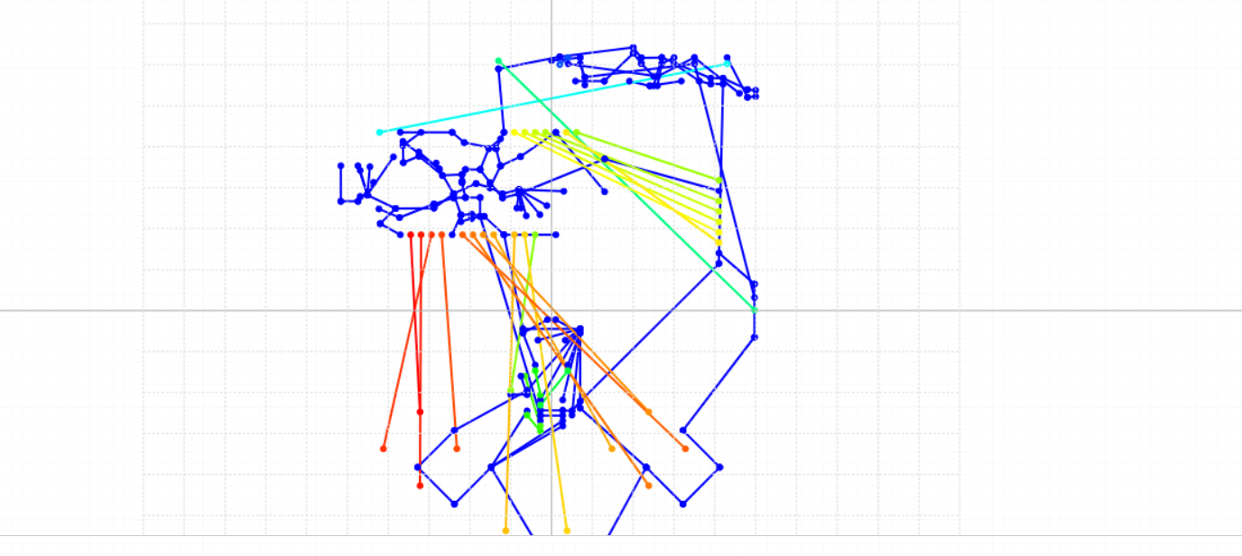

it's interesting (incorrect) that the SRJ has pointsToConnect inside the subcircuit
<@398467566588264449> can you use the Solvers tab? I suspect you downloaded the wrong bug report
one sec
then again, maybe this is actually just a core bug with how it generates SRJ 🤔
for a subcircuit- shouldn't the pointsToConnect be on the outside? Maybe not- it's a cool feature for it to not be- but it seems to overcomplicate the routing-
why now it worked before ?
I'm in the solvers tab
is there a way to bug report from here
sorry, you may be able to download from there
it looks like you probably filed the bug report properly tho

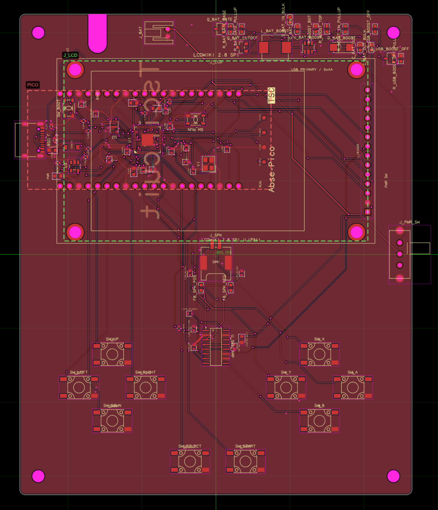

this is the gameboy!
I have the last parts we only need the autorouter to work
i have an fix but its in core; https://github.com/tscircuit/core/pull/2547/changes i am trying to understand the solution; i am not familiar with this code on this files;

<@398467566588264449> you should be aware that subcircuit routing has a bug that Rishabh reproduced- you'll want to make sure your `exposedNets` are _actually_ connecting
