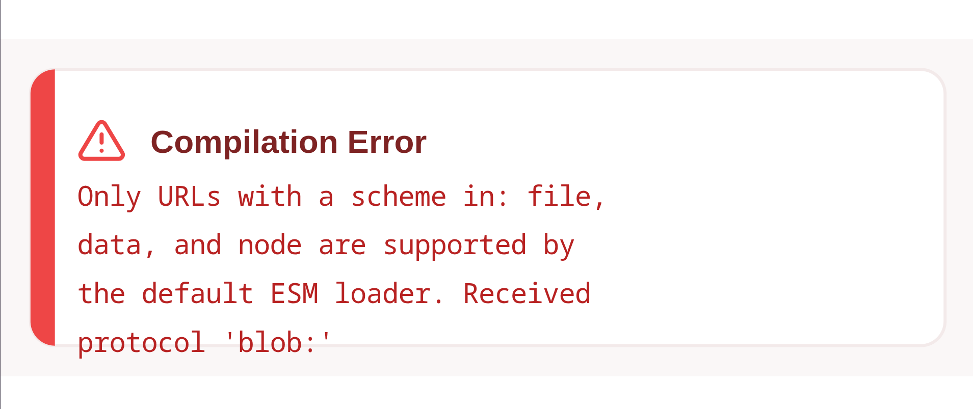

lib/import eecircuit engine.ts loads the 21 MB engine by fetching it from the CDN, wrapping the source in a Blob, and calling import(blob:…). Browsers and Bun support importing a blob: URL; Node's ESM loader does not — it throws "Only URLs with a scheme in: file, data, and node a
Started by ! Rushabh | Linux ShillJun 25, 202664 messages

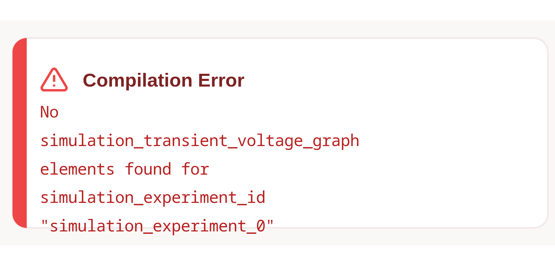

lib/import-eecircuit-engine.ts loads the 21 MB engine by fetching it from the CDN, wrapping the source in a Blob, and calling import(blob:…). Browsers and Bun support importing a blob: URL; Node's ESM loader does not — it throws "Only URLs with a scheme in: file, data, and node are supported… Received protocol 'blob:'". So any consumer that runs simulations under Node (e.g. svg.tscircuit.com's Next.js Node runtime) fails. I verified this end-to-end: with a file:// temp-file import the same circuit produces both transient graphs under Node. Therefore svg.tscircuit.com fails https://svg.tscircuit.com/?svg_type=schsim&code=H4sIAJSWPWoAA21S0WqDMBT9leBeWthau64vZQqF7mGwraPrZA%2FCSPVqA5qEmzg6xH9fok2Vrj55z8m5956T1B7jKRwnWh29pQdHKVCTFDJaFZqMxiQIySjmhDzuBcWUoKg04%2FmaKbovIA0tZcgfUWiagxIVJkA4LSGIvWgWe%2BTEmHK2iEytksNXUN%2FNGzJ1YlqWoAG7ijj16tXIHZaIQqABb7LMN19P5EjlwWwjC%2Fr71gmfv182q%2FVQyzkkmgmugrp2KCFSqCWJvUk0IyGZSMbNvNue5pC39PYa3TTd39kDgmJKC3Tbb633DqQ8scj92bzxngmhJTKuDeE%2F%2BJazrU7NNFKTYoaiNHS%2FgD2lhYXOK18IT2FLFHu4iDPafO6u5DmfLZIs%2BxeW2rVzht7dCYQMEIyn7shwlT4Td7OcFiJXrKwKai%2FA9UgrbGv7KkrV99ashHfADw3SUr5fDUglWQJPPGfc%2BuF5Ww%2BHmoHT9pWGY6%2F5A0JngCrYAgAA for ```ts <board routingDisabled> <voltagesource name="V1" voltage="15V" schX={-3} /> <ammeter name="AM1" color="#ff0000" graphDisplayName="I_LOAD" connections={{ pos: ".V1 > .pin1", neg: ".R1 > .pin1", }} /> <resistor name="R1" resistance="2" schX={3} footprint="0402" /> <trace from=".R1 > .pin2" to=".V1 > .pin2" /> <voltageprobe name="VOUT" color="#315cff" connectsTo=".R1 > .pin1" referenceTo=".V1 > .pin2" /> <analogsimulation duration="1ms" timePerStep="100us" spiceEngine="ngspice" /> </board> ``` <@778624824875941908>

found the error ``` Compilation Error Simulation failed for"simulation_experiment_0": OnlyURLs with a scheme in: file,data, and node are supported bythe default ESM loader. Receivedprotocol 'blob:' ```
- `runframe` works because browser - `cli` works because temp-file import
ok so basically we don't work it NODE right now, we work in browser and bun is that right?

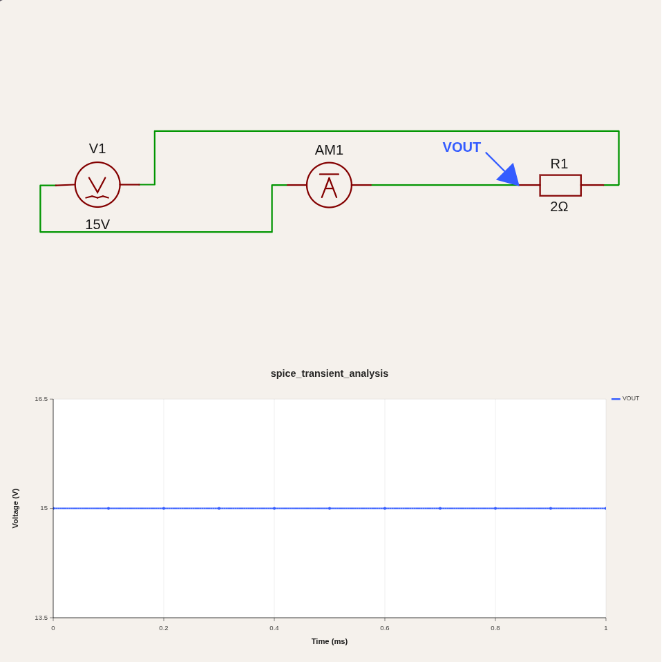

This is for the curent pr: https://svg-tscircuit-jvr3rmmex-tscircuit.vercel.app/ This is the live deployment link for previous pr: https://svg-tscircuit-1crdasmao-tscircuit.vercel.app/ I tested ```ts <board routingDisabled> <voltagesource name="V1" voltage="15V" schX={-3} /> <ammeter name="AM1" color="#ff0000" graphDisplayName="I_LOAD" connections={{ pos: ".V1 > .pin1", neg: ".R1 > .pin1", }} /> <resistor name="R1" resistance="2" schX={3} footprint="0402" /> <trace from=".R1 > .pin2" to=".V1 > .pin2" /> <voltageprobe name="VOUT" color="#315cff" connectsTo=".R1 > .pin1" referenceTo=".V1 > .pin2" /> <analogsimulation duration="1ms" timePerStep="100us" spiceEngine="ngspice" /> </board> ```

Yes, Its is not working for svg.tscircuit.com , but it works in https://svg-tscircuit-2mm13se43-tscircuit.vercel.app/ hey <@809856037376491570> is there any difference of environment between these two links in vercel

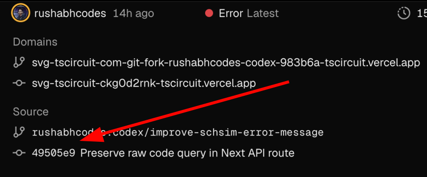

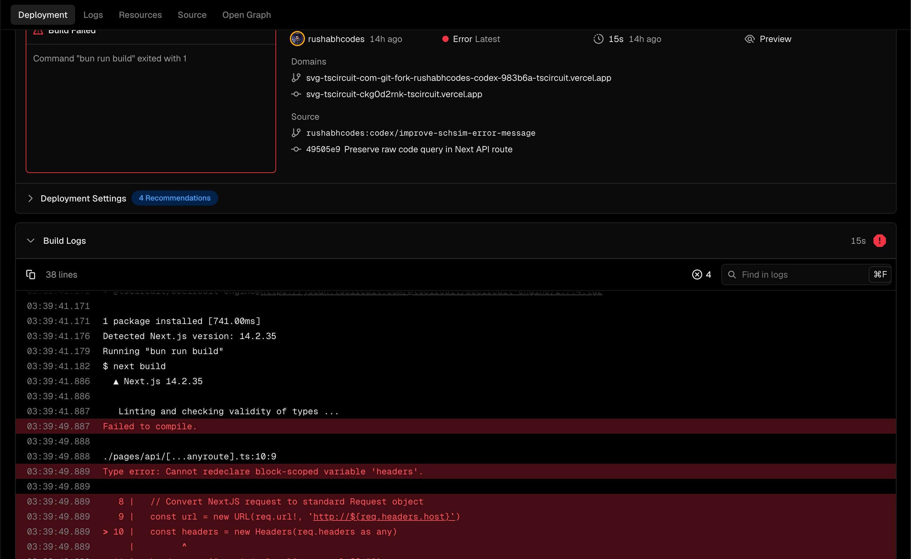

The last deployment has failed, run `build` locally to figure out

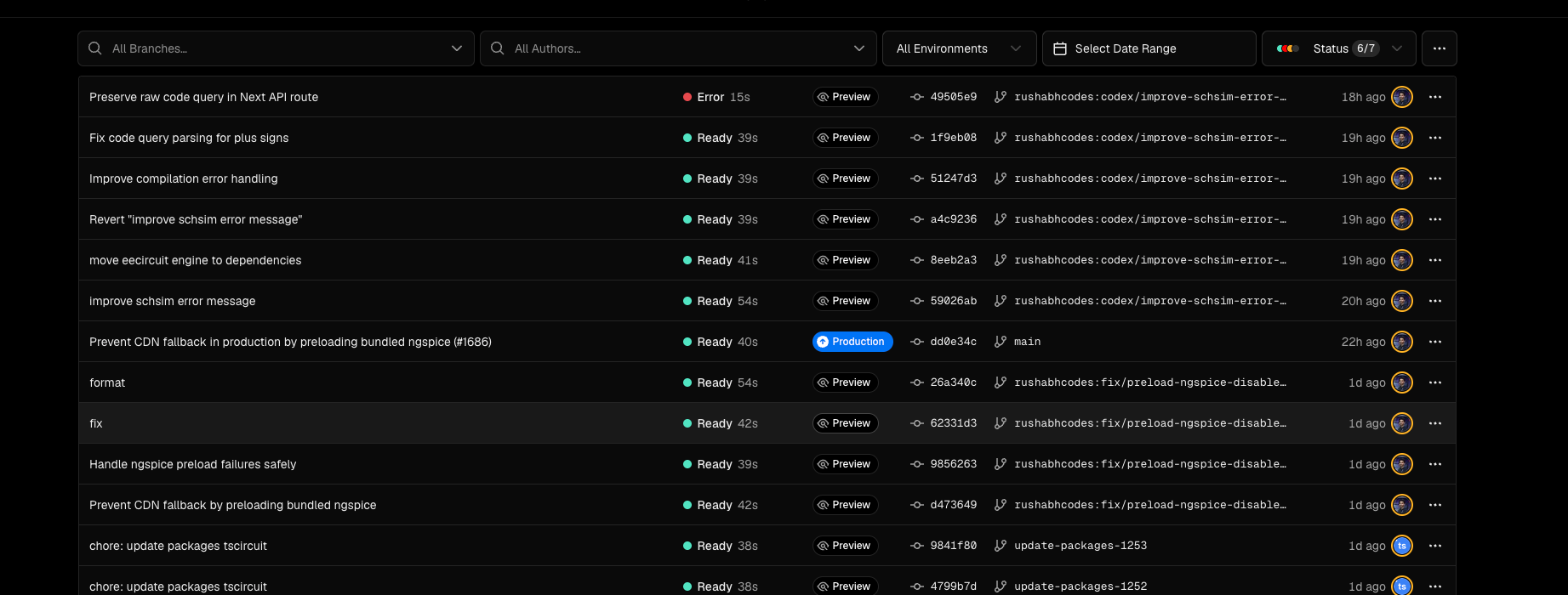

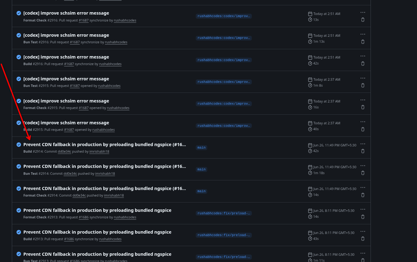

<@452450065941004289> what is this commit?
it's not the latest
check this dd0e34c
https://github.com/tscircuit/svg.tscircuit.com/actions/runs/28257068828
this is newer commit on my test branch
the thing is that main builds locally, why does it not build in vercel? maybe it does actually build if the snapshot sent by <@809856037376491570> is not from main
that one is not from main
it also fails locally , its just something i was testing locally, the build started cause i created a pr as i wanted to know how it behaves in prod
<@809856037376491570> needs to see the latest build on main branch

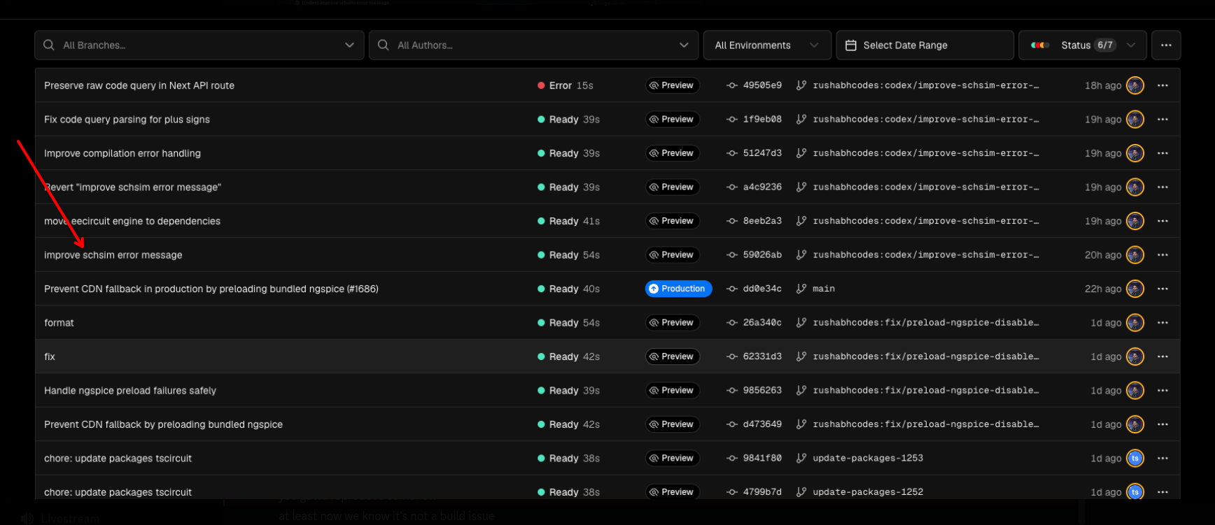

what's happening here
Ohh I sent the wrong one?
yeah, I sent the preview deployment which failed. the main is passing
but sch sim is not working for svg.tscircuit.com , but it works in https://svg-tscircuit-2mm13se43-tscircuit.vercel.app/

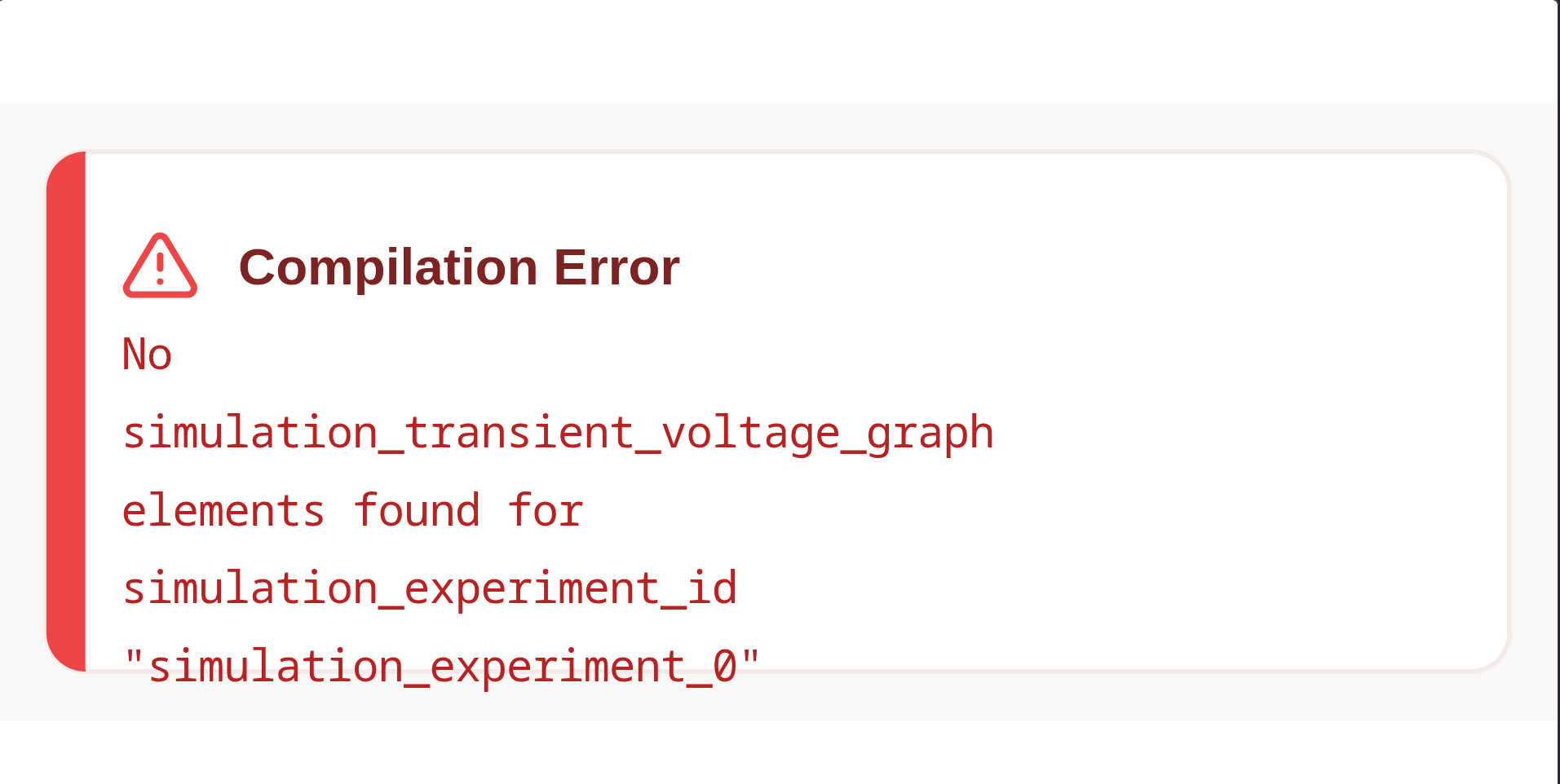

we need to improve the error mesage so we can understand the problem better
you got a PR?
yeah, on it
So here is what i found I added better errros https://github.com/tscircuit/svg.tscircuit.com/pull/1688 live link i got for my pr (works perfectly fine): https://svg-tscircuit-6ty0d4oh2-tscircuit.vercel.app/ my vercel deployment of the same branch (errors): https://svg-tscircuit-pxjw8v8l2-rushabh1134s-projects.vercel.app/
<@809856037376491570> any idea why this might occur

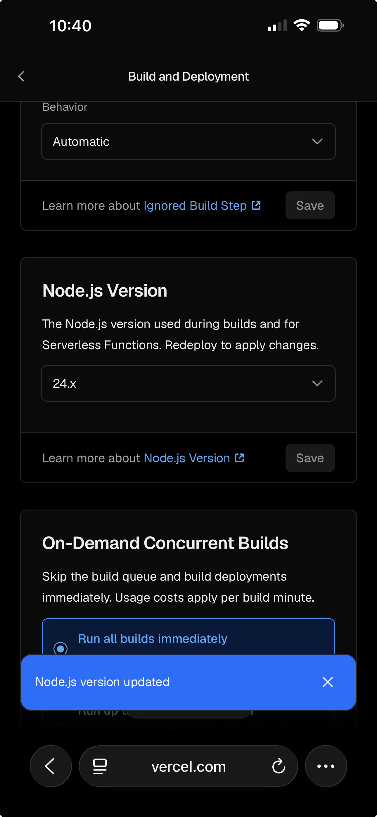

Try redeploy? Upgraded node to 24
i am already using node 24.x in my deployment
I updated the svg tscircuit com setting- that is the point
Now it matches your version, but needs an update to redeploy
