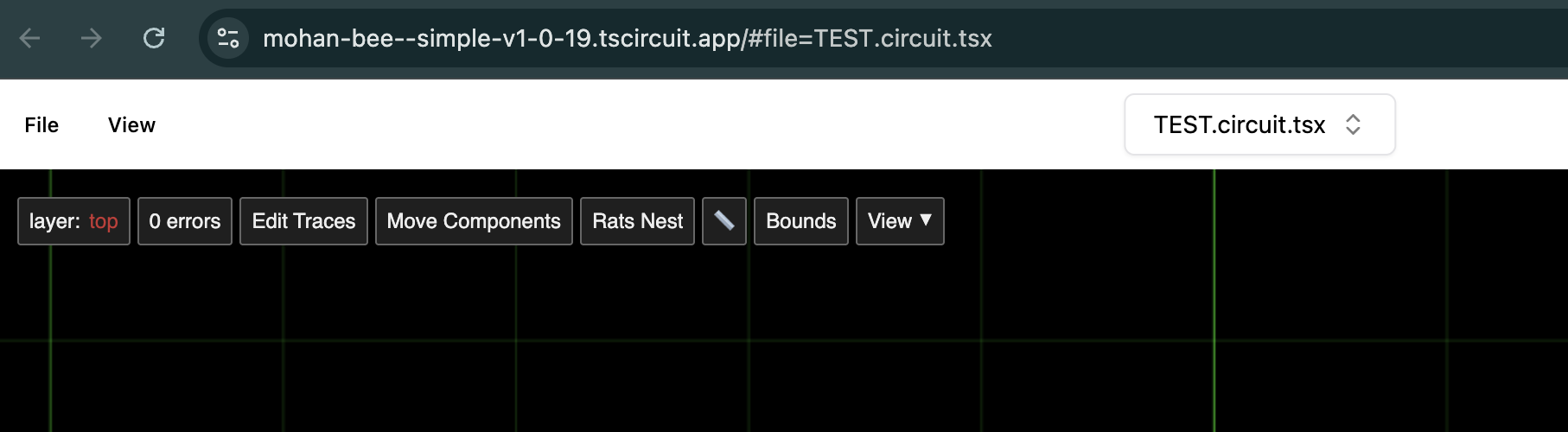

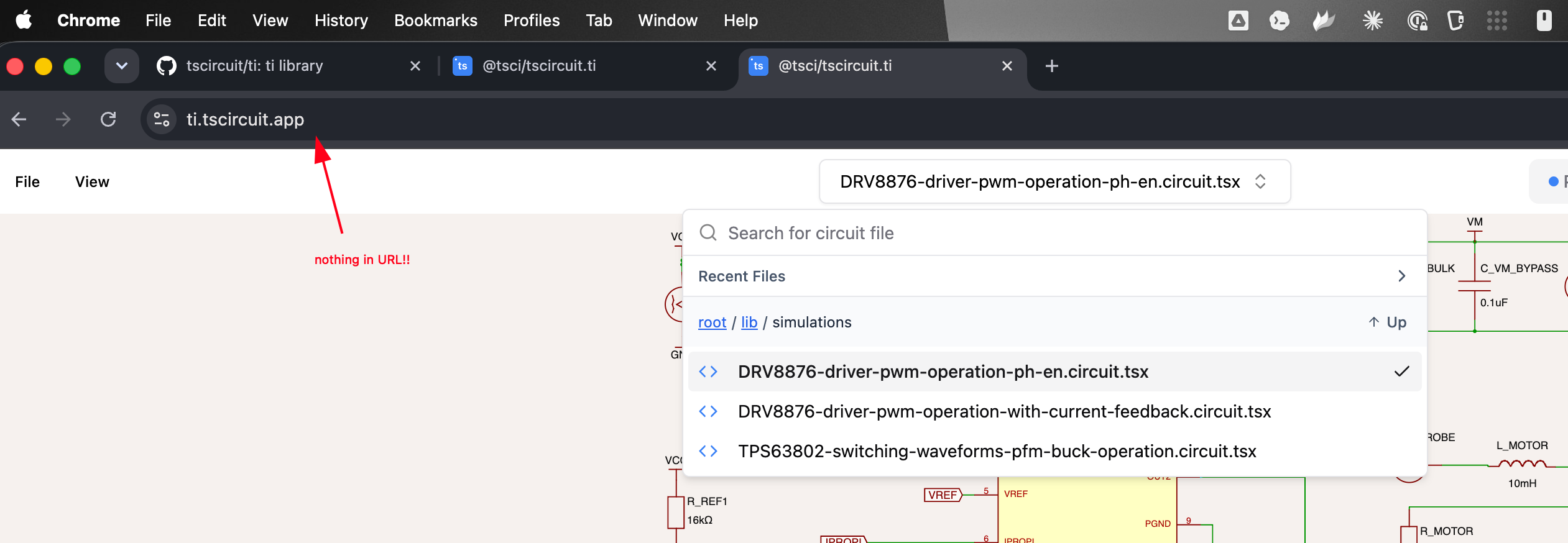

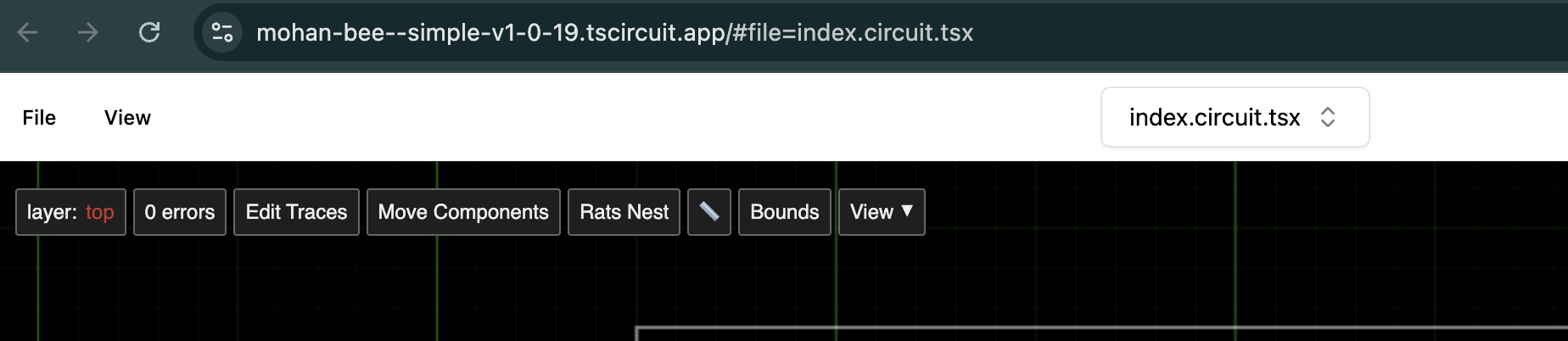

Seve - runframe bug!!!! I can't link to a circu...
runframe bug!!!! I can't link to a circuit!!! CC mention mention
Started by SeveJun 25, 20269 messages
runframe bug!!!! I can't link to a circuit!!! CC <@809856037376491570> <@452450065941004289>
or is this tscircuit cli static directory????
i think it's runframe + static generation?
yep this is a runframe + static-viewer issue , cli uses RunFrameWithApi which reads the hash params but RunFrameStaticBuildViewer ignores those hash params. maybe this is causing the issue !
yeah i was just looking into it
maybe you can take a look at this : https://github.com/tscircuit/runframe/pull/3793
