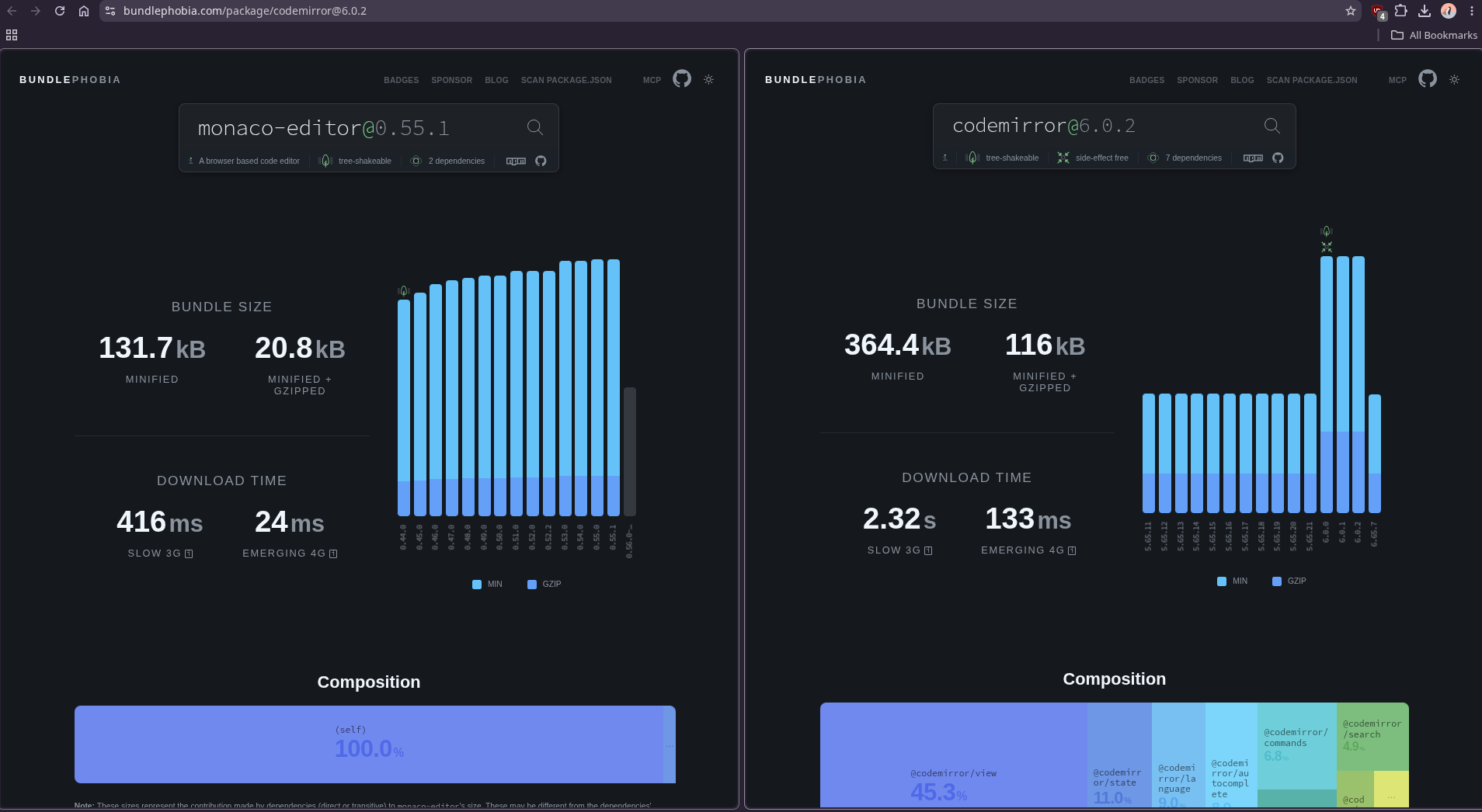

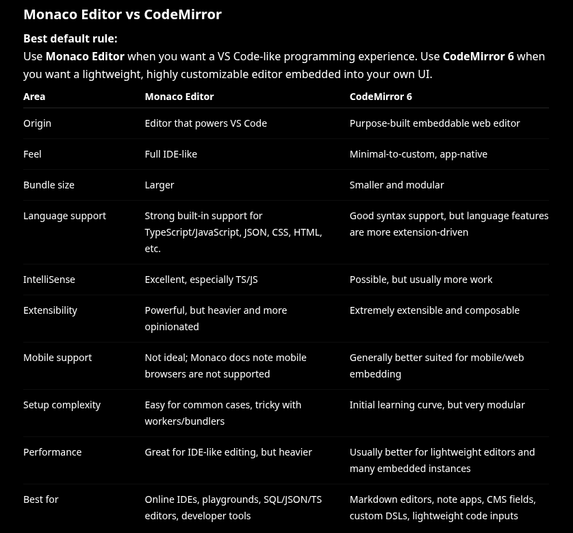

what should the new CodeEditor package include at minimum?
i would use your best judgement haha
but ideally it is lightweight, fast, has autocomplete for typescript, type checking, and can load tscircuit's types
it doesn't need to run tscircuit code however
the actual bundle size matters
then code mirror is better.
Arnav's attempt used Monaco
https://github.com/tscircuit/create-repo/pull/1
no that's not what i mean
what is the ACTUAL bundle size
this comparison is meaningless without knowing what the ACTUAL bundle size is
Monaco otherwise seems like a much better option
also the repo name you proposed is already taken
i'm not super opinionated on this but Monaco is probably easier because CodeMirror tsx support was difficult
that isn't meaningful
because monaco isn't the right size
typescript alone is like 20mb
it's fine... i'd rather see the experiment with monaco
so just try that
tsx with codemirror was not easy to implement
it's not worth that struggle again
