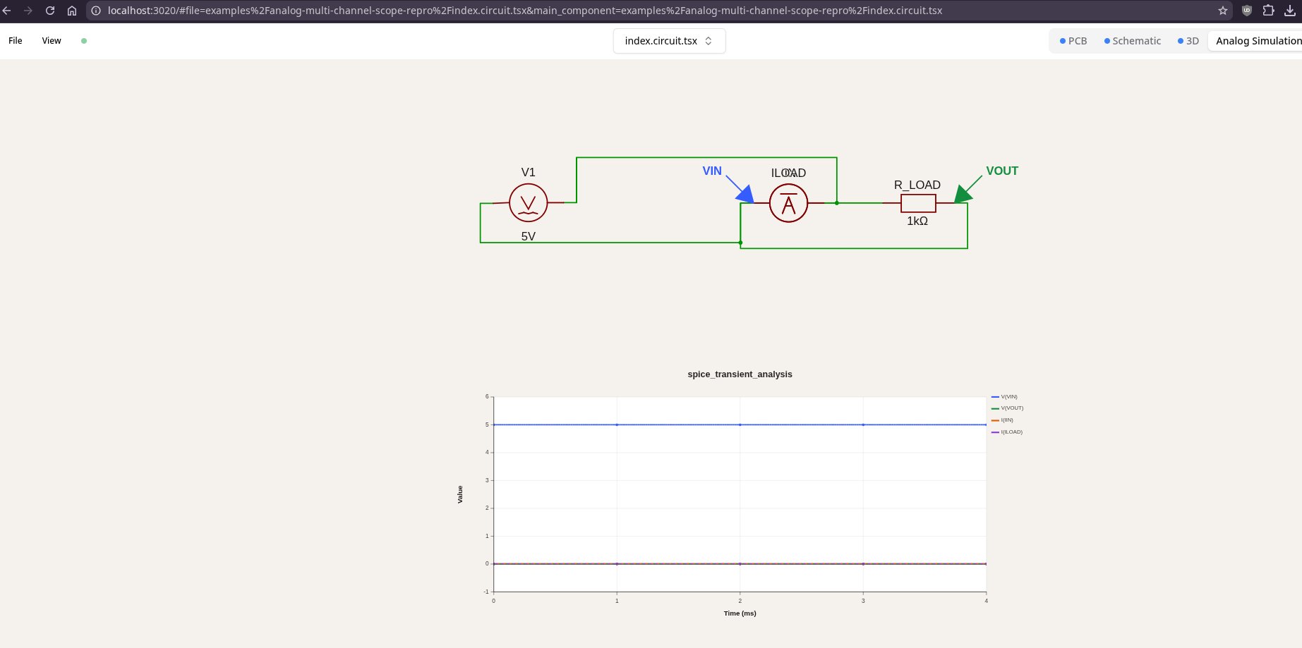

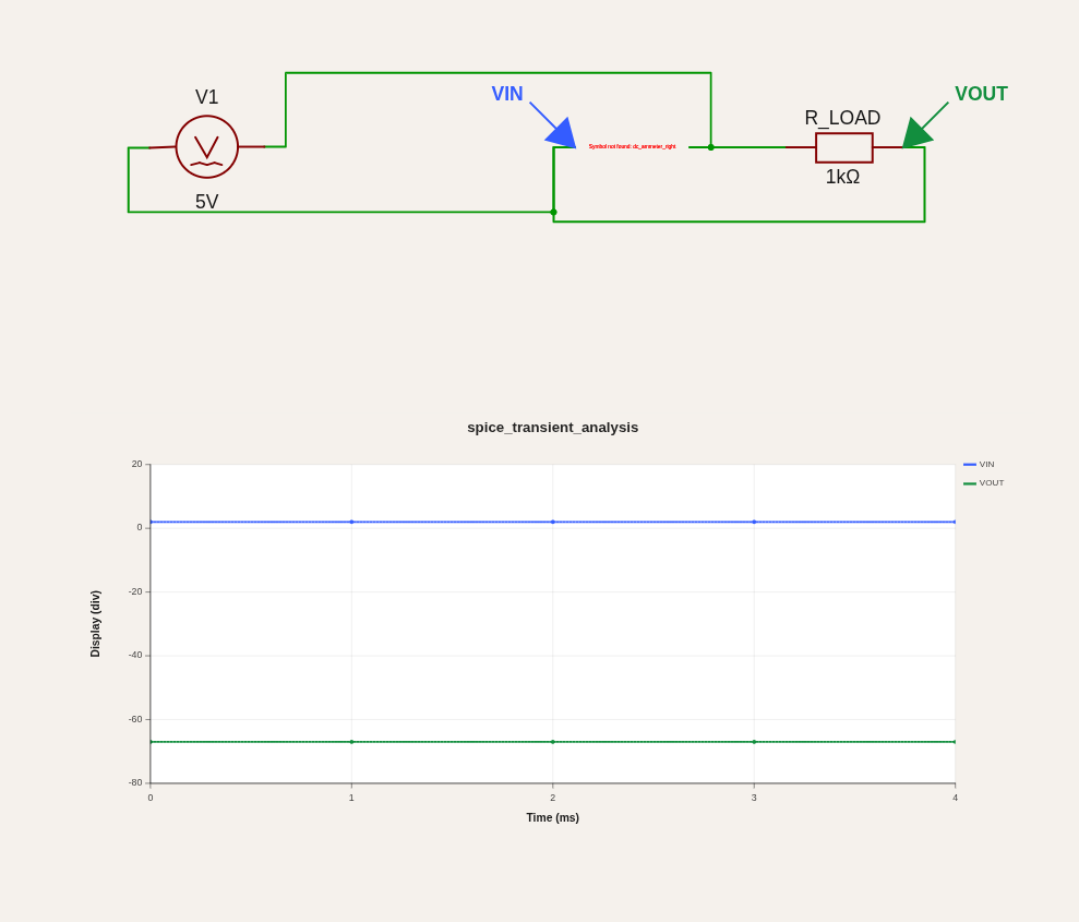

there is another issue
this is cli snapshot command
runframe is using an old version of circuit-to-svg or circuit-json-to-spice or something
can you please investigatej

<@452450065941004289> still not working

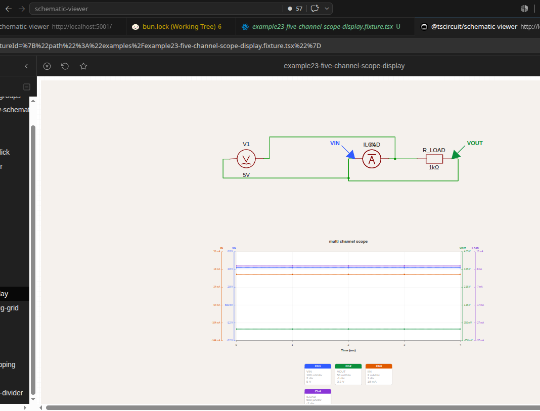

i created a exampe in schematic-viewer and it worked their, must be another issue in runframe too
Yeah repro in cli dev server then runframe
<@452450065941004289> https://github.com/tscircuit/schematic-viewer/pull/234

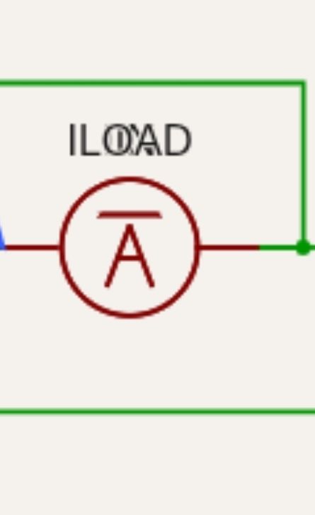

delete your node modules or something, i don't have that ammeter issue

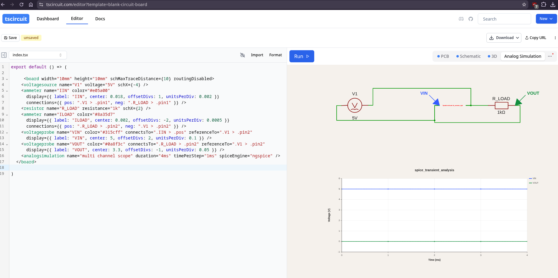

the symbo issus is also present in tscircuit.com

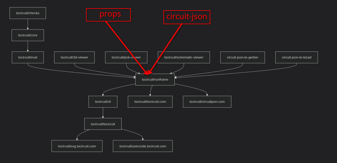

`circuit-json` and `props` were outdated 🤦
<@778624824875941908>
Why are they not peer deps?
This is a separate issue you could fix
Remove those two from deps, so we take them from the tscircuit dep. Then show the pr to seve
Because im kot sure if thats desirable

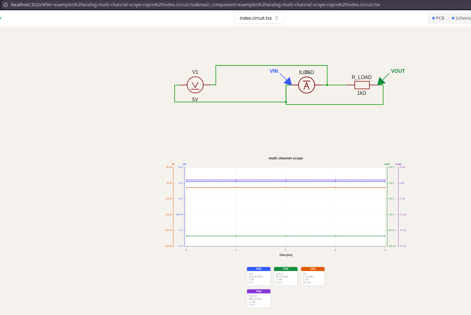

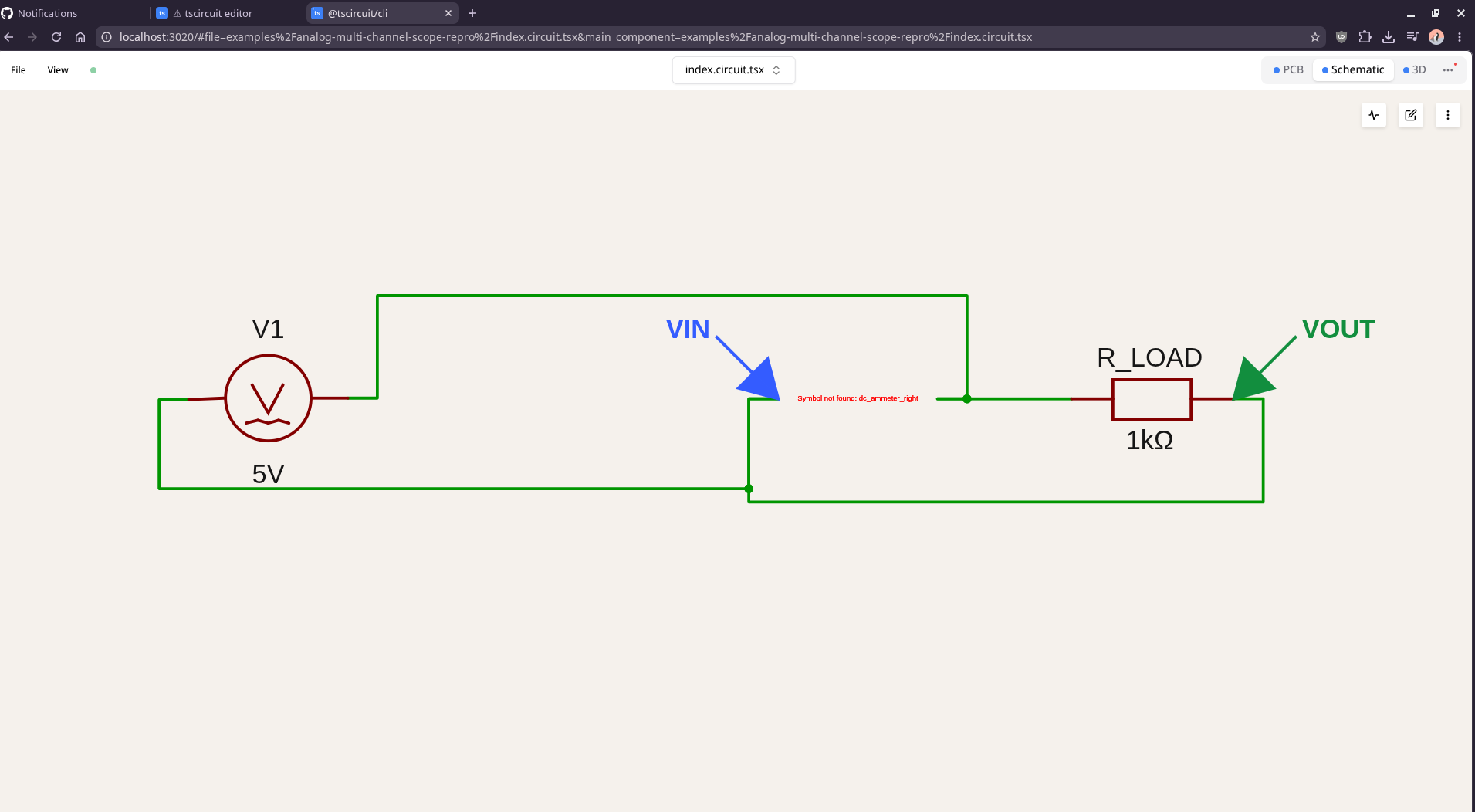

<@452450065941004289> still not working in the latest tscircuit version using the tsci dev server
hmm
can you create a different kind of repro? a playwright test that uses the tsci dev command
actually the repro you did is not accurate
you need to be using the bundled runframe version cli uses in the dev server
it is working in tsci dev
maybe I have a stale cache
yeah

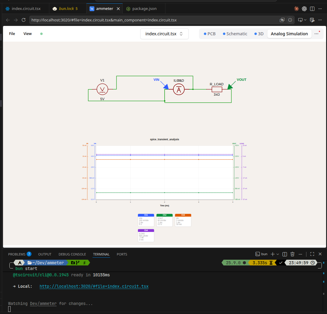

<@452450065941004289> it worked in a different browser 🎉
cache issue

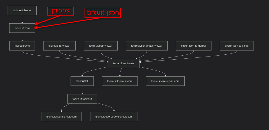

so now we gotta make sure this doesn't happen again
this may be a solution
adding them in peer dep
will that work??
why cant we do something like this
or to runframe
so we can use them as peer dep downstream
It has to be to core not runframe
The doc with the flowchart should be updated prior to the implementation pr
