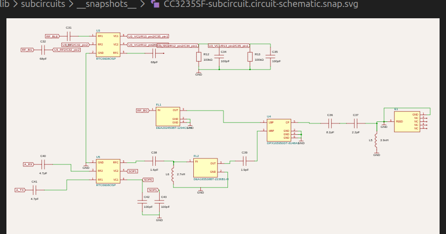

techmannih - @Mustafa7 thats schematic looks wr...
mention i think thats schematic looks wrong for your CC3235SF subcircuit, i am not find any chip for that subcircuit

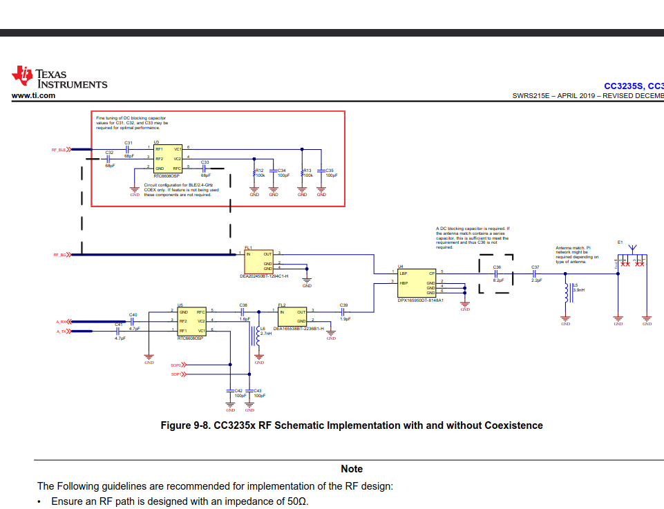

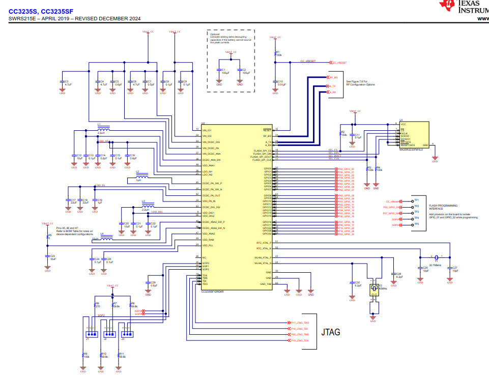

https://www.ti.com/lit/ds/symlink/cc3235sf.pdf?ts=1782301222818&ref_url=https%253A%252F%252Fwww.ti.com%252Fproduct%252FCC3235SF
I followed the schematic from the references which sangit sent me
yea might be that was wrong, i am not find any chip in that subcircuit
<@1079361271687807026> , could you fix the schematic first? Then I'll move on to the footprint. Otherwise, I think the footprint work should be blocked until the schematic is resolved.
Yea lets confirm first if its the correct layout or not
Yes <@809856037376491570> <@436098556974333952> can you confirm that would be helpful for us
Yes, if the chip is `CC3235S` then the subcircuit should be the one using that
<@1067854999889137715> I'll fix it by tomorrow and let you know
Yea sure that would be helpful for me
<@1067854999889137715> I fixed the schematic(still if you see some small issues here and there please fix it) and its merged just now. So you can now work on the pcb side
