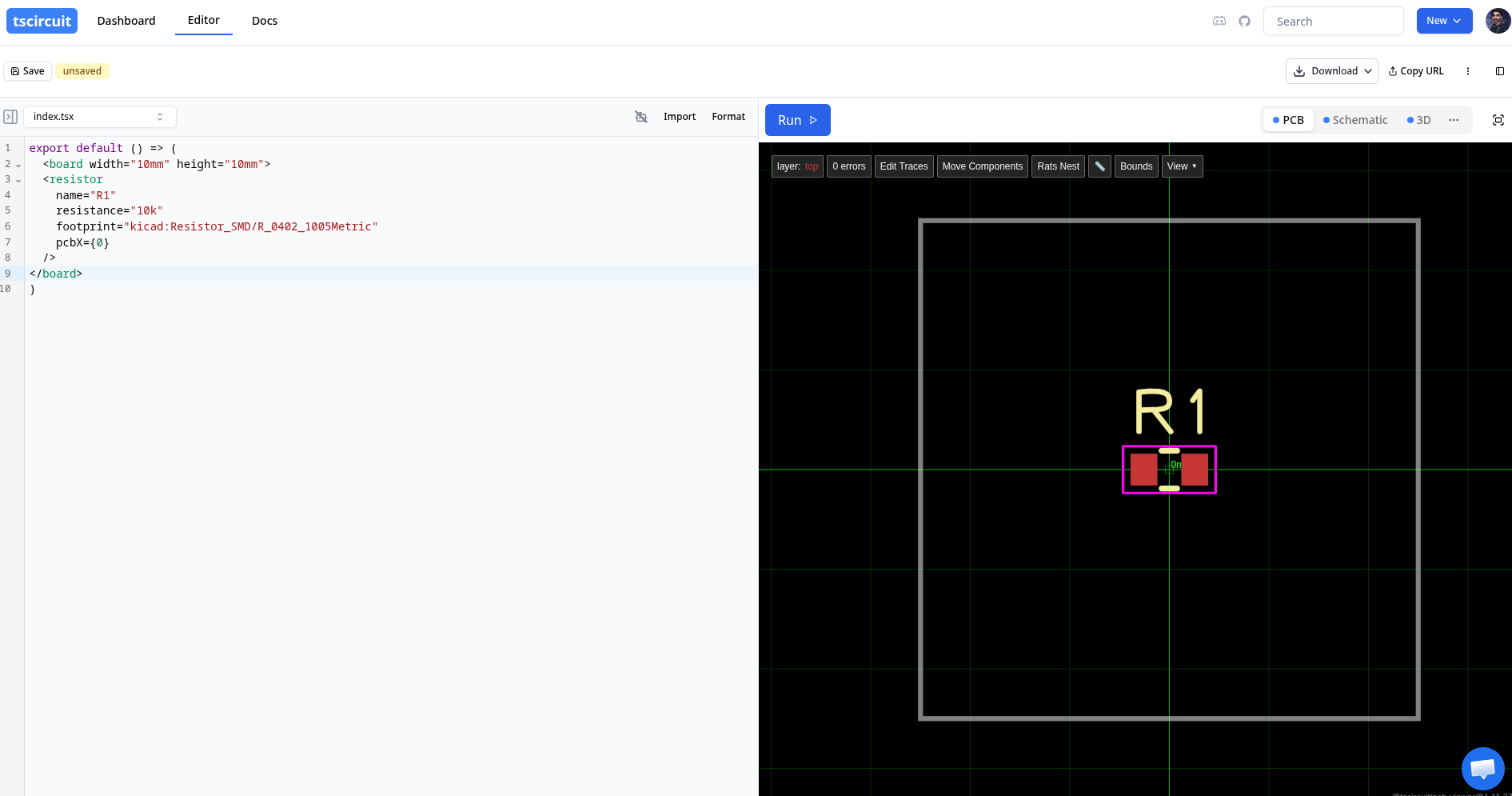

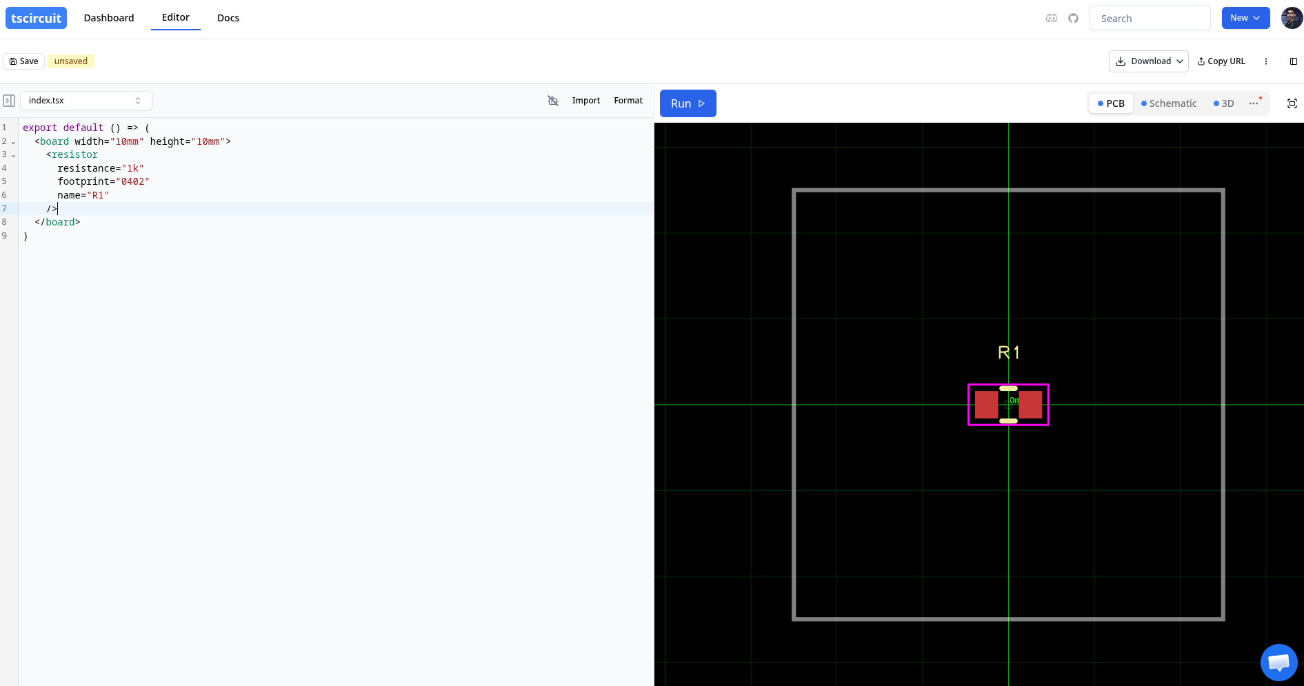

Why are text too big for footprint from kicad

the kicad to circuit jons is scaling the text and we were using the legacy (archived) kicad component converter ( tech debt )

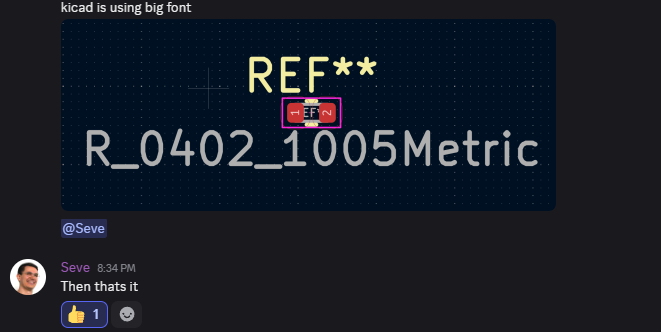

big font is right
Ohh means there is no bug
