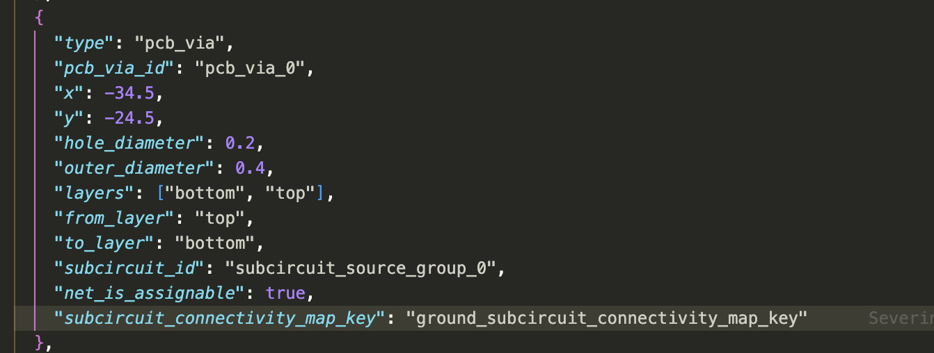

<@757706909351411845> the snapshot change is a fix
Those vias are connected to gnd as far as I knwo
they look like unassigned vias
i would double check
that board is a viagrid/assignable via style board iirc
