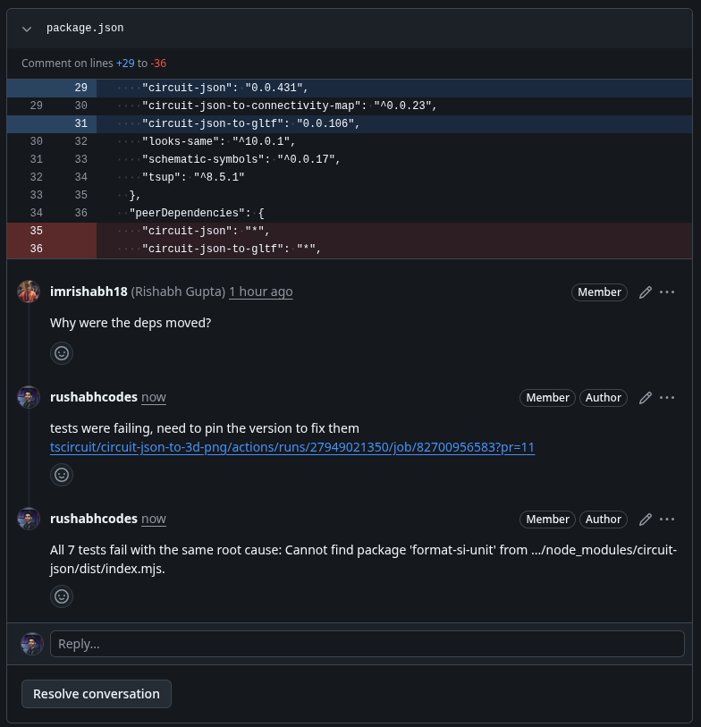

https://github.com/tscircuit/circuit json to 3d png/pull/11
Started by ! Rushabh | Linux ShillJun 22, 20269 messages
https://github.com/tscircuit/circuit-json-to-3d-png/pull/11

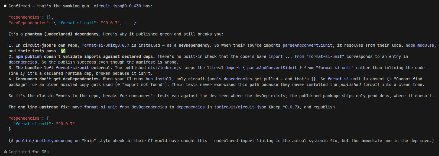

All 7 tests fail with the same root cause: Cannot find package 'format-si-unit' from .../node_modules/circuit-json/dist/index.mjs.

But that shouldn't be the reason to move the deps, right?
should we add format-si-unit in circuit-json or here

I guess you can add the `format-si-unit` pkg
