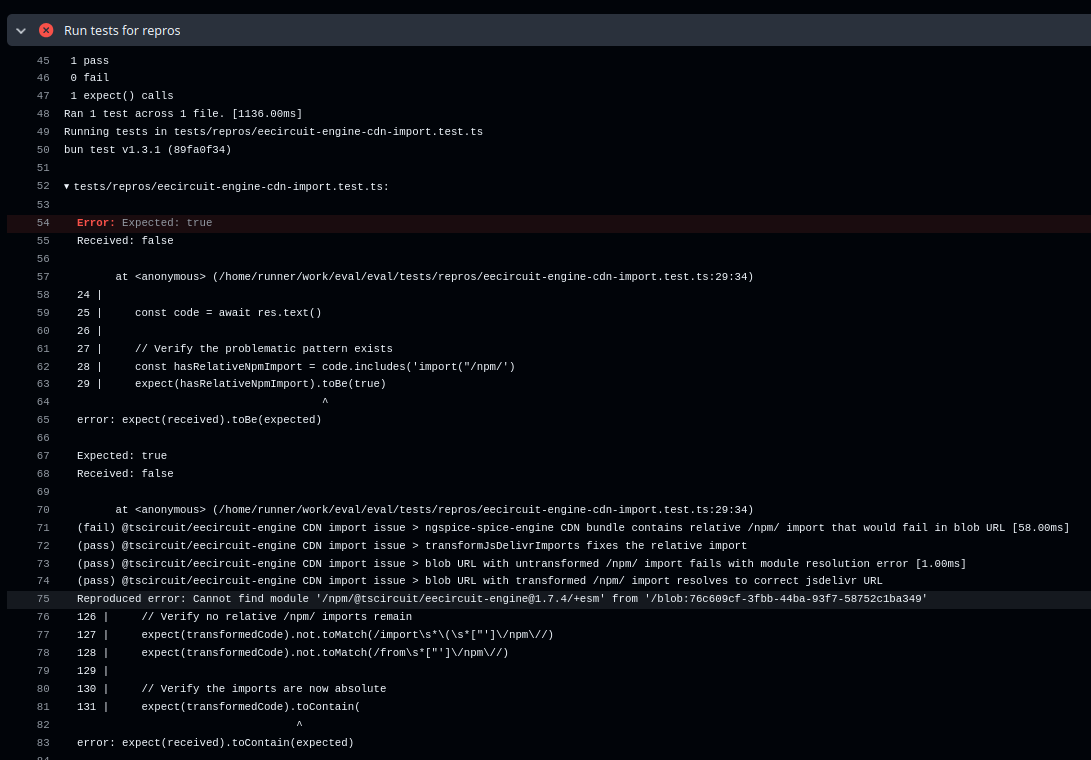

can you please investigate? it worked after my pr
Yes i am looking into it
<@778624824875941908> this repro test was relying on a live CDN response and assuming the older /npm/... import shape. The CDN now returns an absolute jscdn URL instead, so the test had gone stale,
we can fix it by replacing the live fetch with a deterministic fixture while keeping the assertions focused on the actual transform behavior.
