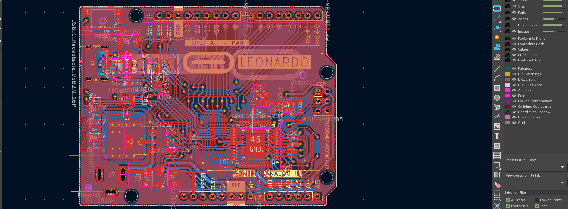

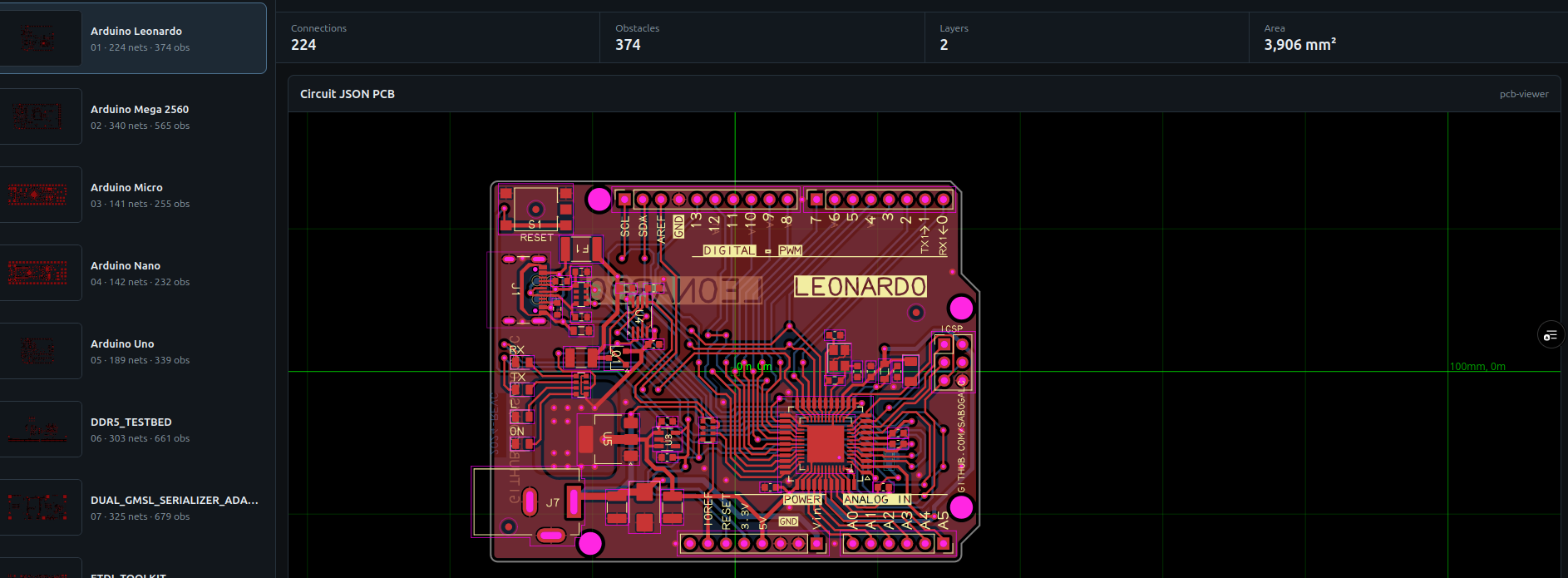

I just need u to check that the boards are matching kicad vewiers for raw kicad_pcb file
Anas
pick 2 random boards and check
yes they will looks same in both from now

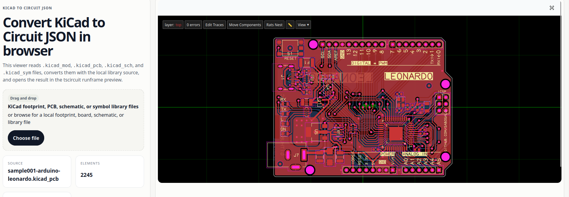

<@756504518417711104> if you want that our kicad viewer should be match with the kicad_pcb viewer, for that we need to start supporting in the kicad-to-circuit-json, i notice lot of thing missing in our kicad-to-circuit-json
otherwise all the via looks same in kicad_pcb viewer
Anas
i think makeing the viewer side by side very helpfull idea to find issues

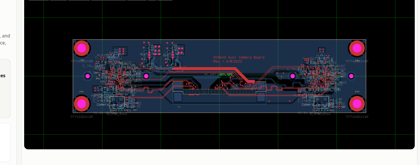

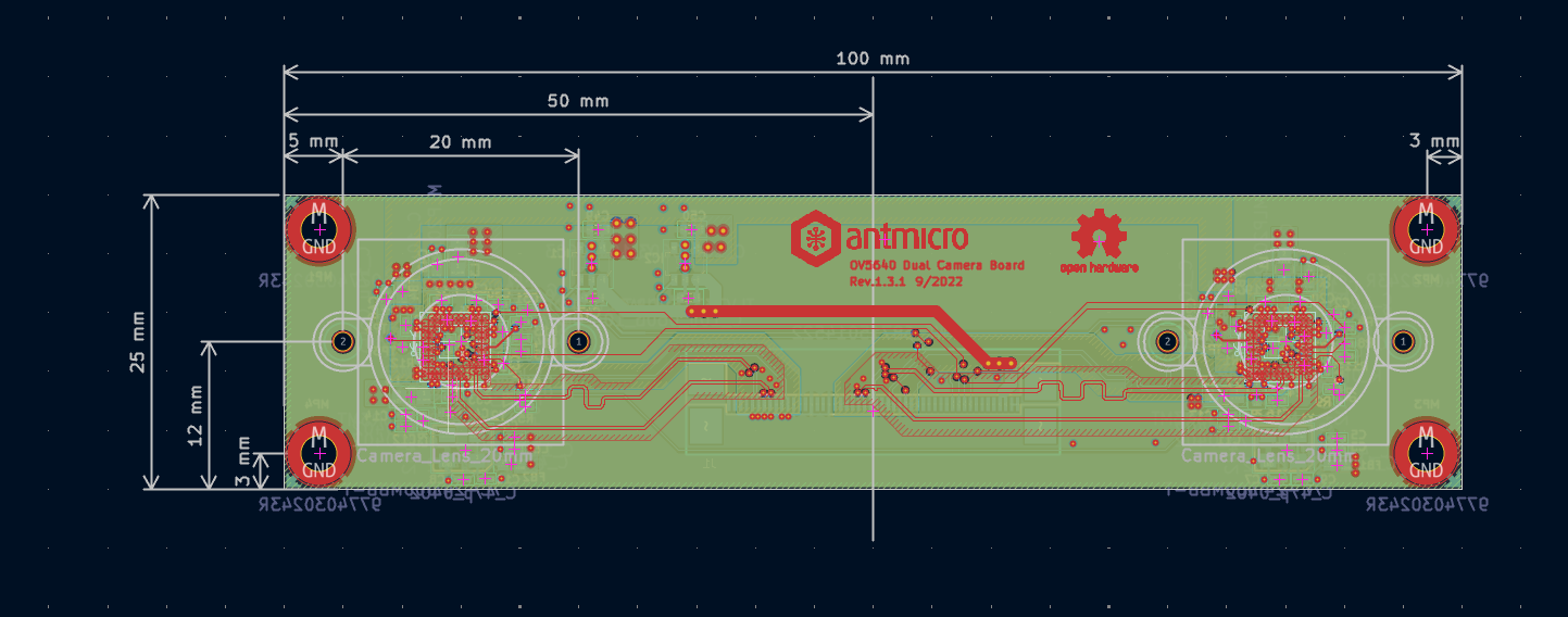

<@756504518417711104> do we need to add these pcb note line,circle, dimensions , we are missing them right now,
also copper pour layers are mismatching
