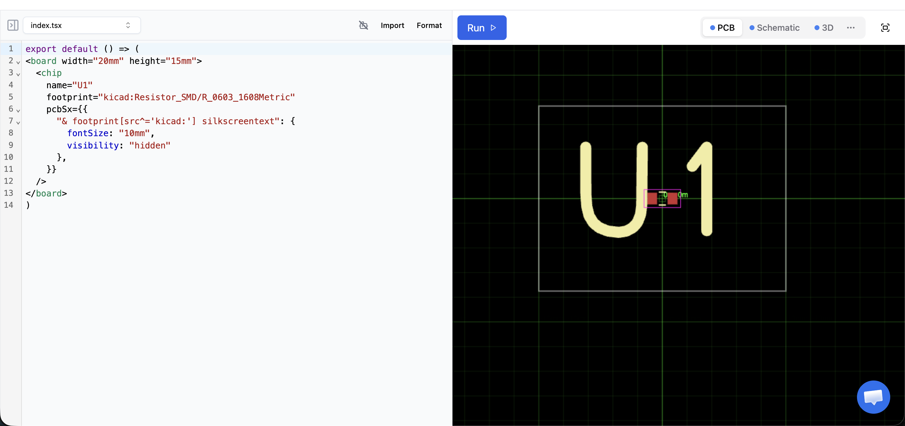

mohan-bee - ig visibility hidden not working ?

<@1238122660345548882> are you talking about the silkscreenTextVisibility?
i have add that issue in the staff sprint, i have to fix it in this week that was the user issue.
how about this ?? https://github.com/tscircuit/core/pull/2468
There are some issues in that PR that don't match the user expectations. I have opened a new PR to address them: https://github.com/tscircuit/core/pull/2469
may be you could have do a review on that .
ok
i am not sure you were fixing that issue that looks totally different
let me close mine !
do you fix that user issue? i think you were working on it https://github.com/tscircuit/tscircuit/issues/3277
or you need any help for fixing that issue?
no i already pinged here for help , i got none ! so that is completly blocked
ohh what are you blocking?
https://discord.com/channels/1233487248129921135/1265314333764878387/1509257535658393672
