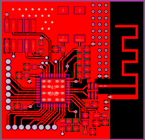

mention Does TSCircuit have RF/ Antenna support configuration? I see https://docs.tscircuit.com/elements/inductor rf circuits in the docs but I am looking for of a trace antenna like the photo. I know there's calculators and examples online but I was wondering if there was any de

<@757706909351411845> Does TSCircuit have RF/ Antenna support configuration? I see https://docs.tscircuit.com/elements/inductor#rf-circuits in the docs but I am looking for of a trace antenna like the photo. I know there's calculators and examples online but I was wondering if there was any dedicated support or documentation or examples that tscircuit might have.
Manual trace paths should enable this easily- <@398467566588264449> <@778624824875941908> <@756504518417711104> <@809856037376491570> can one of you PR a doc for this? Im unfortunately flying today
https://github.com/tscircuit/docs/pull/756 <@757706909351411845>
Our doc should be like “draw a wifi antenna” cc <@778624824875941908> <@809856037376491570>
It should be a new guide
Updated it
