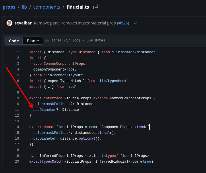

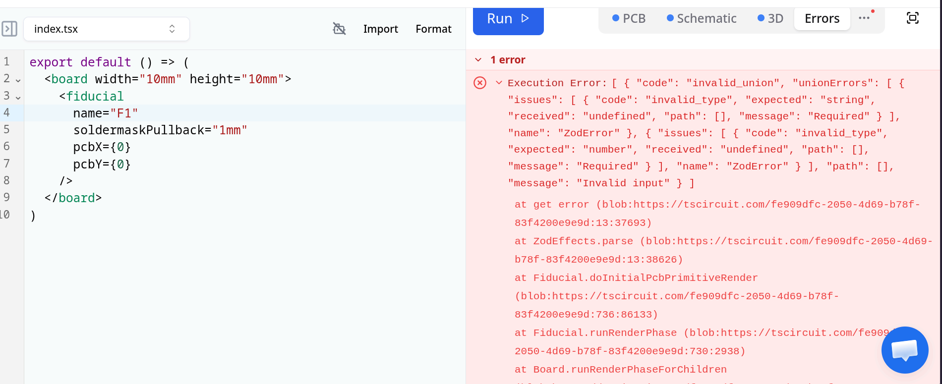

! Rushabh | Linux Shill - hey @Seve @shibo padD...
hey mention mention padDiameter is option in the props but no default is set in core so zod screams when running without a pad Diameter, should we make the padDiameter prop required in props? or add a default diameter in core? if yes, what?

hey <@757706909351411845> <@778624824875941908> padDiameter is option in the props but no default is set in core so zod screams when running without a pad Diameter, should we make the padDiameter prop required in props? or add a default diameter in core? if yes, what?

I think padDiameter shouldn’t be optional. Otherwise what are you rendering?
https://github.com/tscircuit/props/pull/696
That error sucks and should be improved
Even for this type of failure
