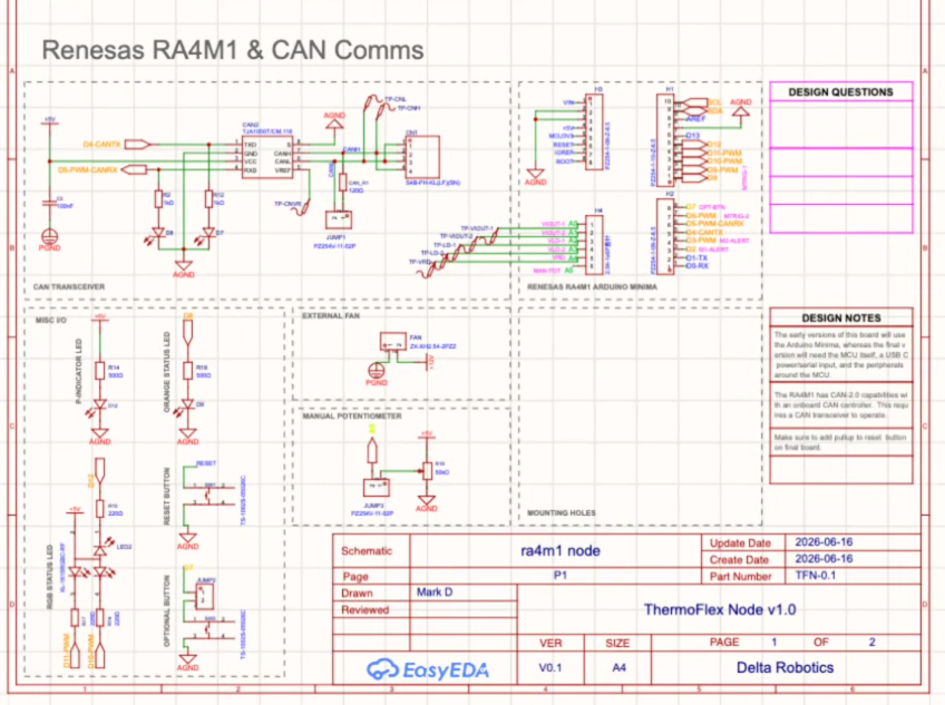

KEV0 - @Seve Does TSCircuit have schematic bloc...
mention Does TSCircuit have schematic blocks/groups? This is what I am going for.
Started by KEV0Jun 16, 20267 messages
KEV0original post
<@757706909351411845> Does TSCircuit have schematic blocks/groups? This is what I am going for.
Yes, we do have <group /> component which you can use
You can also use <schematicsection /> to create a better visualisation of each group https://docs.tscircuit.com/elements/schematicsection

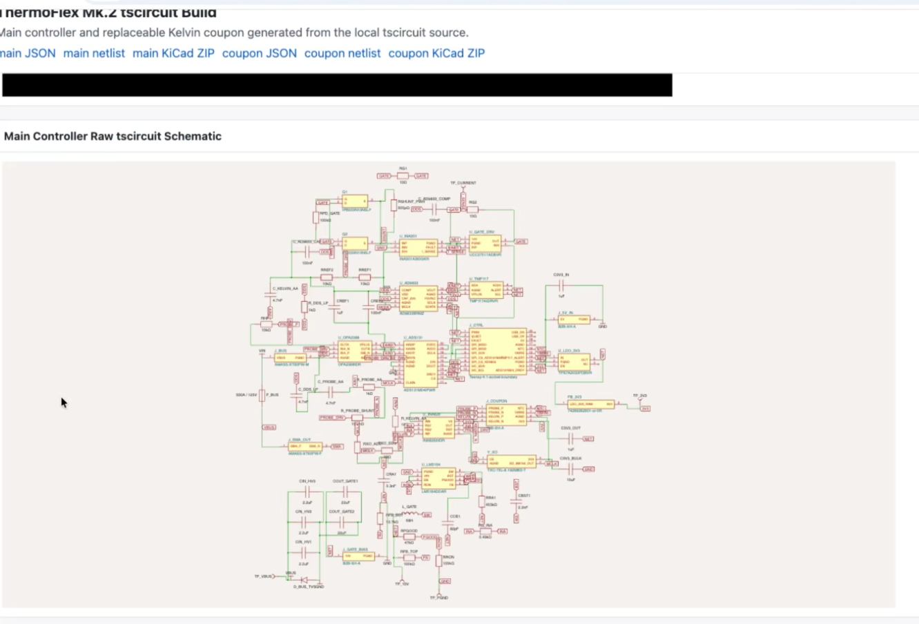

No worries
Avoid <group />! sections work much much better
