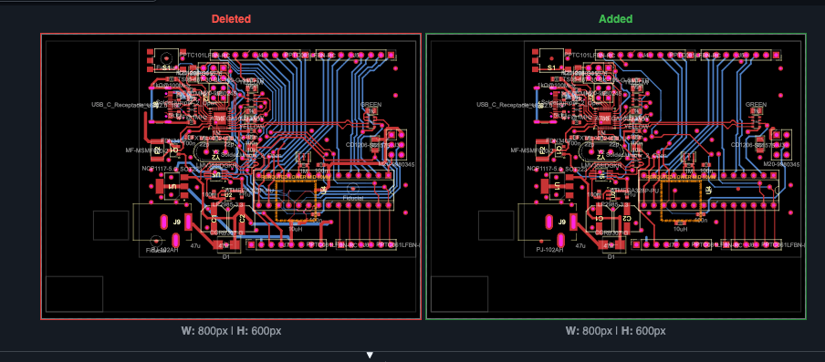

<@452450065941004289> Did you figure out what those traces are being dropped? We need to update the core with the latest deps version, cause that is blocking the `tscircuit` release pipeline
The traces were dropped because imported trace inflation assumed a 1:1 mapping between source_trace and pcb_trace, but the newer kicad-to-circuit-json output uses 1:many.
will push the change now for review
tests are failing the tests are flaky because they assert exact rendered images for large imported trace networks whose element ordering is not guaranteed to be stable across runs.
https://github.com/tscircuit/core/pull/2450
i removed the snapshot comparisons
