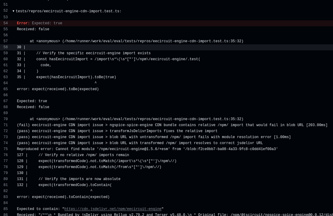

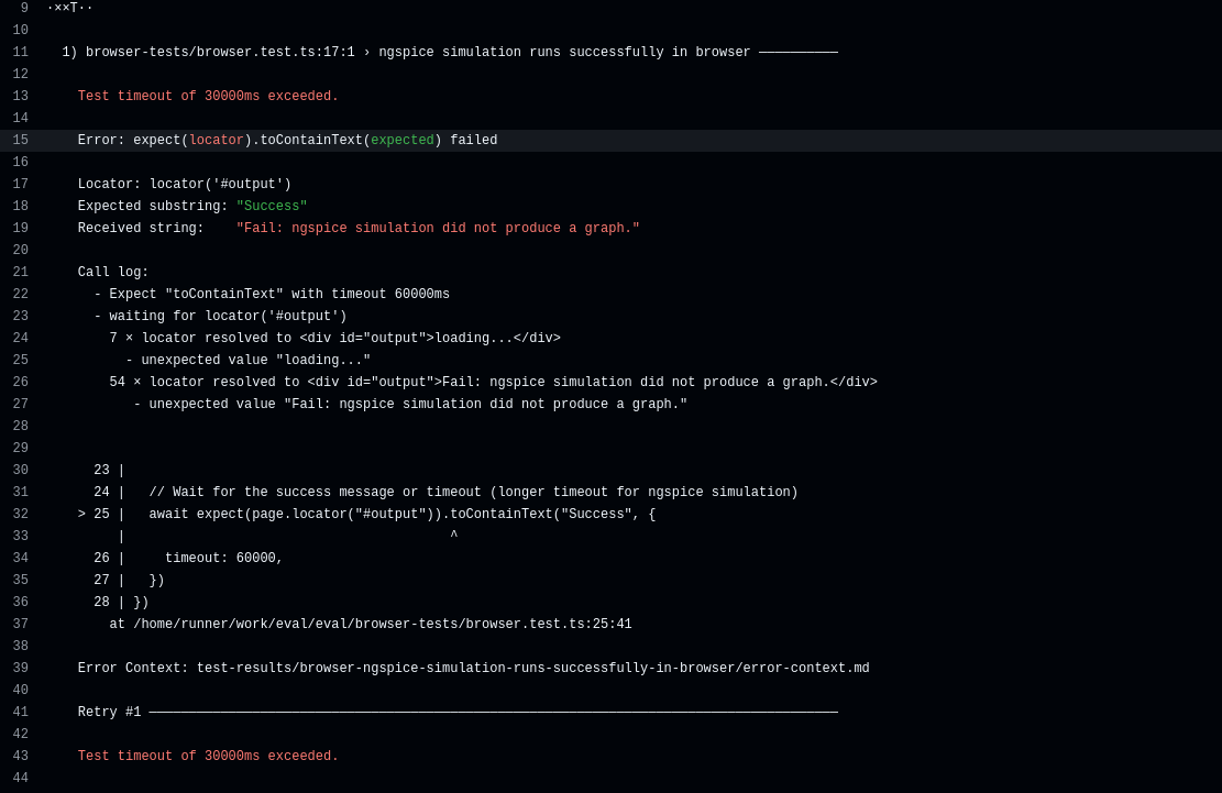

https://github.com/tscircuit/eval/actions/runs/27495310275/job/81268160693?pr=2905 https://github.com/tscircuit/eval/actions/runs/27495310285/job/81268173198?pr=2905
The issue was that browser CI was loading the latest CDN bundle of @tscircuit/ngspice-spice-engine, and that newer bundle had a broken runtime dependency. Because of that, ngspice was not producing the simulation graph, then the playwright test is failing
