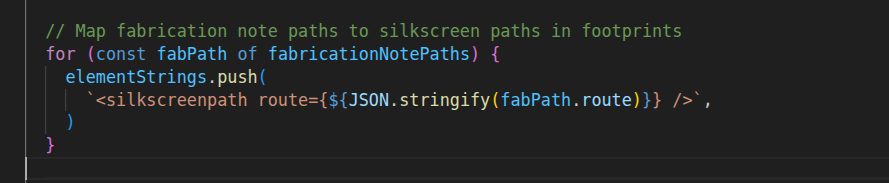

mention I’m noticing that we’re converting the fabrication layer into silkscreen and the courtyard layer into fabrication. This doesn’t seem correct to me. i think both are incorrect conversion in circuit json to tscircuit?

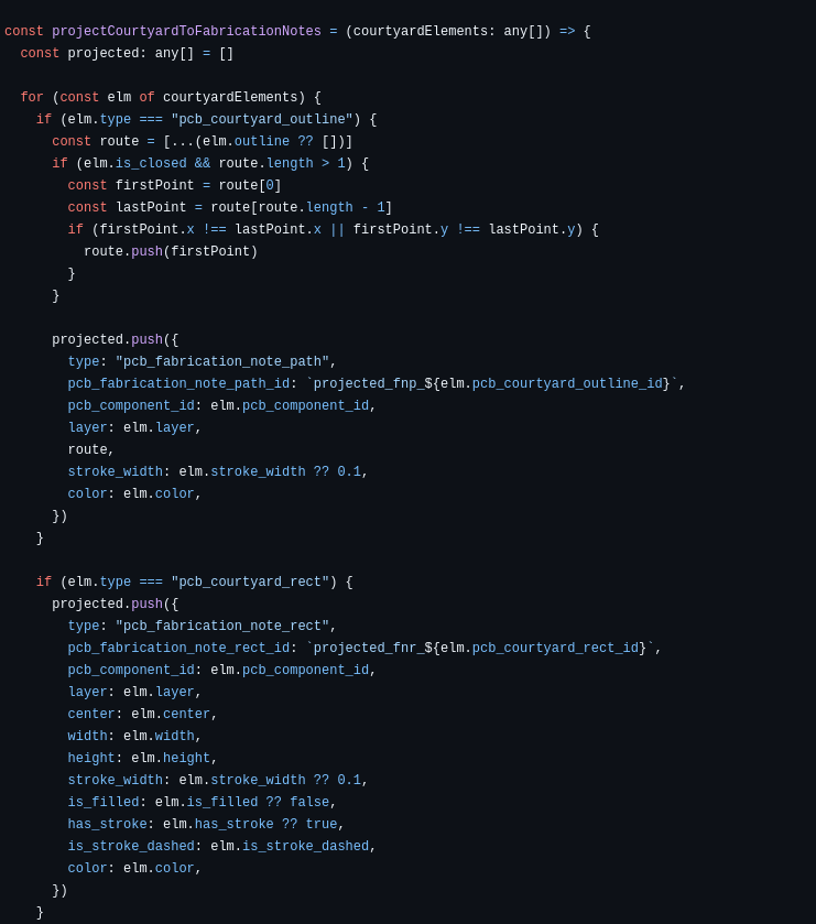

<@757706909351411845> I’m noticing that we’re converting the fabrication layer into silkscreen and the courtyard layer into fabrication. This doesn’t seem correct to me. i think both are incorrect conversion in circuit-json-to-tscircuit?
Courtyard doesnt go to fabrication it has its own layer
Yea same issue with the fabrication which also has its own layer.
can you check these pr i have fixed the layer support https://github.com/tscircuit/circuit-json-to-tscircuit/pull/28 https://github.com/tscircuit/circuit-json-to-tscircuit/pull/29 https://github.com/tscircuit/circuit-json-to-tscircuit/pull/30
