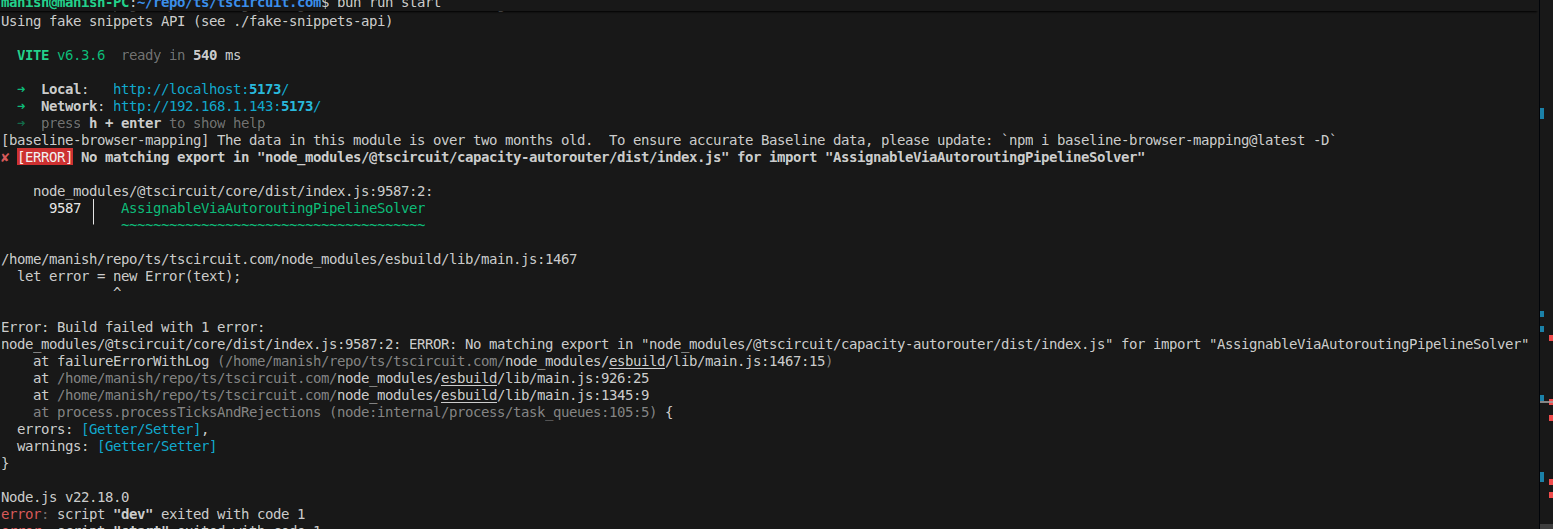

looks like bad dep verison for autorouter or something
okay, need to update in core first?
update what?
make sure the autorouter version you're using in that project matches the one already in core. Use npm ls
yep

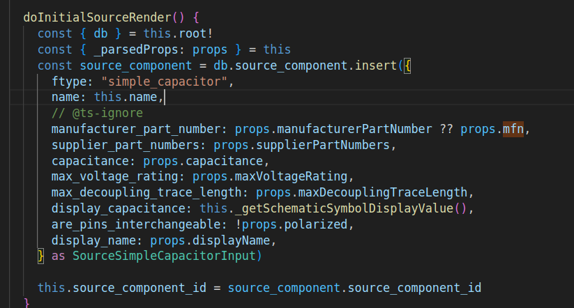

we never defined in props
manufacturer part number...
yes but it not defined in props......do we need to add it, it give type error otherwise
yea we can add it!
it is a common shorthand

is it not in commonlayoutprops?
where is manufacturerPartNumber defined
manufacturerPartNumber is using individually for all
why would we define them in separate locations. mpn/manufacturerPartNumber is not related to layout

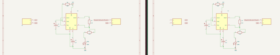

number is missing in the component’s name when I convert the circuit-json to KiCad and check the schematic view.
Yea seems like a bug
yep i try to fix it.
https://github.com/tscircuit/circuit-json-to-kicad/pull/70
I was getting this issue when I was using https://circuit-json-to-kicad.com to convert Circuit JSON to KiCad and viewing the schematic, and after fixing it, I followed the same process and got the correct output, which is what I mentioned.

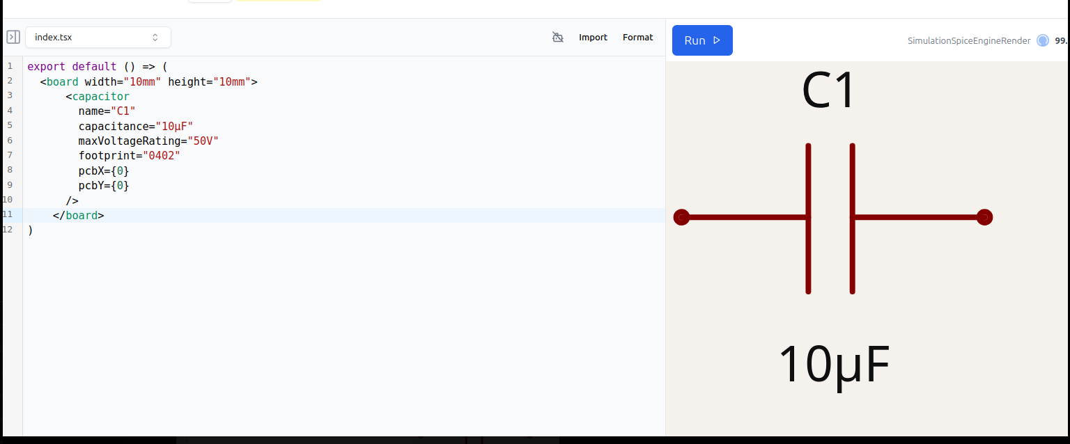

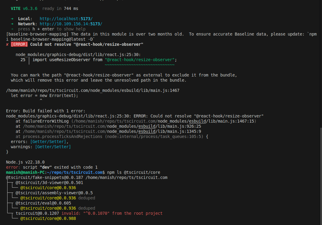

some dep issue in the tscircuit.com. Idk why it is not updating. can you tell me how can i get proper dep update in tscircuit.com
I don’t think so. We had already implemented maxVoltageRating / capacitance in the schematic view before 2 month ago i think, but it is still not showing on tscircuit.com.
I think u just have to install that dep

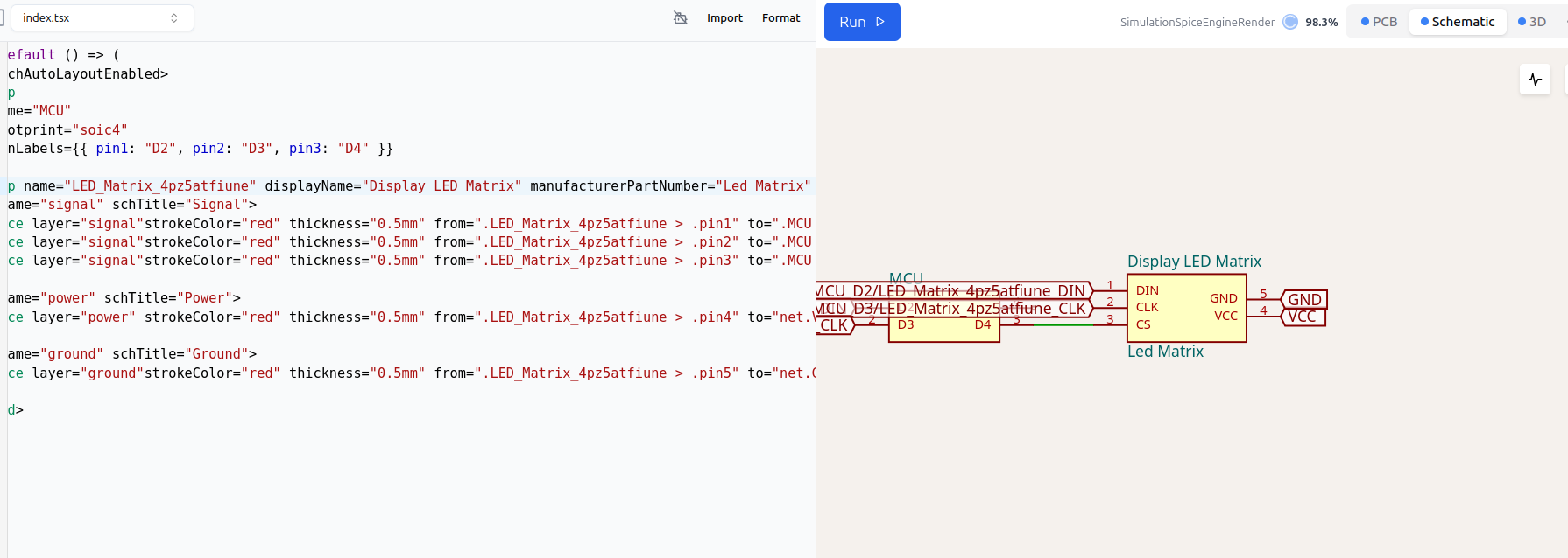

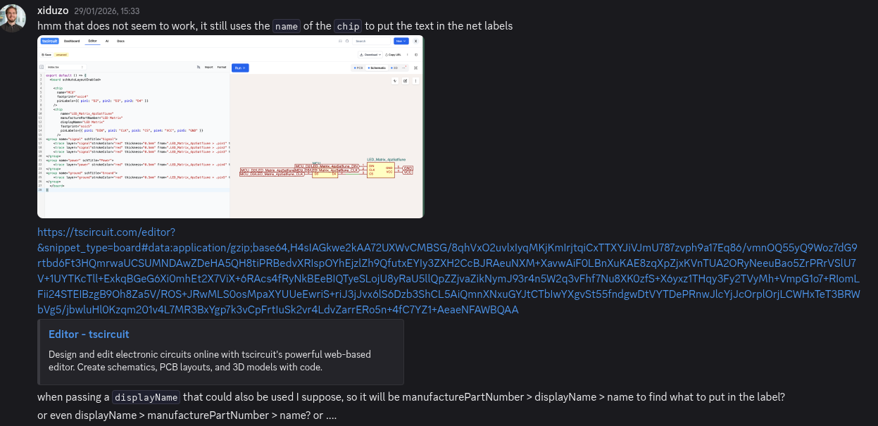

<@757706909351411845> The user wants the net label to use displayName instead of name when displayName is available. So we would need to define a clear priority, for example: manufacturerPartNumber > displayName > name, or displayName > manufacturerPartNumber > name What do you think—should we support this behavior? And if yes, which priority makes more sense?
What? Name and manufacturerPartNumber display in different locations
Not relevant
No
User want this
displayName is prefered over name, manufacturerPartNumber is put in a totally different place

displayName is shown instead of name when provided. manufacturerPartNumber is shown in a different location
that is the intended behavior
I know this "displayName is shown instead of name when provided. manufacturerPartNumber is shown in a different location". But the user desired something different. I was just asking you. do we need to support or not. The user wants the net label to use displayName instead of name when displayName is available.
Yes net labels can also have display names!

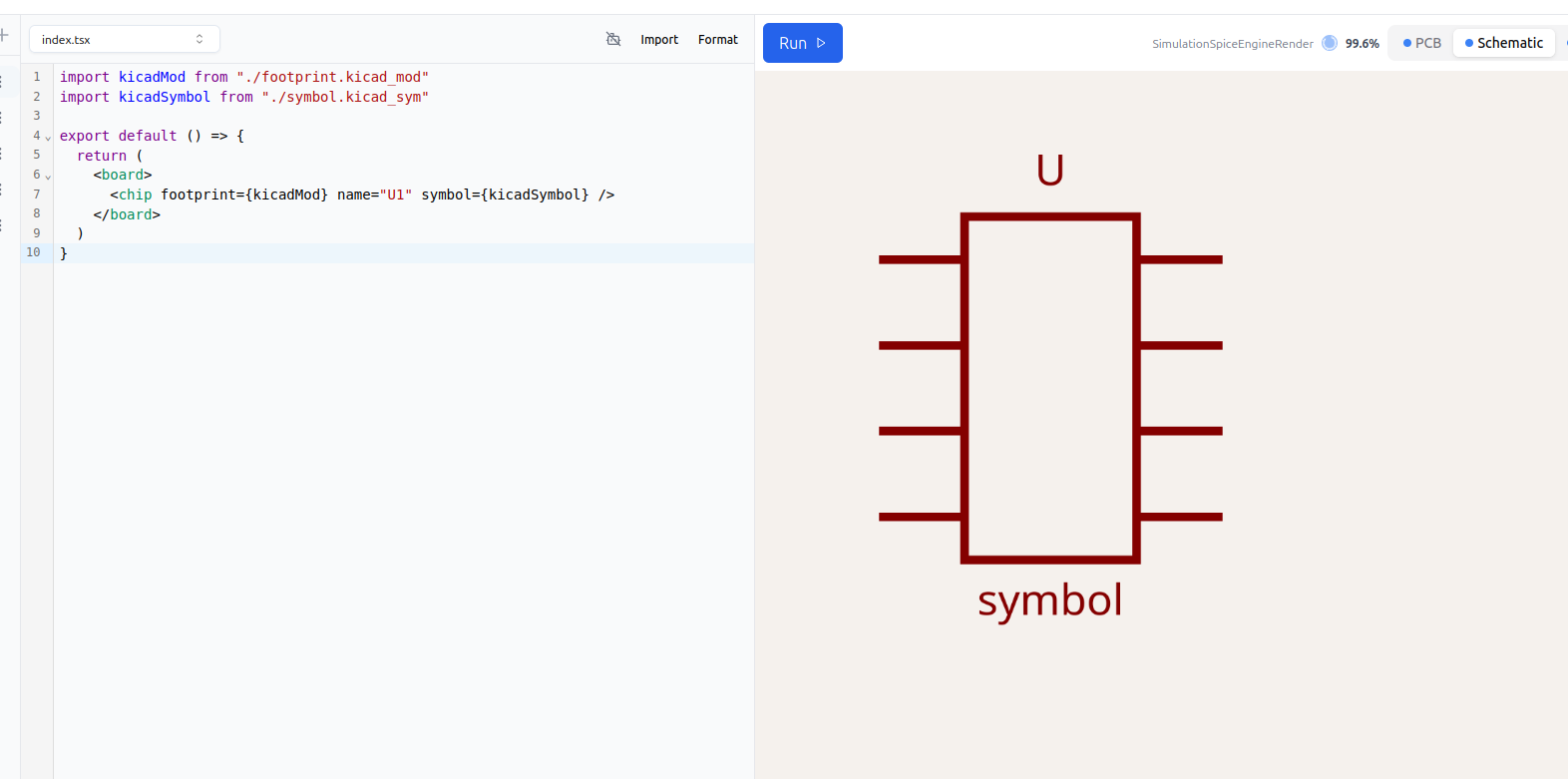

now we have direct KiCad symbol import support.
I am going to add doc now
https://github.com/tscircuit/docs/pull/795

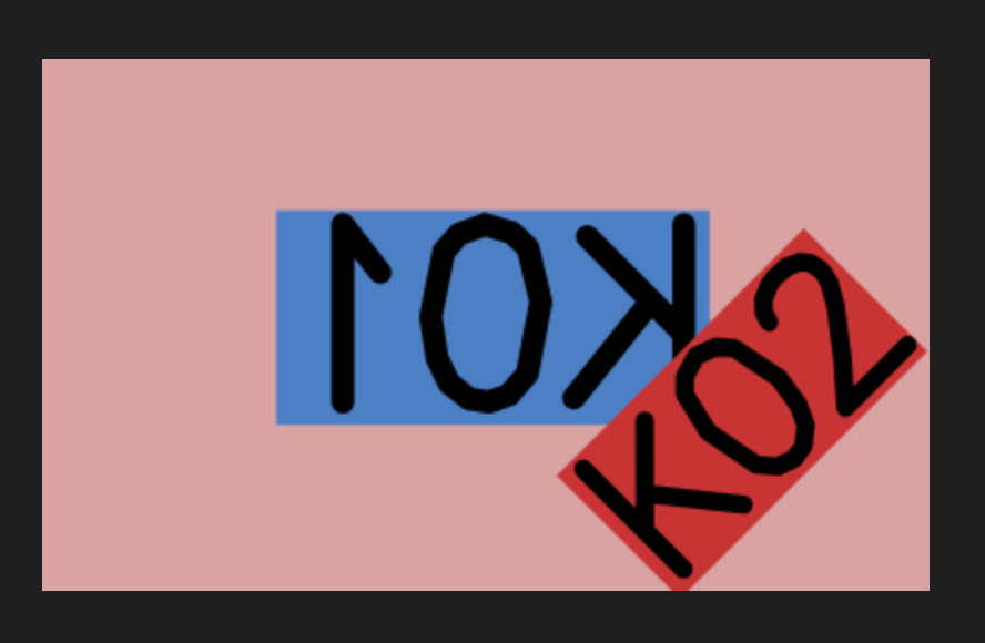

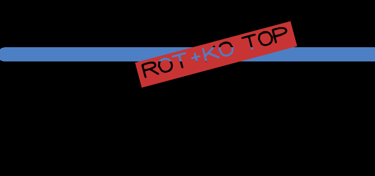

One more interesting issue in my board : U1 and C2 have no actual footprint collision—their courtyards are clear by 0.996mm, but placement analysis reports a 0.64mm intrusion. The root issue appears to be in core: for the -90° rotated U1, rectangular pad width/height aren’t rotated while calculating pcb_component bounds. I’ve added repro PRs in both core and placement-analysis. https://github.com/tscircuit/circuit-json-placement-analysis/pull/17 https://github.com/tscircuit/core/pull/3179
<@757706909351411845> https://github.com/tscircuit/core/pull/3179
<@757706909351411845> also check that repro related to footprint collision issue. In the repro wrong bound calculation for rotated chip
