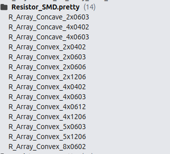

mention there are some concave and some convex. can we use them with flags convex or concave?
Started by techmannihJan 9, 202631 messages
Last active 8 months ago · plain text
techmannihoriginal post
<@757706909351411845> there are some concave and some convex. can we use them with flags convex or concave?
yes we should add those flags
is there any default use like 0402x2 which is for default convex or concave
probably convex is the default

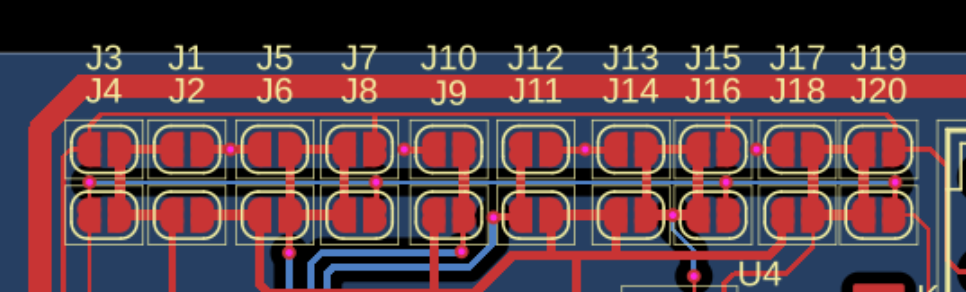

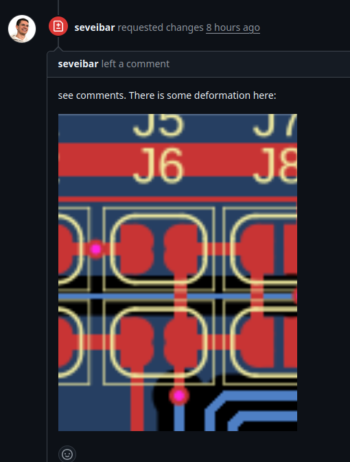

Sorry I am founding lot of unwanted thing in 3d-viewer when i try to refactor with circuit-to-canvas.
Hmm it seems like just a bug with the conversion not related to clockwise/ccw
Because if we’re converting custom symbols it should just adopt whatever we say
yes for custom symbols, the conversion should follow exactly what we define

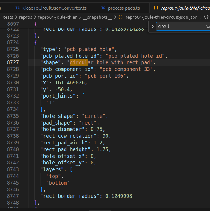

<@757706909351411845> yep, there is the rotation issue, we doest support the rotation to the polygon smtpad. do we need to add support rotation. ???
i don't know what we need to do exactly, but polygons are never represented with rotations in circuit json
it's not tricky
https://github.com/tscircuit/kicad-to-circuit-json/pull/36
Removing incorrect logic handling that was affecting the pill-shaped plated hole. https://github.com/tscircuit/kicad-to-circuit-json/pull/38
Yes, I have added rotation support for circular holes and rectangular pads. It is also being generated in the circuit JSON, but I still need to figure out what the issue is in this case and why it is not working. I am also looking on it.

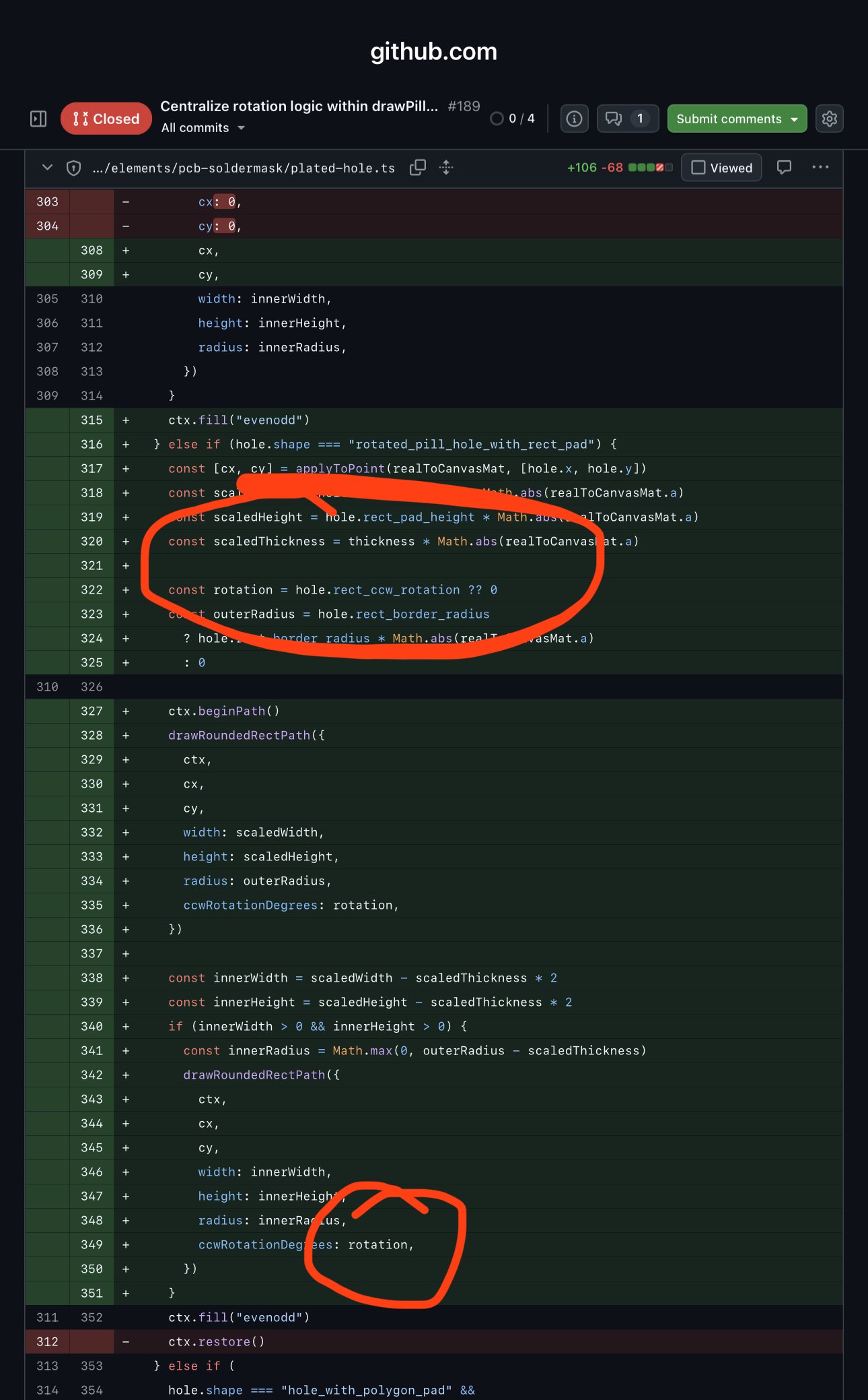

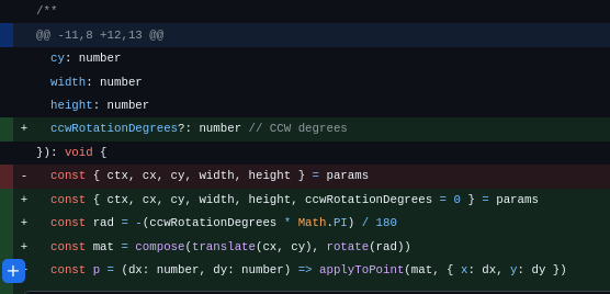

I’ve fully switched to using the transformation matrix for the plated hole. All ctx.translate, ctx.save, ctx.restore, and ctx.rotate calls have been removed. I’ll address the rotation handling separately later on. Could you please review? https://github.com/tscircuit/circuit-to-canvas/pull/189

you have single letter functions and variables like `mat`
you also used the word `rotation` for a fourth time
these are matrix and radian, yeah i change them.
No, it was using ccwRotationDegrees.
oh variable name, it was param
Can you reopen it? I’ve applied the changes.
