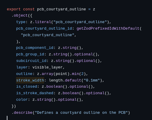

stroke_width shouldn't exist on pcb_courtyard_outline
neither should is_stroke_dashed or is_closed
or color
yep
i am removing them
https://github.com/tscircuit/circuit-json/pull/456

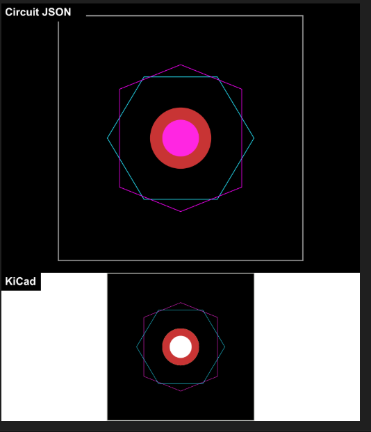

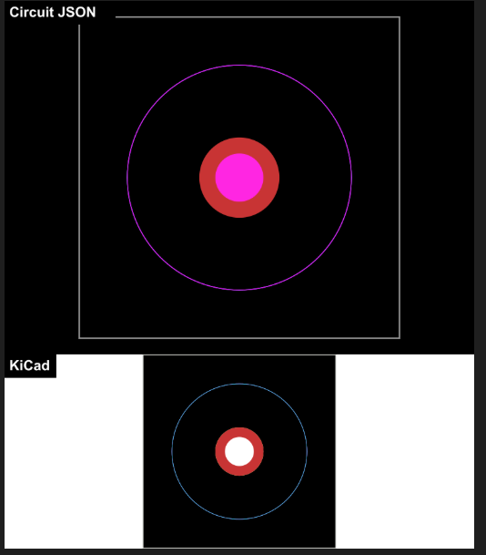

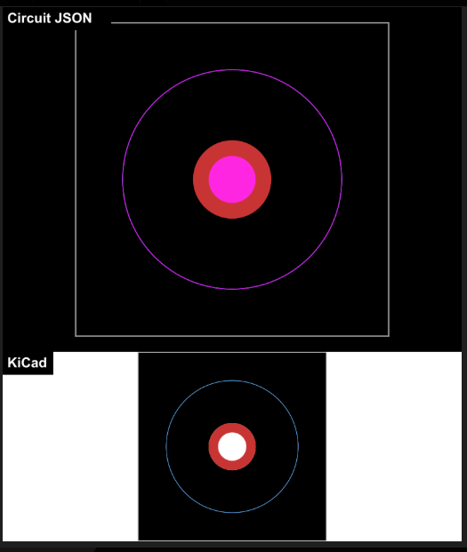

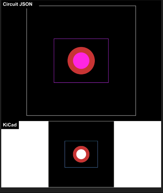

i don't know what you mean because none of these images are labeled
in the snapshots of KiCad and circuit-json. In circuit-json, we are using the top courtyard, but in KiCad the bottom courtyard color is being rendered.

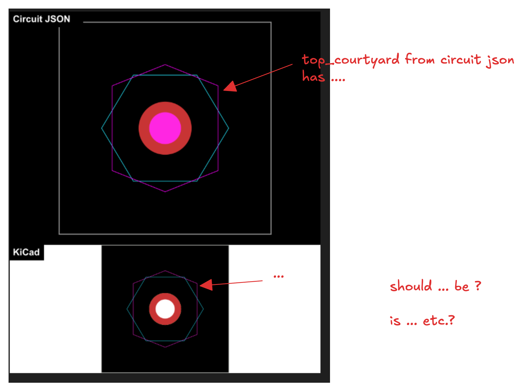

<@1067854999889137715> open excalidraw and annotate the images like so:
i still don't understand, but if you think it's a real bug you can go directly to PR of course- but it is important to communicate concretely
yes there is one more issue in the kicad bottom courtyard is top of top layer courtyard
yes and in this snapshot looks like we are using the top courtyard, but in KiCad the bottom courtyard color is being rendered
<@1067854999889137715> i literally don't know what you're saying- we had this discussion already- i do not know what you're talking about because i do not have the full context of what you have done or seen. _ANNOTATE THE SCREENSHOTS_
you're saying that blue, in kicad, represents bottom courtyard? So then our top courtyard becomes a bottom courtyard? Yes that seems like a bug
Yes — I’m saying that
I’ve figured it out now — this isn’t the original issue we thought it was. The actual problem is a layer ordering issue: the bottom courtyard is being rendered above the top courtyard. Because of this, it appears like a courtyard mismatch, but it’s not a color or mapping issue.

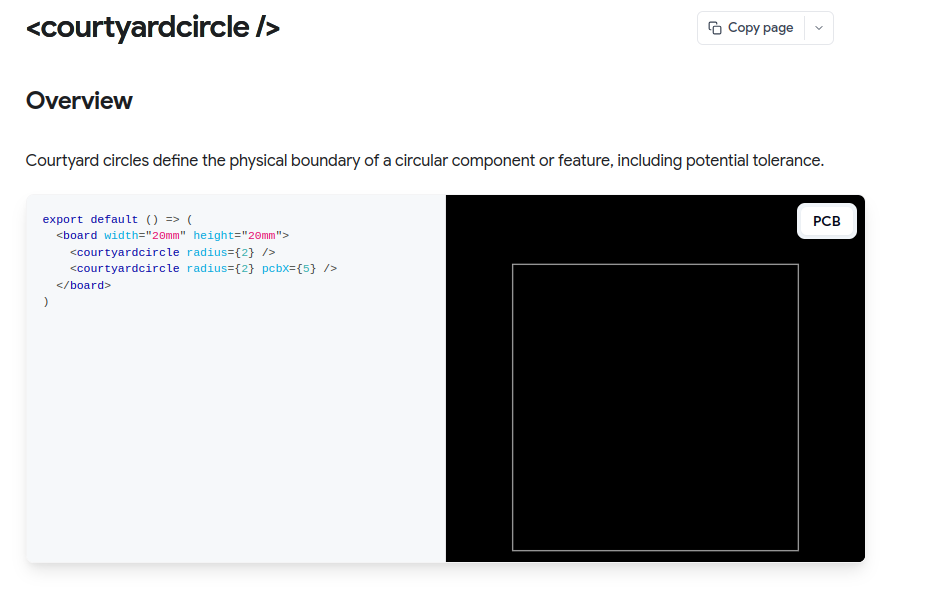

<@757706909351411845> The courtyard is not working in the docs. Is there any dependency issue? I added support for it everywhere almost 4 days ago. https://github.com/tscircuit/docs/pull/436
Write a test in the svg.tscircuit.com rrpo
https://github.com/tscircuit/svg.tscircuit.com/pull/978
this should be easy to fix now
Can you check it now I have updated https://github.com/tscircuit/docs/pull/764

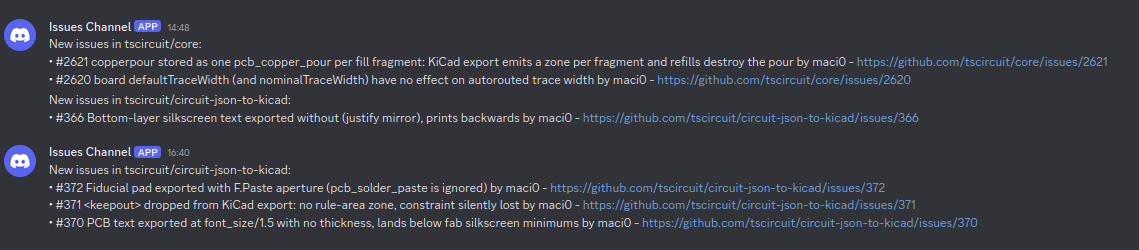

<@757706909351411845> A user created some issue. do we need to take action on them
Idk evaluate if theyre valid
We should always examine user reported issues if theyre not slop, that guy is legit
exactly yea, I checked his profile. he seems like a good open-source contributor
can you check it https://github.com/tscircuit/circuit-json-to-kicad/pull/373 https://github.com/tscircuit/core/pull/2625
updated, can you check now
These both are the user issue. I add the reference of issue
Can you check it https://github.com/tscircuit/core/pull/2631 https://github.com/tscircuit/circuit-json-to-kicad/pull/375
Can you check it now https://github.com/tscircuit/core/pull/2631
Updated

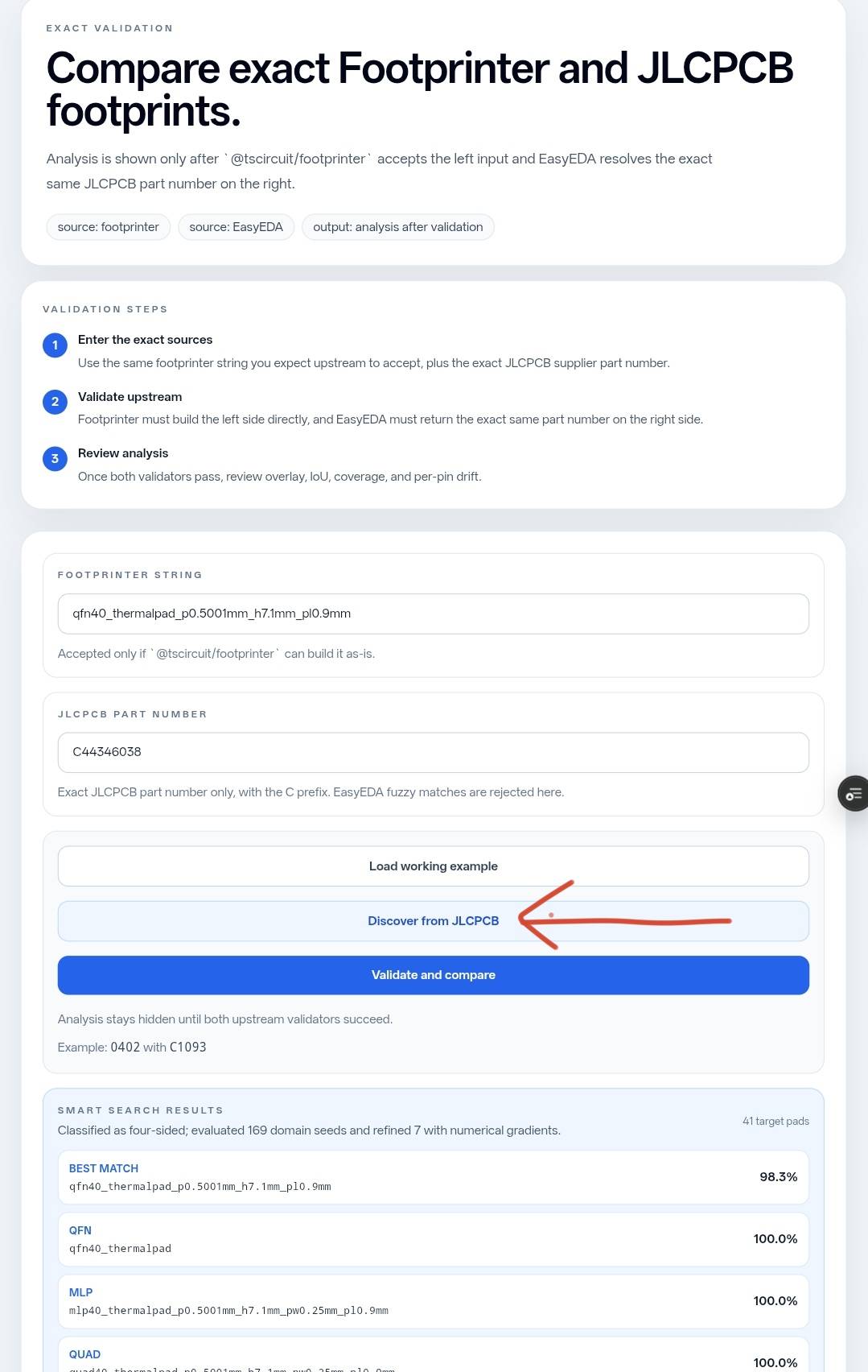

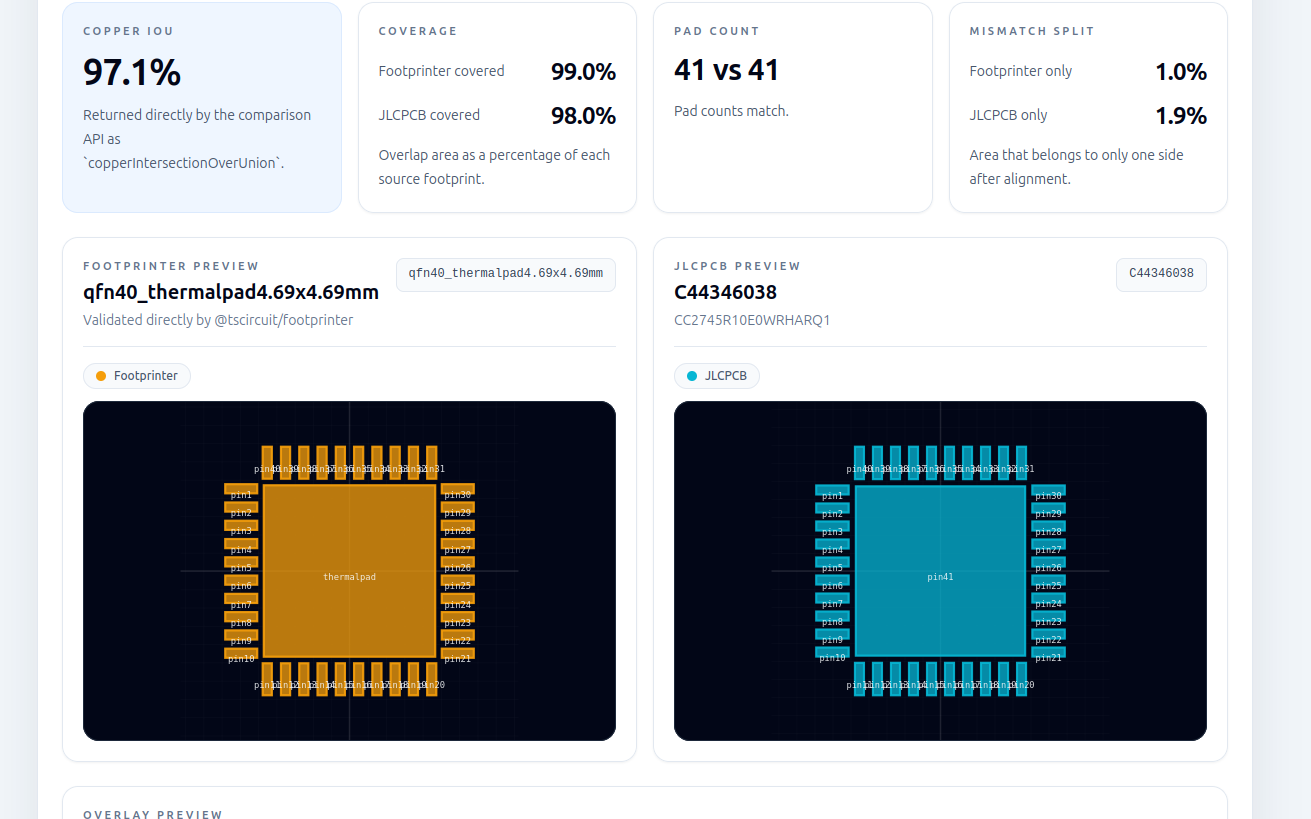

<@1067854999889137715> unrelated but we discussed figuring out footprinter strings from jlcpcb imports- we still need that- the codebase has massive footprints
yea we can use as footprint string footprint="jlcpcb:C44346038"
<@1067854999889137715> that's not what i mean. We're supposed to automatically derive a footprinter string from jlcpcb footprints via IoU matching
yea we have so many different ways to do the same thing that I completely forgot about this one.
there's still some work left on this. we still need to automatically load it using AI so it can suggest the closest matching footprinter string from JLCPCB. I'll take a look into that as well.
Sorry Sorry we keep getting high priority work, especially TI-related tasks schematic and important fixes, so sometimes things get pushed back
BTW we can use qfn40,
https://github.com/tscircuit/fast-footprint-compare/pull/3
Boom 💥
Then name should be discover from footprinter. I think?
? Wdym
It should be discover from footprinter?
Why would we want that, what would that do?
I think discovering the footprint string from footprinter which should closely match with jlcpcb part no
Why would anyone want that
Please put yourself into the mindset of a user
Or youre communicating extremely poorly
